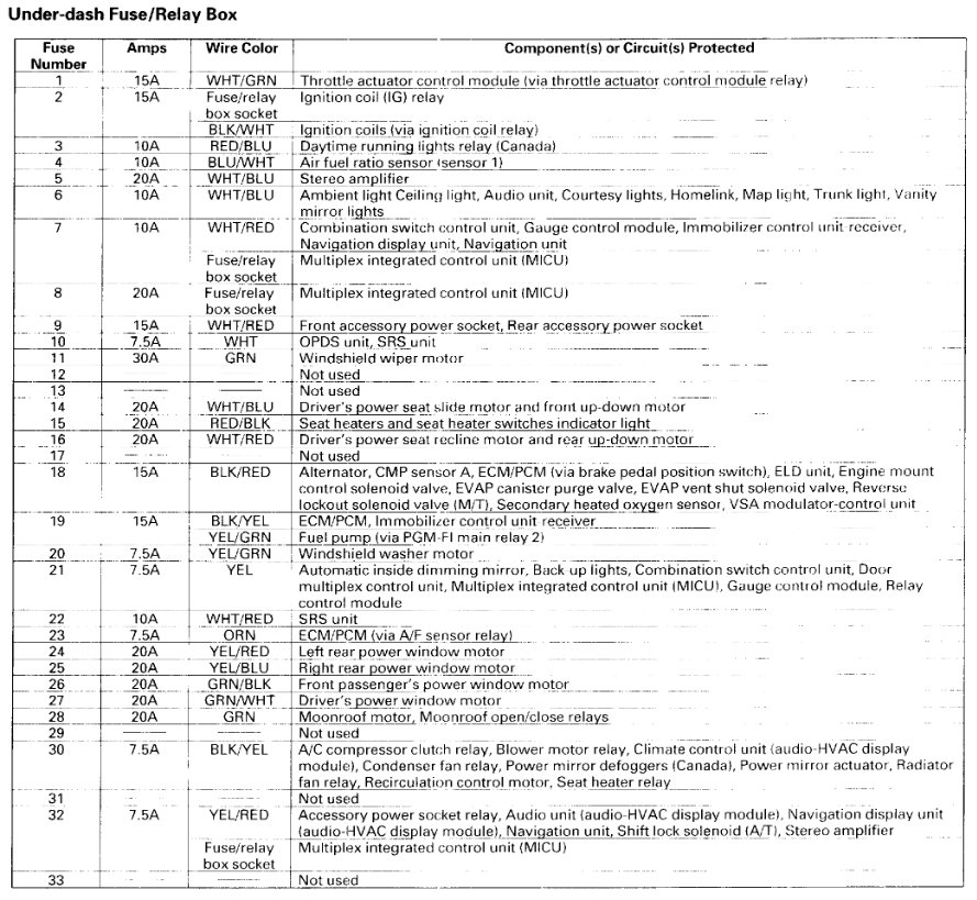

I have a power lock problem when only using the key fobs. I changed the batteries in both my key fobs and I am still not getting good reactions corresponding with the key fobs. All locks work fine while operating system from the driver door panel switches. Since both key fobs do not want to work precisely what they are supposed to do, even after I changed the batteries in both of them. Is there a brain box that works with the system which is usually the suspect of the problem? How does the key-less entry system work on this factory equipped system?
Nov 10, 2018 at 11:08 AM
  • 54,144 POSTS

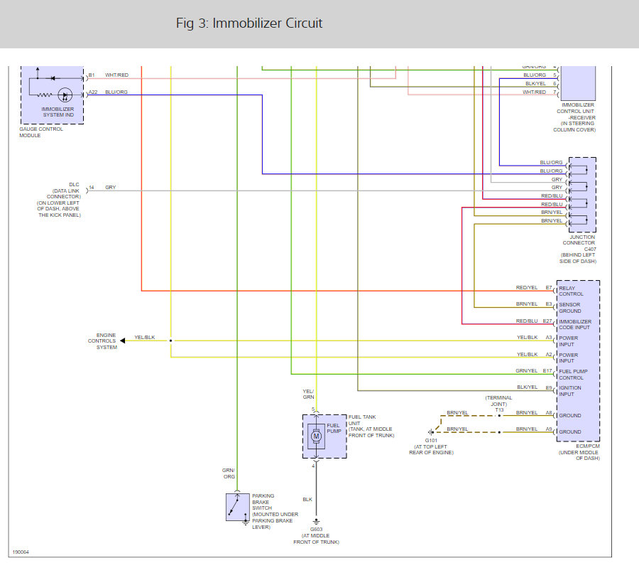

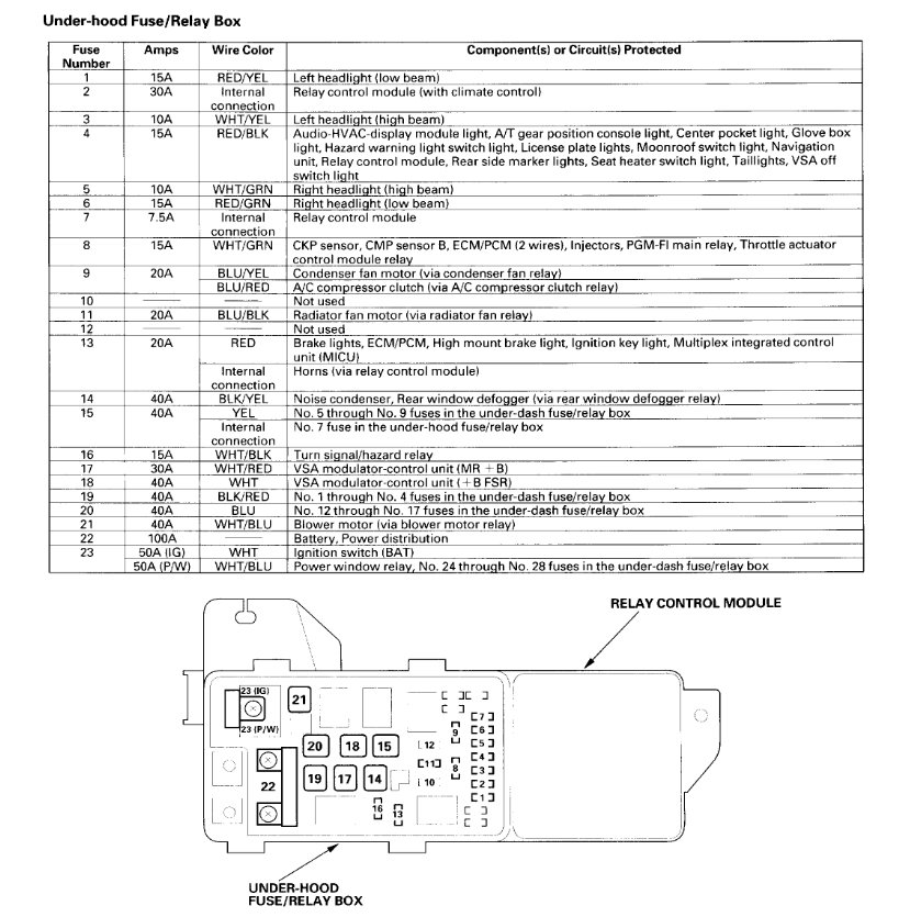

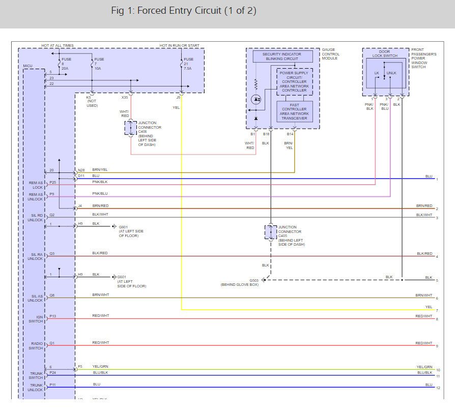

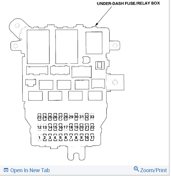

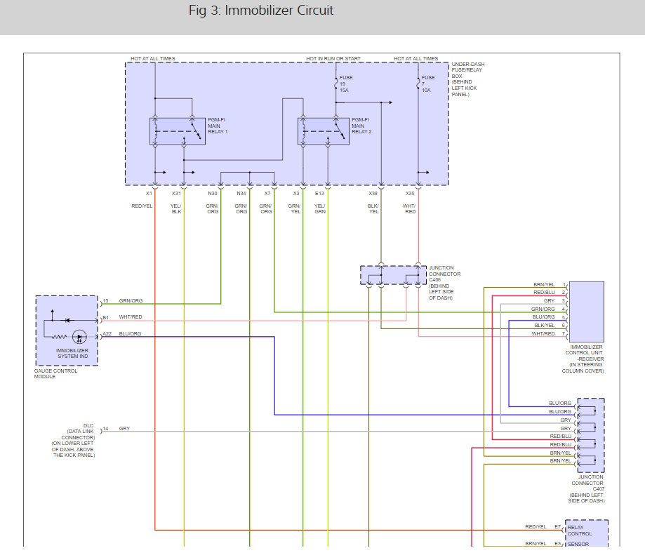

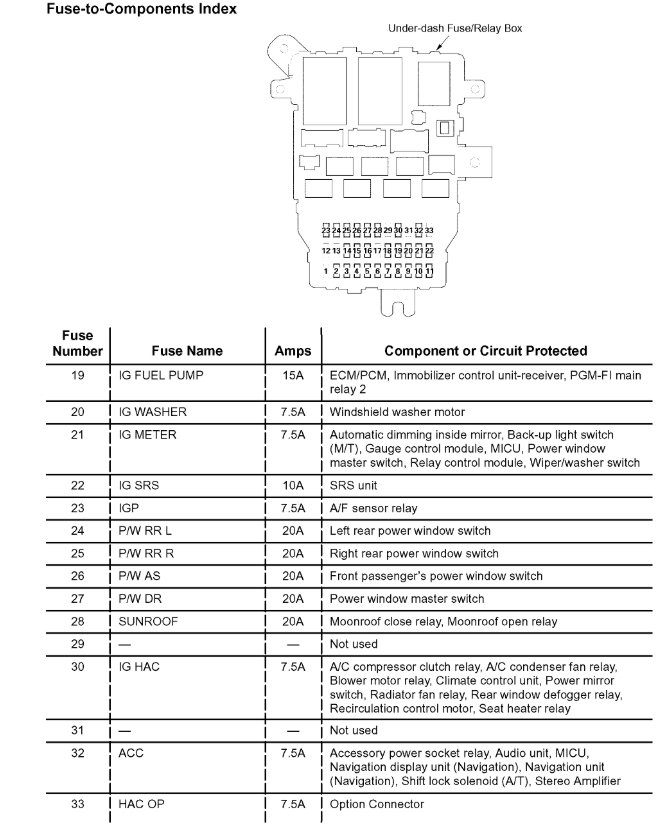

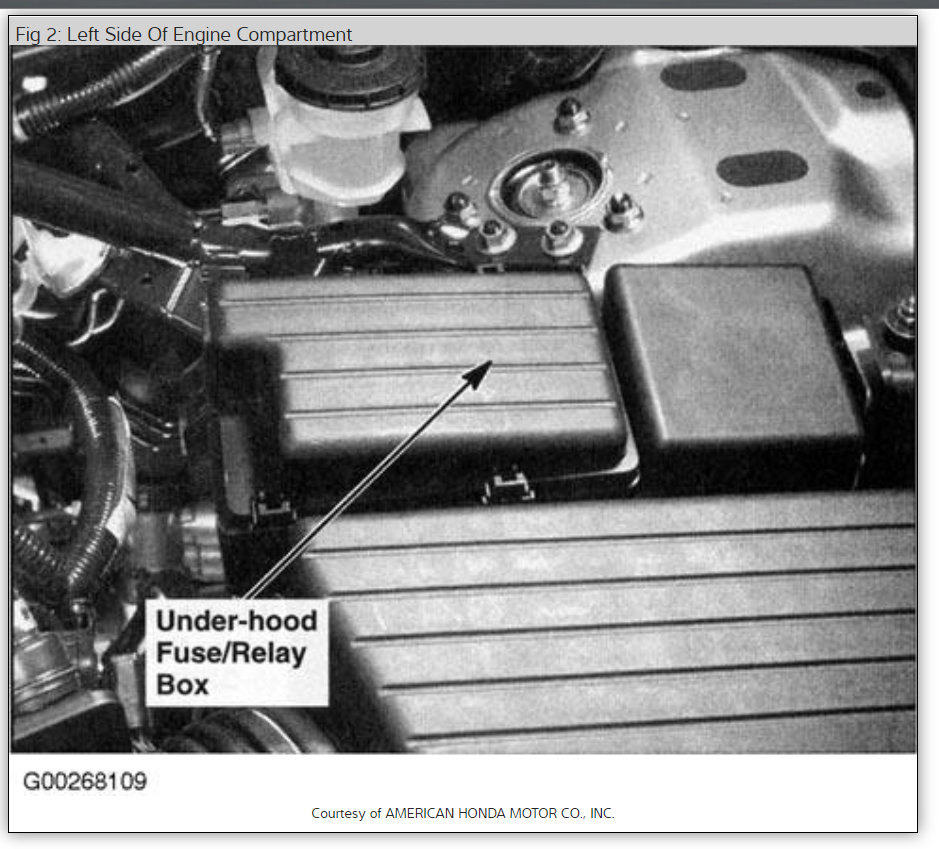

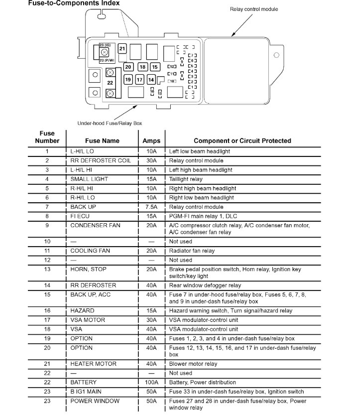

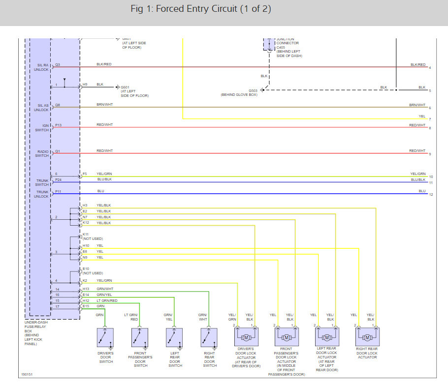

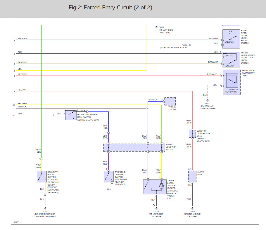

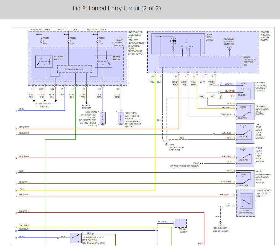

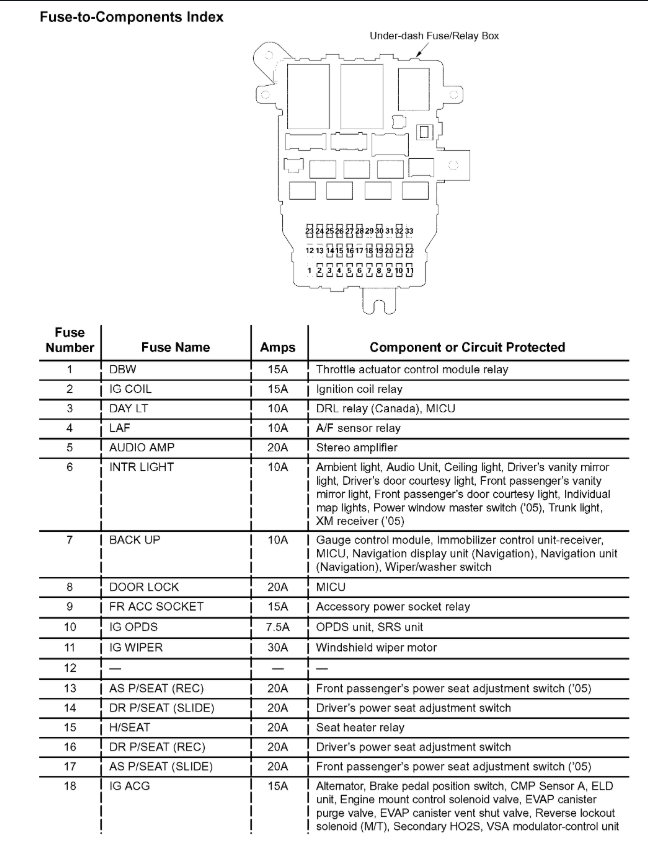

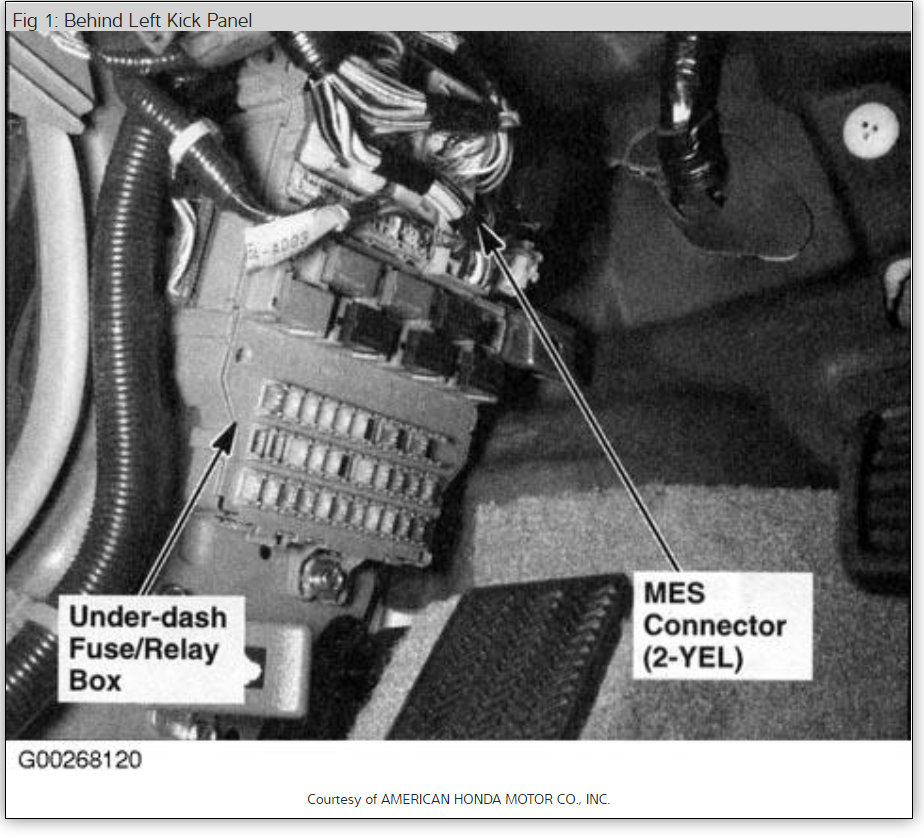

It sounds like a fuse is out. Here are the alarm wiring diagrams so you can see how the system works and a guide to help you check the fuses along with the fuse locations:
You can see the fuses that need to be checked by the wiring diagrams.

Thanks for your help, but I changed the door lock actuator.
Dec 23, 2018 at 8:44 PM
SZALKUSKT
  • 274 POSTS
Everything works now.
Dec 23, 2018 at 8:45 PM
  • 54,144 POSTS
Dec 24, 2018 at 11:36 AM
SZALKUSKT
  • 274 POSTS
I changed the door actuator with an OEM one because someone bypassed it with a universal one and cut the cable to the door lock. Had to buy a new cable to the button from dealer and actuator was off eBay.
Dec 24, 2018 at 11:53 AM
SZALKUSKT
  • 274 POSTS
All back to original parts and functionality. They chopped it up because too lazy to buy a new original OEM lock actuator.
