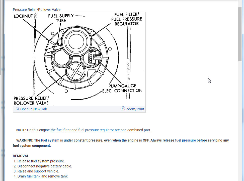

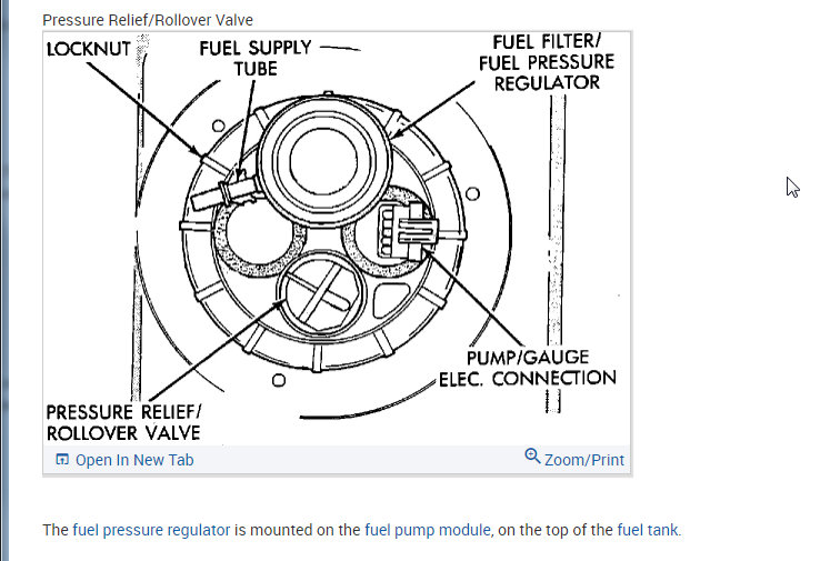

Where fuel pressure regulator located?
Apr 11, 2021 at 8:14 AM
  • CAR REPAIR CONTRIBUTOR

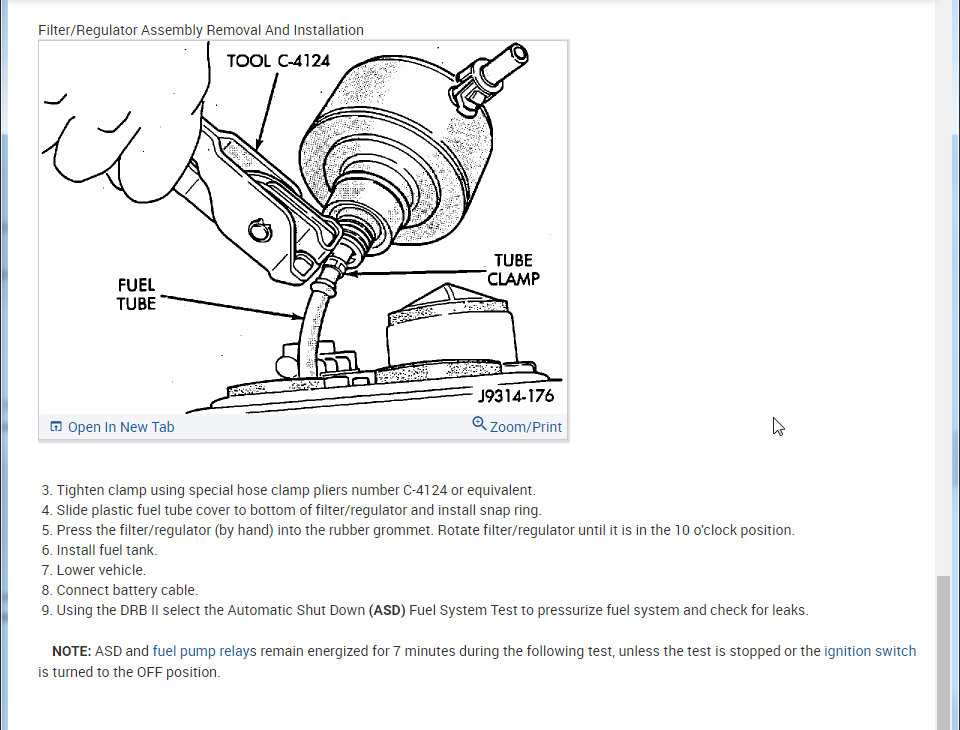

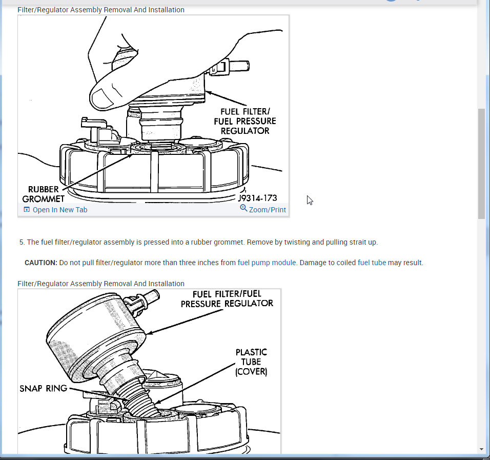

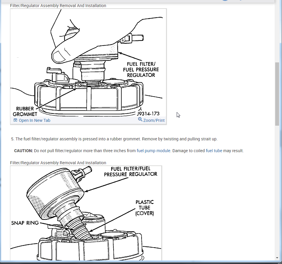

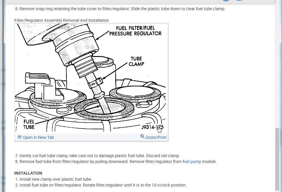

I am attaching the info below. this is the location and the process on how to replace it. Check out the diagrams (Below). Let us know what happens and please upload pictures or videos of the problem.Please let us know if you have other questions. Thanks
