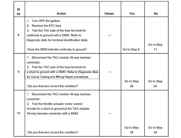

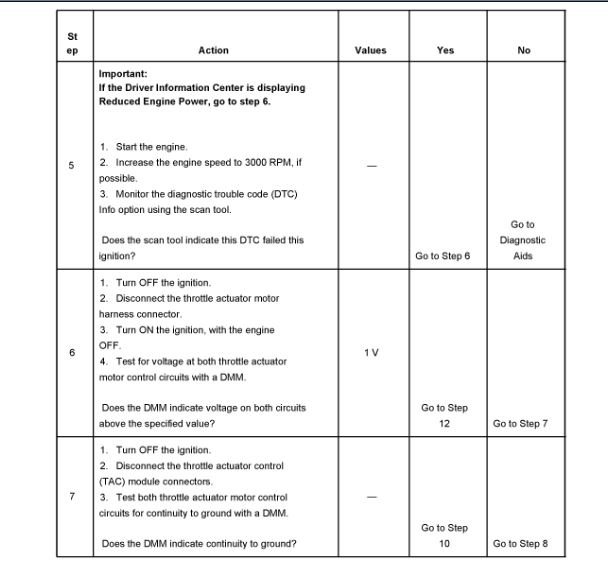

Already replaced throttle pedal assembly, throttle body assembly gasket and plug. Still goes reduced engine power under load, climbing a steep hill etc. any ideas? Thanks
Mar 30, 2019 at 10:35 AM
Good evening,

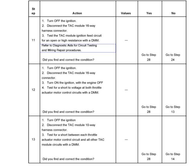

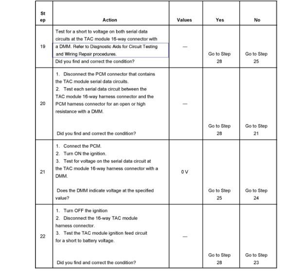

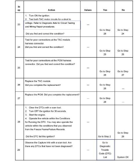

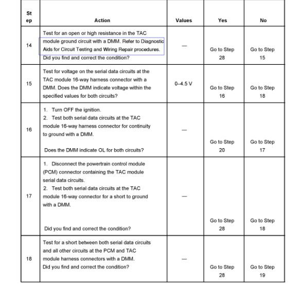

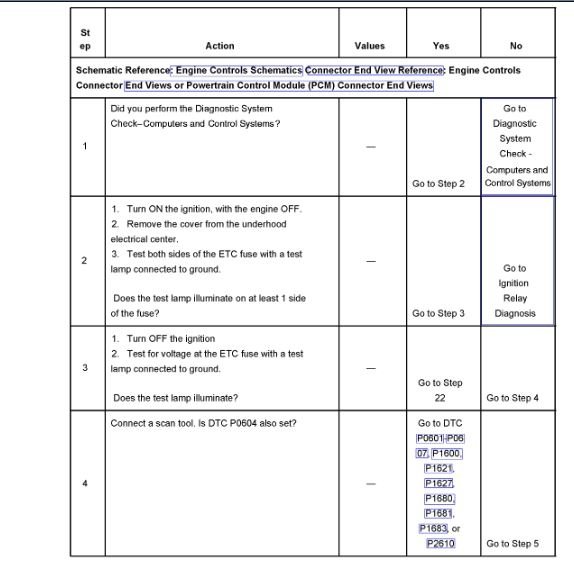

I posted below the description of the code with possible issues. You replaced all the parts in the system but this code is usually related to wiring issues.

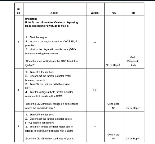

Below is the flow chart for the issue which should have been done prior to replacing any parts.
CIRCUIT DESCRIPTION
The throttle actuator control (TAC) module and the powertrain control module (PCM) communicate via a dedicated serial data circuit. This serial data circuit is separate from any other serial data circuit on the vehicle. Accurate transmitting and receiving of serial data requires not only good circuit integrity but also adequate system voltage. This diagnostic test monitors the accuracy of the serial data transmitted between the TAC module and the PCM. If the PCM detects a loss of data or invalid data, this DTC sets.
CONDITIONS FOR RUNNING THE DTC
- The ignition switch is in the crank or run position.
- The ignition voltage is more than 5.23 volts.
CONDITIONS FOR SETTING THE DTC
- Invalid or missing serial data messages are detected for a predetermined amount of time.
- The above condition is met for more than 1 second.
ACTION TAKEN WHEN THE DTC SETS
- The control module illuminates the malfunction indicator lamp (MIL) when the diagnostic runs and fails.
- The control module records the operating conditions at the time the diagnostic fails. The control module stores this information in the Freeze Frame and/or the Failure Records.
- The control module commands the TAC system to operate in the Reduced Engine Power mode.
OR
- Under certain conditions the control module commands the engine OFF.
- The message center displays Reduced Engine Power.
CONDITIONS FOR CLEARING THE MIL/DTC
- The control module turns OFF the malfunction indicator lamp (MIL) after 3 consecutive ignition cycles that the diagnostic runs and does not fail.
- A current DTC, Last Test Failed, clears when the diagnostic runs and passes.
- A history DTC clears after 40 consecutive warm-up cycles, if no failures are reported by this or any other emission related diagnostic.
- Clear the MIL and the DTC with a scan tool.
DIAGNOSTIC AIDS
- DTC P1518 sets if the battery voltage is low. If the customer's concern is slow cranking or no crank because battery voltage is low, ignore DTC P1518. Clear any DTCs from memory that may have set from the low battery voltage condition.
- DTC P1518 sets when there is a short to B+ on the TAC module ground circuit. Inspect the fuses for the circuits that are in the TAC module harness-i.e. cruise, brake. An inspection of the fuses may lead you to the circuit that is shorted to the TAC module ground circuit.
- DTC P1518 sets if the TAC module ignition feed circuit is shorted to a B+ supply circuit. The TAC module stays powered-up when the ignition switch is turned OFF. When the ignition switch is turned ON, the TAC module is powered-up before the PCM. DTC P1518 sets because no communication is detected by the TAC module from the PCM. Inspect related circuits for being shorted to a B+ supply circuit.
- Inspect the TAC module power and ground circuits and the TAC module/PCM serial data circuits for intermittent connections.
- Inspect the TAC module connectors for signs of water intrusion. If water intrusion occurs, multiple DTCs may set without any circuit or component conditions found during diagnostic testing.
- When the TAC module detects a problem within the TAC system, more than 1 TAC system related DTC may set. This is due to the many redundant tests run continuously on this system. Locating and repairing an individual condition may correct more than 1 DTC. Remember this if you review the stored information in Capture Info.
- For an intermittent condition, refer to Intermittent Conditions. See: Computers and Control Systems > Initial Inspection and Diagnostic Overview > Intermittent Conditions
