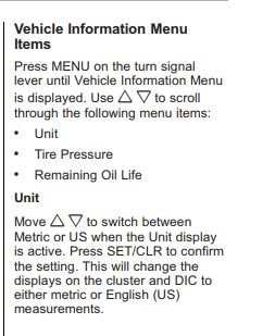

There should be a way to switch the central drivers info center on the dash to km-h.
Yep, it says you can select the Menu on the turn signal lever. Then use the up and down arrows until you find Unit. Then select Metric or US.
Monday, September 17th, 2018 AT 8:03 PM
JOJO222
  • 10 POSTS
The digital display in the center is km, it is the dial that has the needle that is in miles. Since that warning is displayed in that digital display box, I cannot tell how fast I am going.
