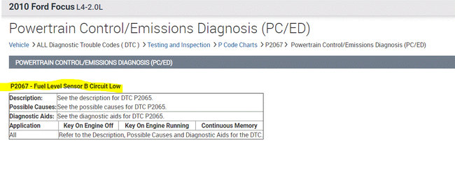

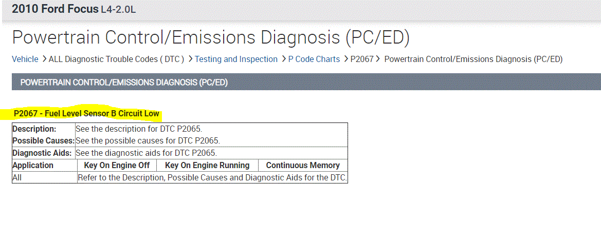

Naturally said, transmission bad. I am sure could be but been having same problem since 2017. But on paper says code tech/DTAF(hope this tells you type of test) labor then says test trans $50.00 transmission producing no fluid pressure, needs transmission. Then as I am leaving he says P2067 code came up. So going to go out see if I can get codes come up.
Thursday, October 29th, 2020 AT 3:49 PM
  • 110,192 POSTS
I need you to confirm that code. It isn't related to the transmission. Take a look at the pic below. Also, low or no pressure could be the result of a clogged cooler or filter.
Let me know what you find.
