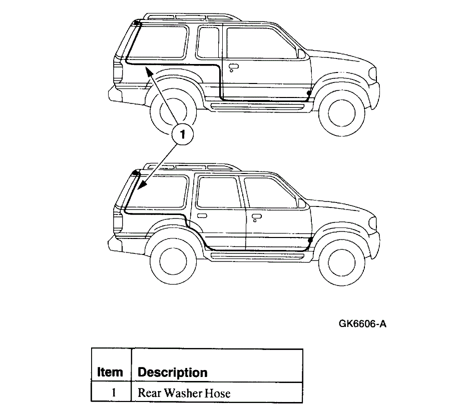

No water spray on rear window. When pressing the button, you can hear the motor running. Removed hose connection at pump located at reservoir in engine compartment on passenger side.
Unhooked hose and put vacuum pump at rear wiper hose - determined that hose clogged or kinked. From wiper hose goes into rear headliner. I would like a diagram of the route to the engine compartment. Look under the car on passenger side - no hoses. Does it run inside car along rail?

If you applied a vacuum at the pump, you won't be able to draw anything through the hose.

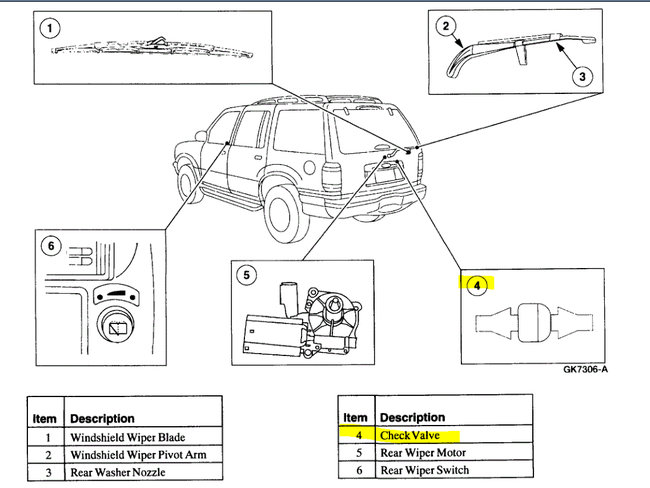

The rear washer hose contains a check valve, which is located in the hose that passes through the liftgate in the rear of the vehicle. it prevents back flow from that point.
If you apply a very low air pressure at the pump location, you should be able to blow air through the hose. Did you try that?
As far as the hose routing, I attached a pic below.

Hi, I removed the hose at the pump (the one nearest the front passenger fender wall). I then removed the rubber tubing from the rear washer blade that goes to the nipple on the hatch door. I then put the vacuum pump on the nipple an applied vacuum. The vacuum held.
On the diagram, I am assuming the water line is inside the car along the passenger rail?

Okay, that shouldn't happen. As you thought, something is clogged. As far as the location is concerned, yes, it is inside and requires the removal of the panels.

I have a feeling it might be the check valve. Do me a favor, disconnect it, and see if you can blow through the hose.
I attached a pic below showing the location.
See pic below.

Okay! Thanks a lot! So that valve is in the hatch door, right?

There is a good chance the wiper motor is bad. And yes, the check valve should be in the hatch.
