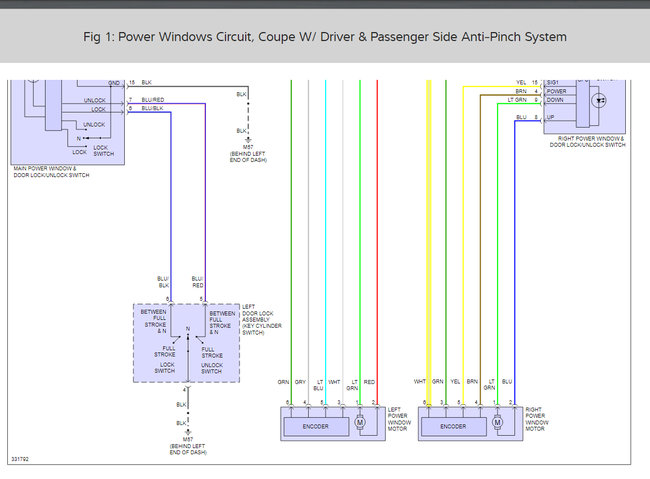

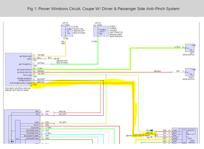

Replaced rear window regulator and still does not function.
Mar 16, 2019 at 4:47 AM
SCGRANTURISMO
  • CAR REPAIR CONTRIBUTOR
  • 4,897 POSTS
This could be a problem with your vehicle's Body Control Module (BCM). Your vehicle's BCM, which is located behind the left side of the dashboard, is responsible for supplying power to the power windows and the power door locks. If the internal circuitry for rear window regulator has failed, no power will make it to the window motor. I have included in the diagrams down below a wiring diagram of your vehicle's power window circuits. Could you do me a favor and check out both the connectors, pins in the connectors and the wire that I have highlighted in yellow. Please get back to us with what you find out.
Thanks,
Alex
