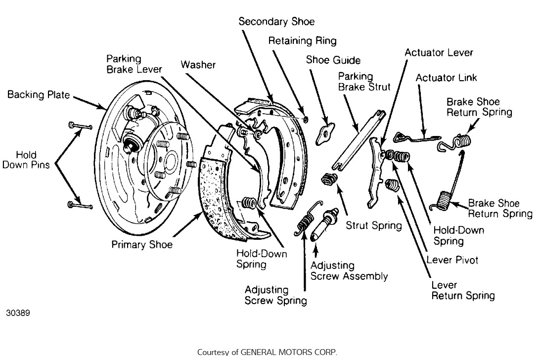

I need to know the order and placement of the springs.

I am assuming this is a brake drum set up. see picture and check out the link it may be helpful.
https://www.2carpros.com/articles/how-to-replace-rear-brake-shoes-and-drums
