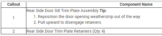

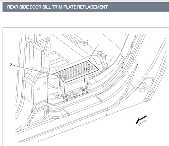

How do you remove the panel to replace the rear passenger seat belt?

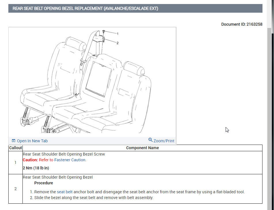

I assume you are talking about the cover over the shoulder strap. If so, I attached the info below for how to do this.
Please let us know if you need more info. Thanks

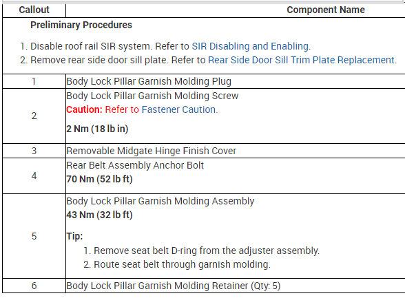

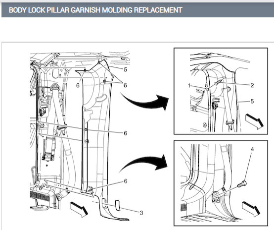

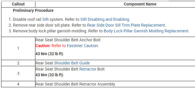

Thank you. I should have clarified. I am referring to the outer seats.

Jus there to add. I've attached picture steps below for you on seat belt replacement. Let us know if this helps. Thanks for using 2CarPros.
