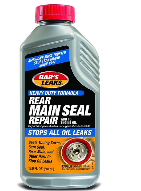

I have a leaking rear main seal which I thought it might be, so I went to Take5 oil and they confirmed. It' not a bad leak at this point so my question is there a Stop Leak oil that you would recommend for me until I can get it fixed?

Under normal circumstances, I don't like using additives because they could cause other problems. However, if this is a temporary fix, you may want to consider Bar's Leak rear main sealer. It is specifically designed for rear main seal leaks.
When you change the oil, the product is used in place of a quart of oil. If you want to add it before an oil change, drain a quart of oil out first. You don't want the system overfilled.
I attached a pic below of the product I'm referring to. It may take a couple of days for it to seal, but I've been told it works great.
Let me know if this helps.
joe
See pic below.

Thank you, Joe, I appreciate your response. I don't have the funds to have it fixed through a mechanic nor do I have the tools or physical ability to replace a rear main seal myself. I should have put this info in my question as well. Does this change your response?

No, that doesn't change my response, and I completely understand. It's hard to afford anything anymore. Give it a try. I suspect you could get it for under 10.00 dollars. It should help.
I do have a question. How bad is the leak? If it is slight, you may want to consider leaving it the way it is. If it is substantial, then the product should help.

Okay, I was wondering if you were able to find it. And yes, it should last a lot longer than a few months. It actually swells the seal and stops the leak.
As far as replacement, keep in mind it isn't uncommon for a rear main seal to leak a bit with this many miles. If it is minimal, you may want to see how long the additive lasts before replacing it. With this many miles, anything can happen. I wouldn't want to see you put a lot of money into the seal only to have something different and more expensive fail.
