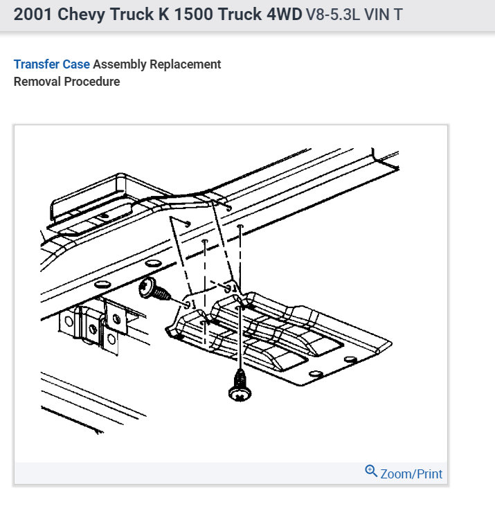

The gasket from the transmission to the differential is wearing in one spot causing a ATF leak. I replaced the transmission and the gasket twice? What is causing that? Also the transmission and differential adapter is cracked like the old one also leaking ATF. I have not been doing any mudding or rough driving other then long distance for work. Found out I have a steel drive line and it is suppose to be aluminum. Could that cause the crack in the adapter and the gasket being worn?

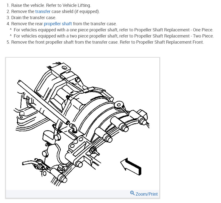

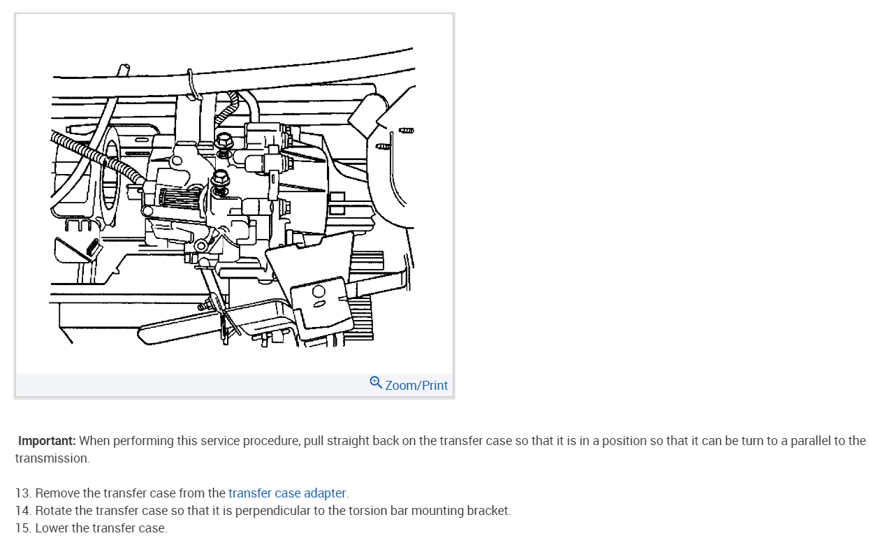

I have a quick question, do you mean the transfer case not the differential? If so there are shaft seals meant to hold the fluid in the gasket is not meant to. I think there is even a relief that allows the fluid to leak out when these seal leak. Can you upload a picture of the location of the leak so I can send instruction on how to fix?

It is leaking where the gasket is/was and the adapter has a crack in it. And yes the transfer case is what I mean. I can take a picture at the moment. I have a 68 1/4 inch drive shaft on it. The adapter is cracked on the transfer case side and the bottom is loose.

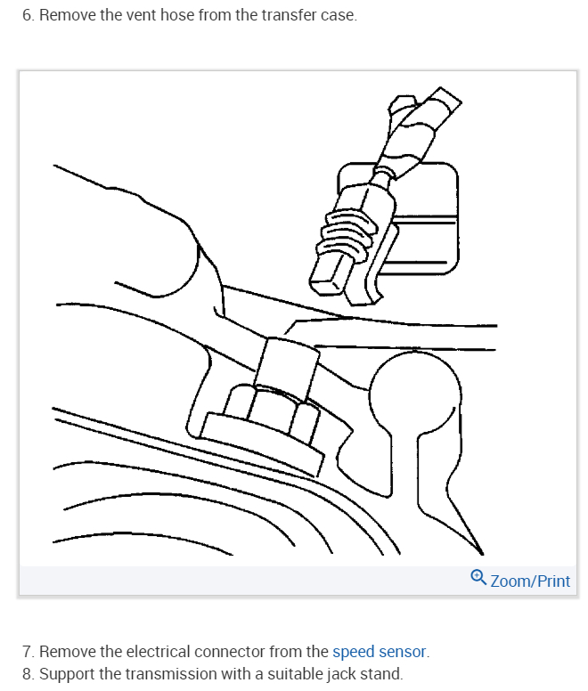

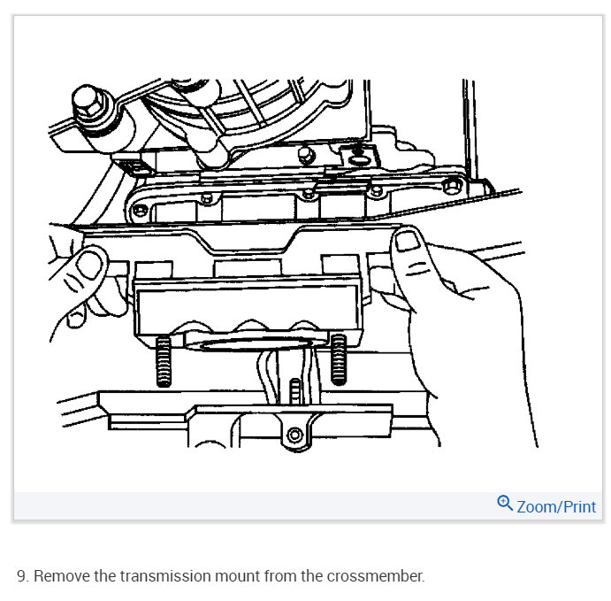

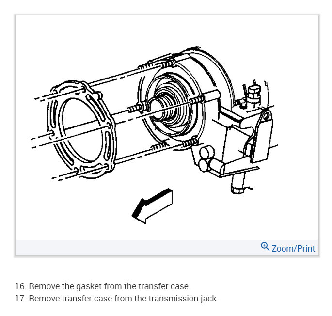

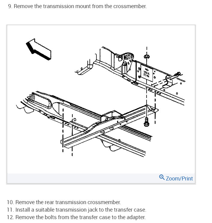

If something is cracked that is not good. If you can get a picture for us we can get you the repair procedure. I just need to see what you are talking about, but if it is what I think it is here are the diagrams to help you get it fixed.
Check out the diagrams (below). Please let us know what you find.

I know how to replace the adapter. But I need to figure out what is causing it.
