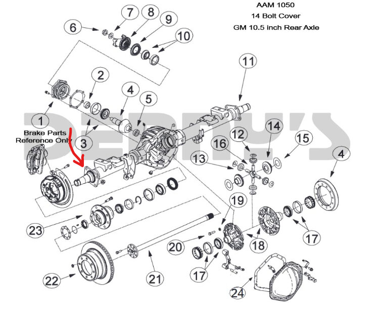

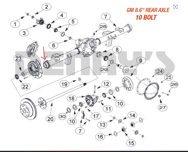

This truck was recently gifted to me. The only thing known to be wrong with it is that the rear differential is going out on it. I've looked around and in my price range, my only option is a pull a part. I've noticed that the whole rear assembly is not much more than the differential itself, so I decided to go with that option. The biggest problem is I cannot find the right size I need for my truck. So, my question is, if I got a rear assembly with the same ratio, but different size differential, will that be a problem? I've found some 8.6 inch differentials with a 4.10 ratio but my truck calls for a 10.5 inch differential with a 4.10 ratio. Can this work and if it does what problems could it cause in the long run? Thanks

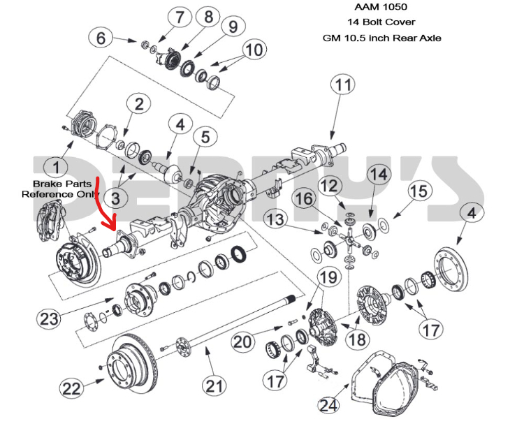

The 2 axles are different on the ends so you would need different brakes at the least. The 10 inch should be a full floating axle, which means the wheels mount to hubs and the 8.6 should be a semi-floating diff where the wheels mount to the axle shafts. It is good that it is the same ratio, but I think it will cause more hassle.
I would put the one in it calls for.
