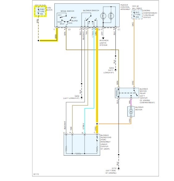

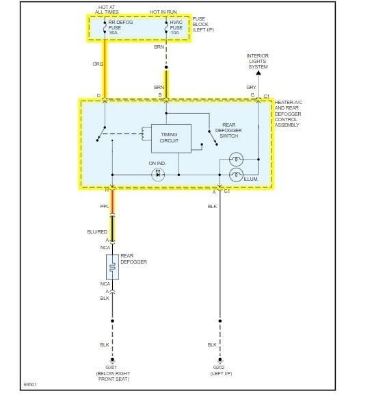

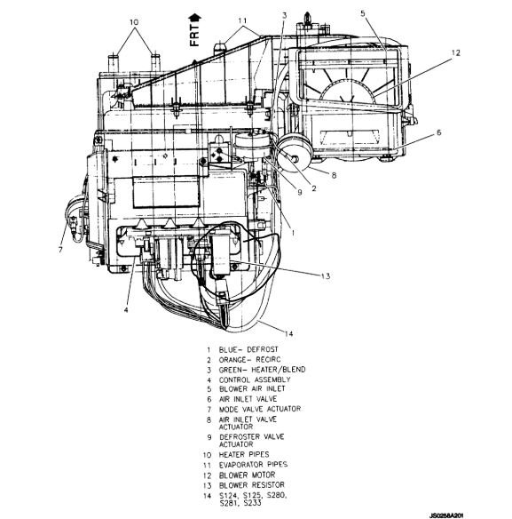

My rear defrost quit working and I checked fuse is good. My heater has only one speed and that is high?

there are 2 fuses for the rear defrost. Verify power to the fuses with a test light or voltmeter. This is not a visual test, it is a voltage test.
The blower motor most likely needs the blower resistor to be changed. A very common failure for this issue.
