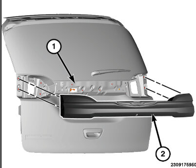

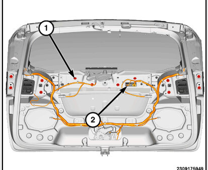

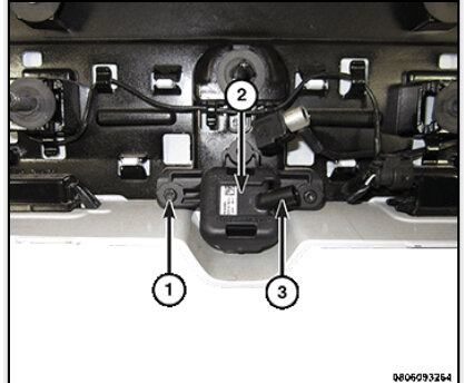

Rear Camera display intermittently shows blue screen what could be the problem?
Apr 20, 2026 at 12:38 PM
  • 54,487 POSTS
9 times out of 10 it will be the camera. Start by disconnecting the battery, then you need to remove the rear panel and light bar housing, the camera unscrews from there, here are the complete instructions. Check out the images (below). Let us know if you need anything else.

Part number, Rear camera for 2017 Chrysler Pacifica Limited ?
Apr 24, 2026 at 2:18 PM
  • 54,487 POSTS
Mopar rear camera part number: 68227397AH
It replaces earlier superseded numbers:
68227397AE / 68227397AF / 68227397AG
