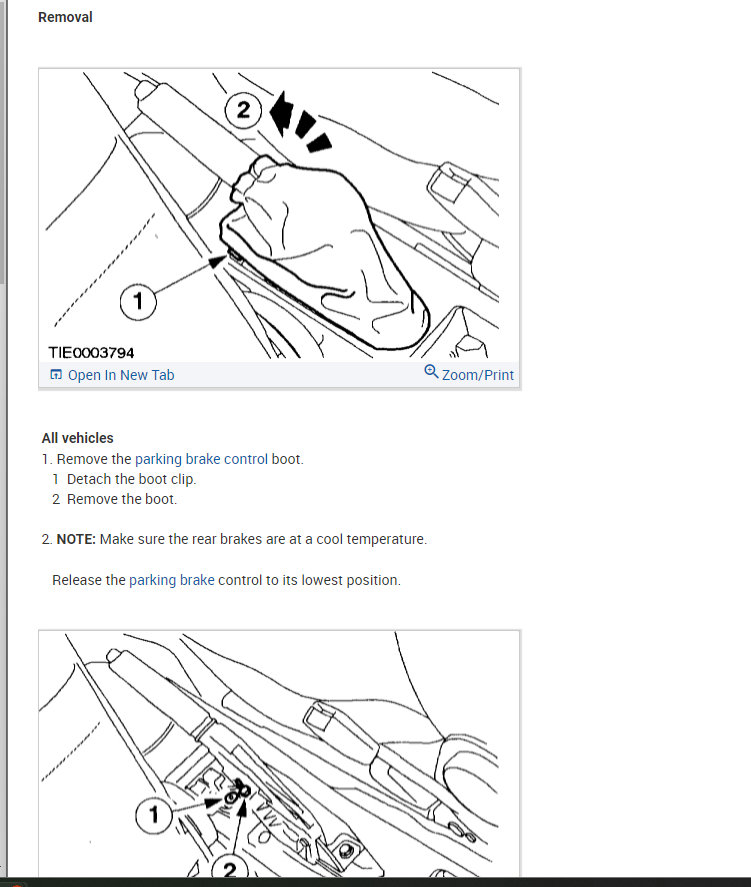

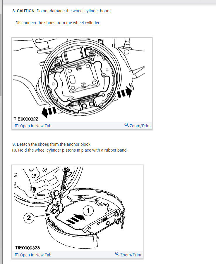

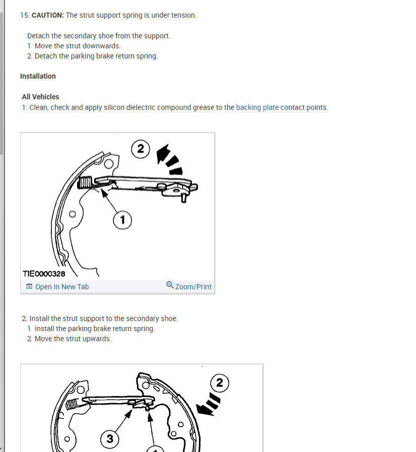

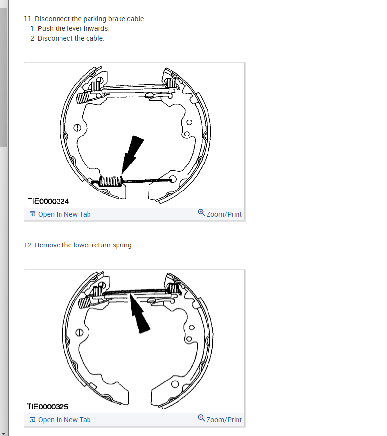

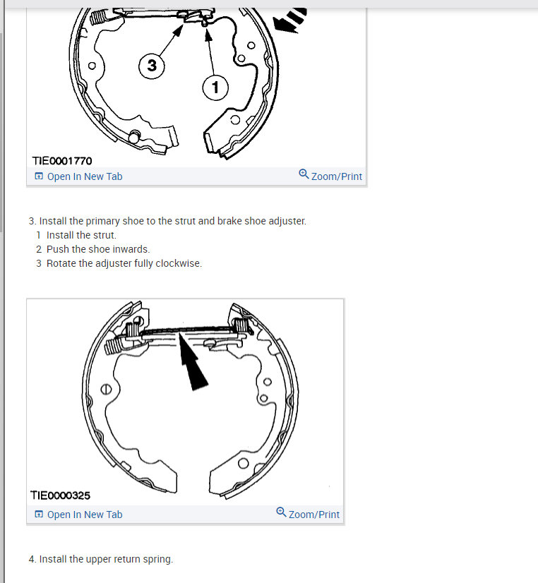

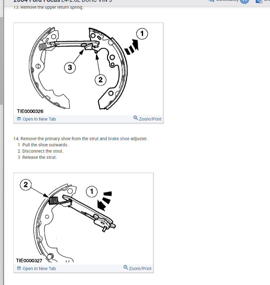

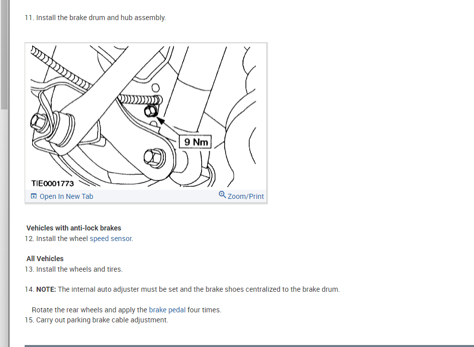

Will 2005 Fiesta adjusters fit on my car listed above?
Jul 3, 2017 at 4:59 AM
  • CAR REPAIR CONTRIBUTOR

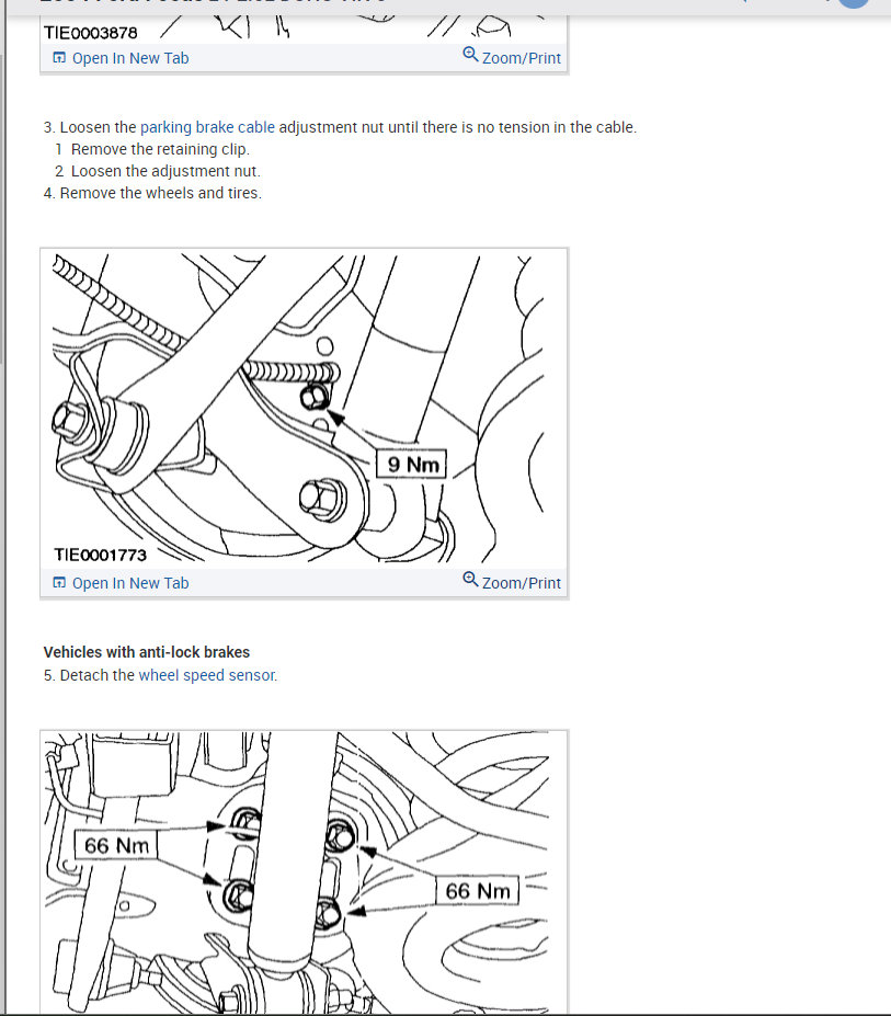

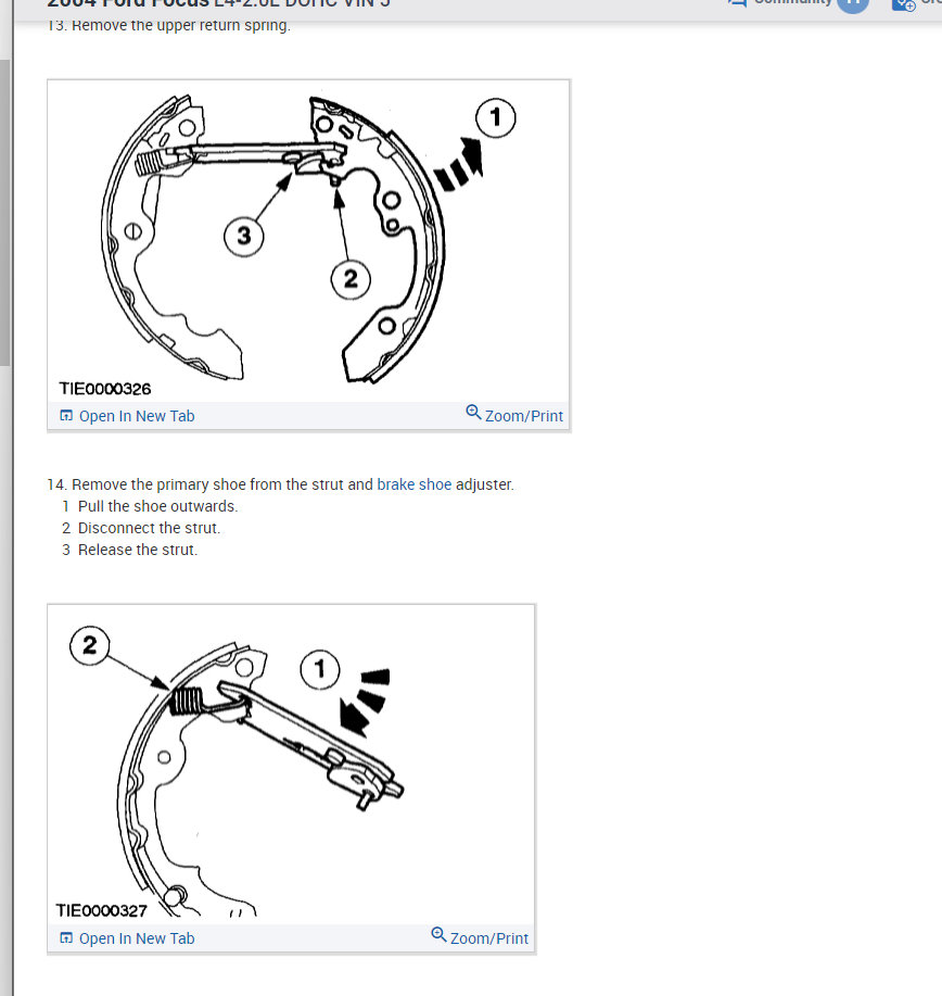

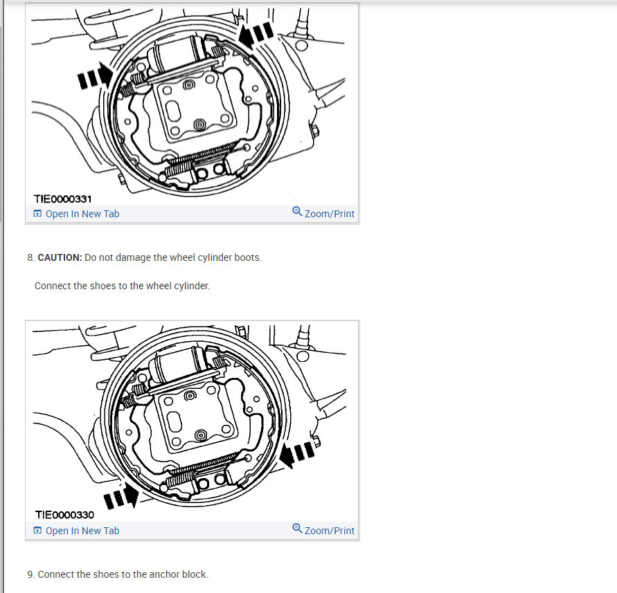

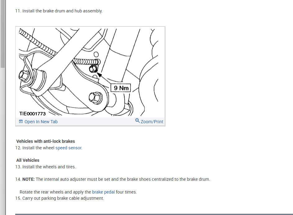

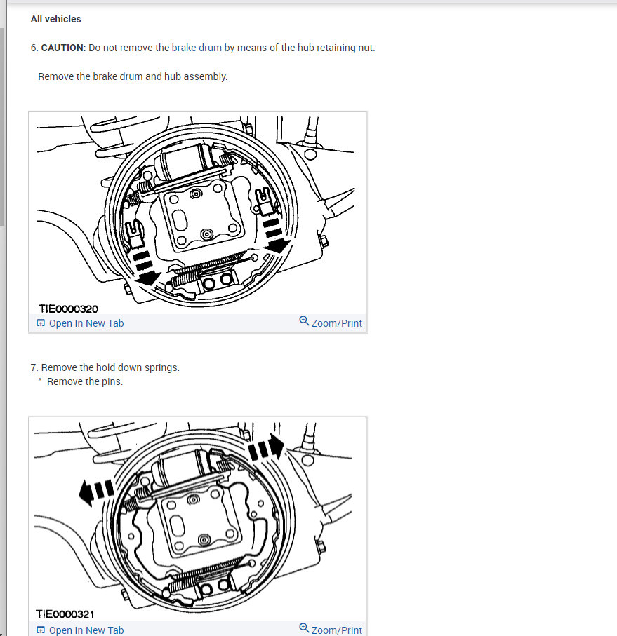

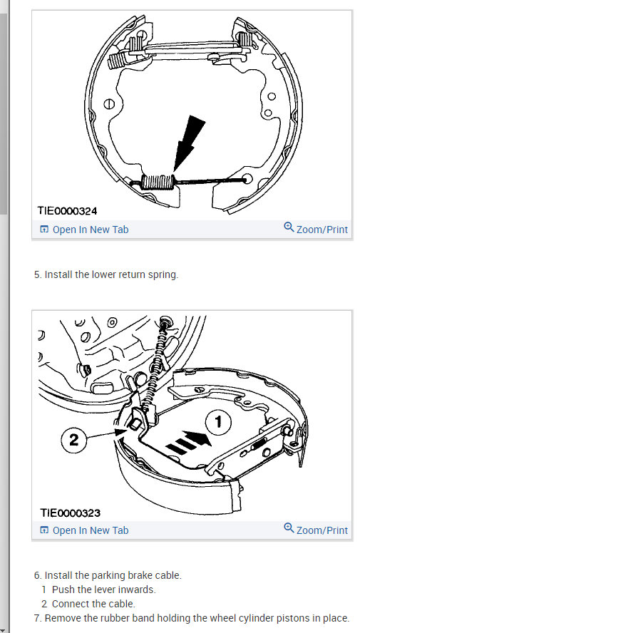

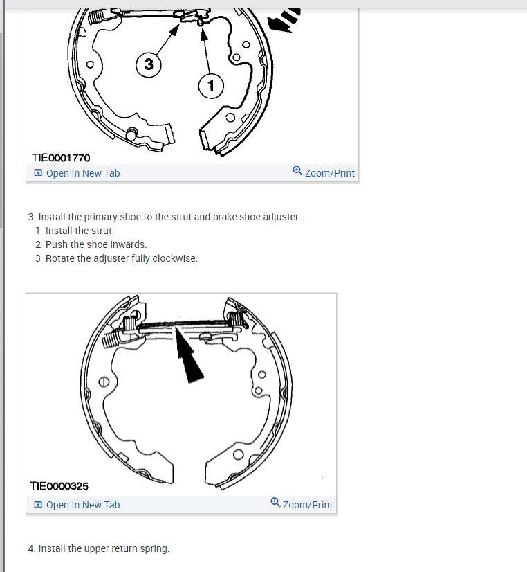

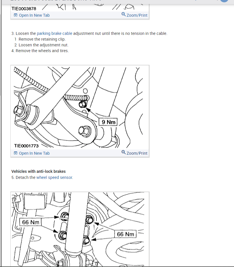

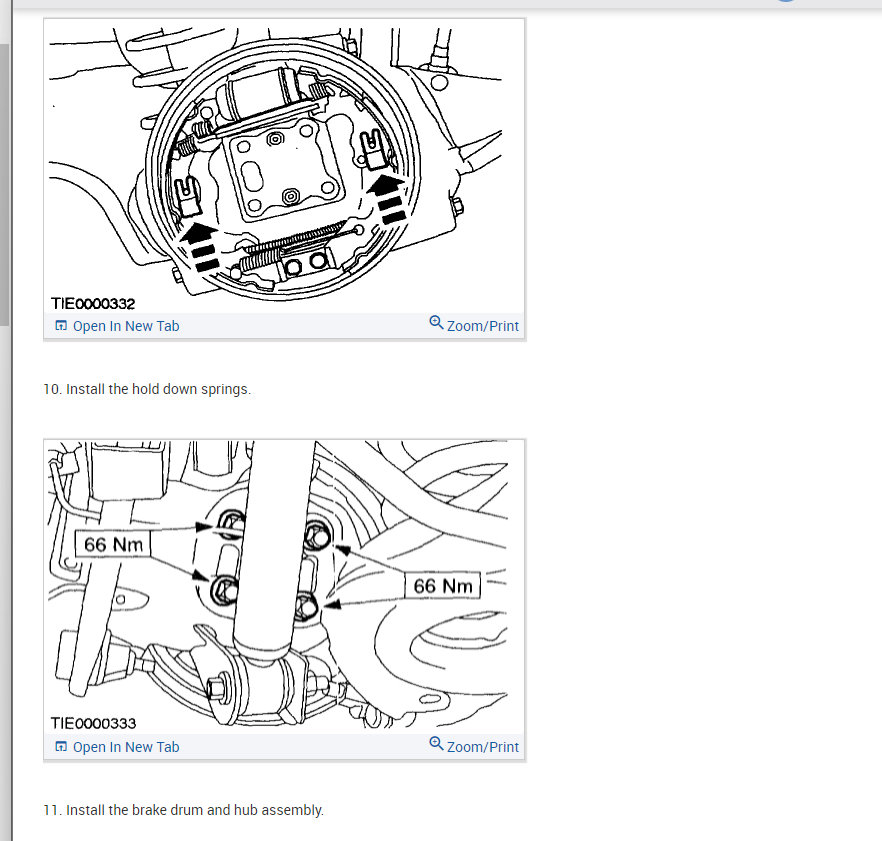

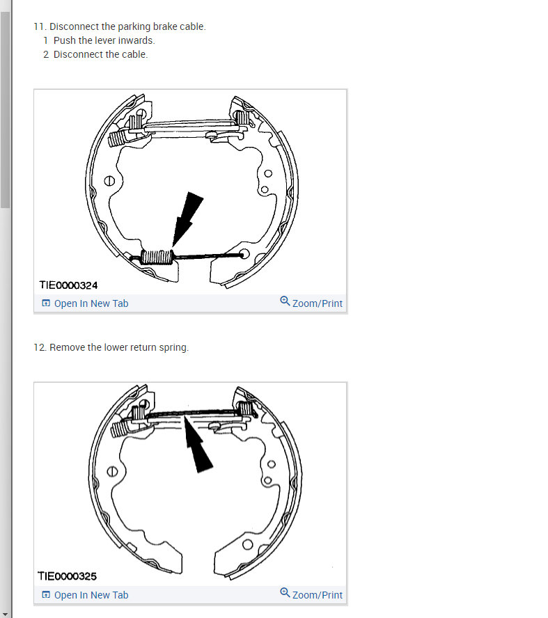

I am attaching the info on how to replace the rear shoes which includes how to adjust them.
Also, here is a guide that will help with this:
https://www.2carpros.com/articles/how-to-replace-rear-brake-shoes-and-drums
Please see the attached info for the detail on how to install and adjust the shoes on this vehicle. Please let us know if you need other info. Thanks
