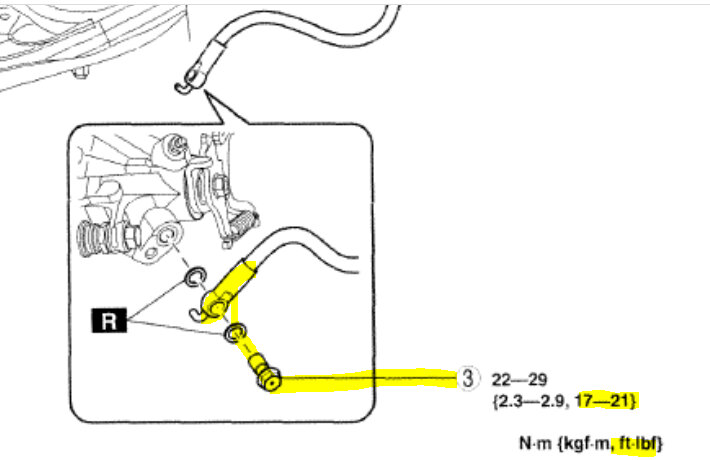

Rear brake caliper torque specs needed?
2014 MAZDA CX-5
120,000 MILES • 2.0L • 4 CYL • 4WD • AUTOMATIC
SASHKO
Hello, I was wondering if you'd be able to provide the banjo bolt torque specs on the rear caliper of the vehicle listed above. Thank you.

As far as the torque specs are concerned, I attached them below for you. See pic 1.
When you reinstall the hose, make sure to replace the brass washers as indicated in the picture.
Let me know if this helps.
See pic below.

Yes, that helps. Thank you very much.
