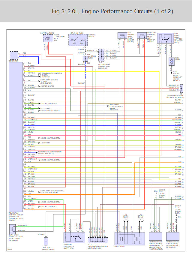

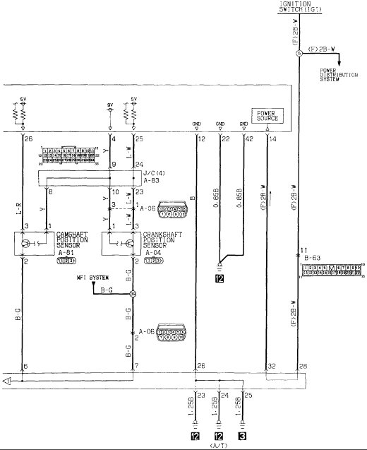

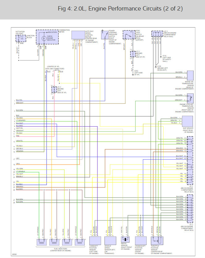

I could really use a wire diagram for my car listed above it is the GS model with a five speed transmission. For the cam and crank sensors. And potentially the ignition coil. Please help me ASAP.
Monday, May 7th, 2018 AT 6:28 PM
12 Replies
  • 110,192 POSTS
Hi and thanks for using 2CarPros.com. Per your request, I have attached three wiring schematics specific to your vehicle. They contain the three different components you mentioned.

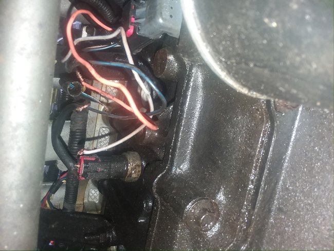

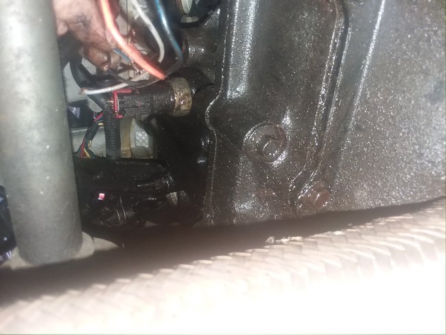

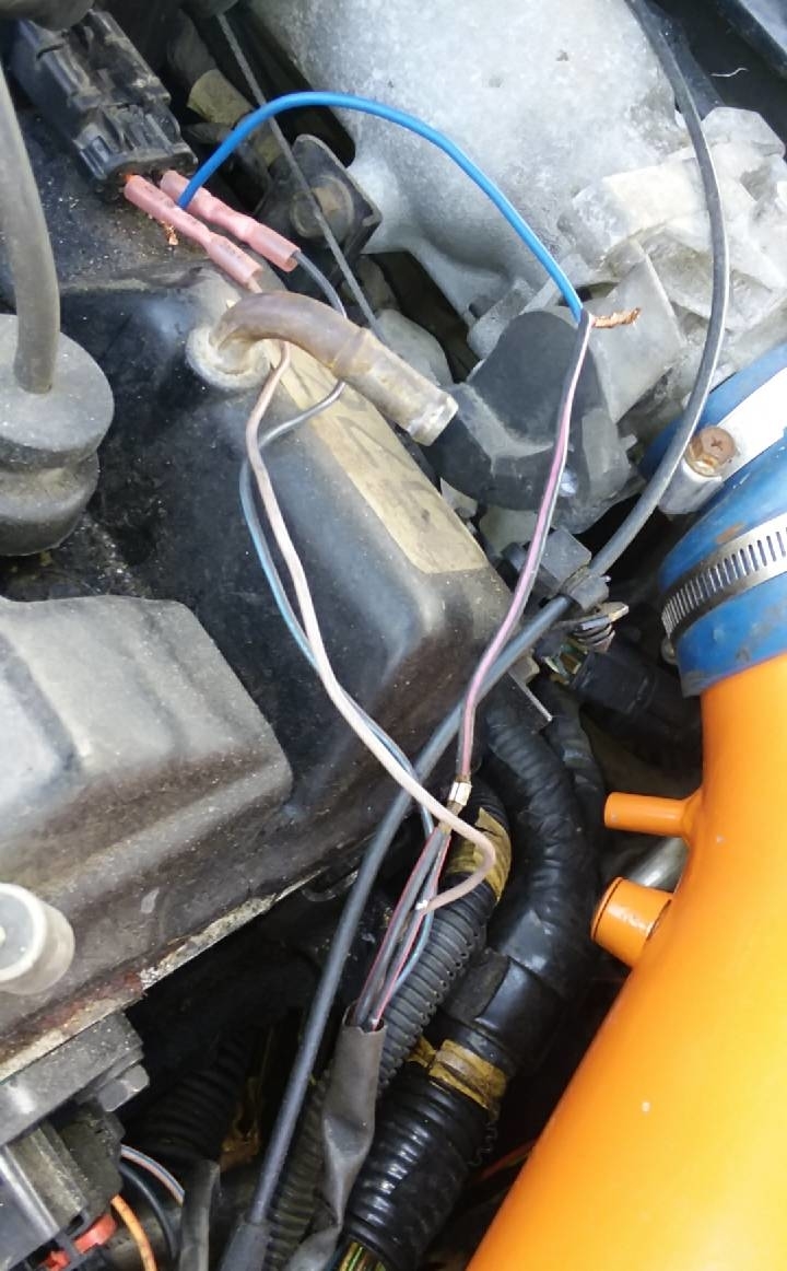

Pretty sure I have it correct. Correct me if I am wrong. Orange goes to yellow. Green and black is the ground which is the middle pin. And finally the signal wire is blue and black.
Monday, May 7th, 2018 AT 10:15 PM
CARMENTAYLOR
  • 8 POSTS
And I have it the same way on the cam shaft as well. Both after market trash pigtail connectors.
Monday, May 7th, 2018 AT 10:16 PM
CARMENTAYLOR
  • 8 POSTS

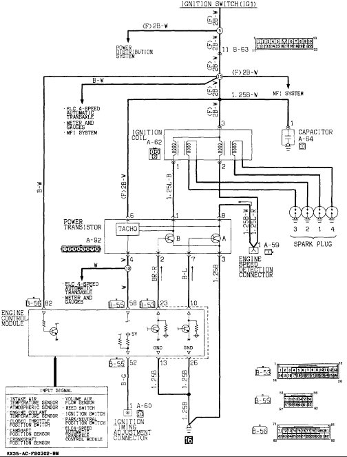

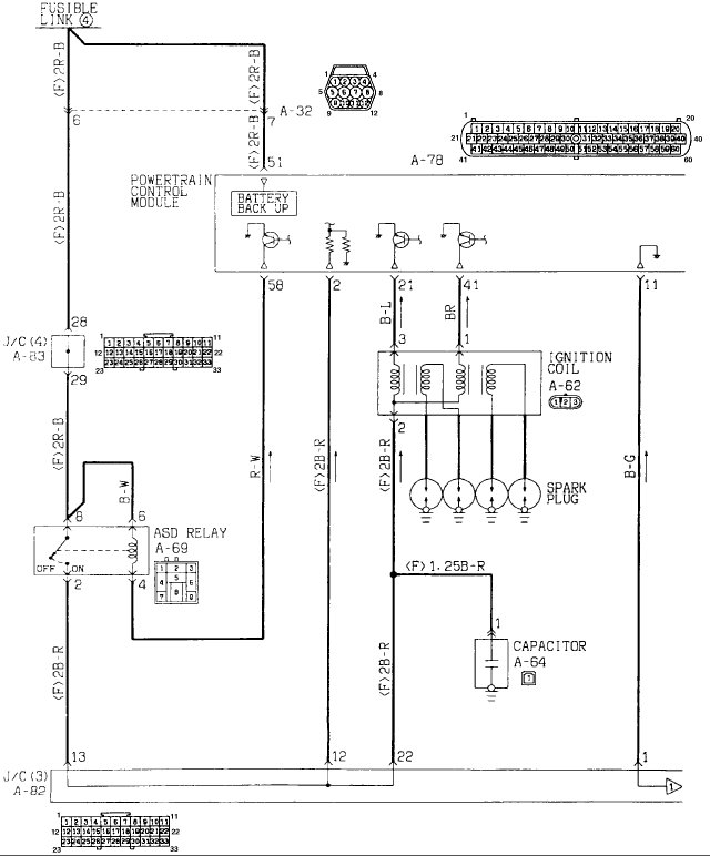

Only difference I have going on here is to the coil pack. I have the black and red wires going to the orange.
Monday, May 7th, 2018 AT 10:19 PM
CARMENTAYLOR
  • 8 POSTS
Only difference I have going on here is to the coil pack. I have the black and red wires going to the orange. I had since swapped them off the middle ground and put it on the orange. That was before.
+1
Monday, May 7th, 2018 AT 10:20 PM
CARMENTAYLOR
  • 8 POSTS
Or can I literally say heck all and grab a random yellow and splice it into the orange Or? I am kind of confused here. I need some assistance.

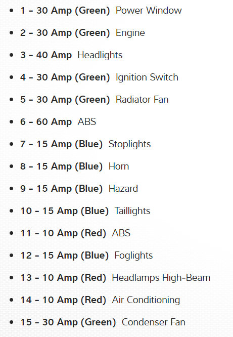

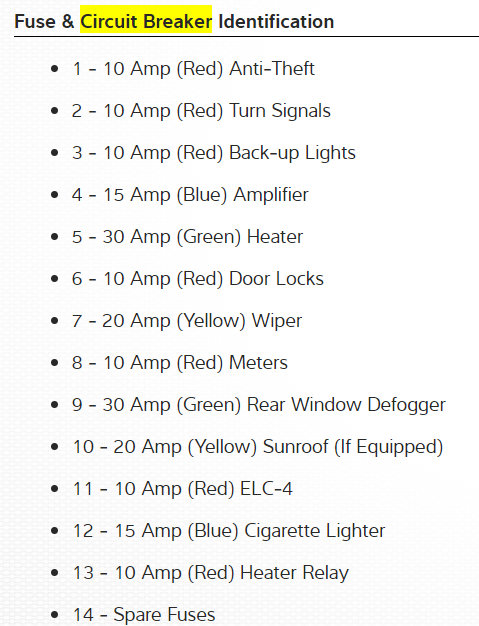

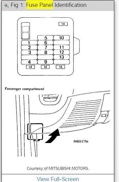

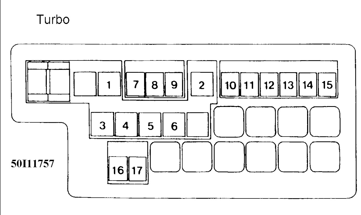

Thank you. I could use a fuse layout for the interior under my dash as well. I am hearing a relay clicking. And my PCM is not sending a signal. I am pretty knowledgeable. But I have had this up for a few years now she comes back to life.
I am looking to get color coded wires to figure mine out. The signal wire colors for cam and crank the power and ground. And then I need a diagram of the fuse box inside the car under my dash on driver side. Then I will be good from there.
Tuesday, May 8th, 2018 AT 11:00 AM
KEN L
  • MASTER CERTIFIED MECHANIC
  • 55,260 POSTS

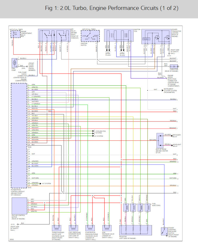

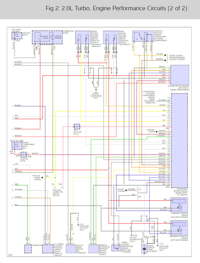

Here are more engine wiring diagrams for both the turbo and non turbo engines and the fuse panel diagrams.
Tuesday, May 8th, 2018 AT 11:05 AM
CARMENTAYLOR
  • 8 POSTS
Your a life saver! That is what I was looking for. This is awesome. This will bring my car back to life. I will let you know how it all goes. I am waiting for my new starter and solenoid. And I have a push button coming for push button start to by pass the ignition switch and the ignition relay.

Can I get a wiring diagram for my coil pack to see what wires are which? I think I have it just about done.
Saturday, May 12th, 2018 AT 4:35 AM
KEN L
  • 55,260 POSTS
It is the third wiring diagram over in the above post.
