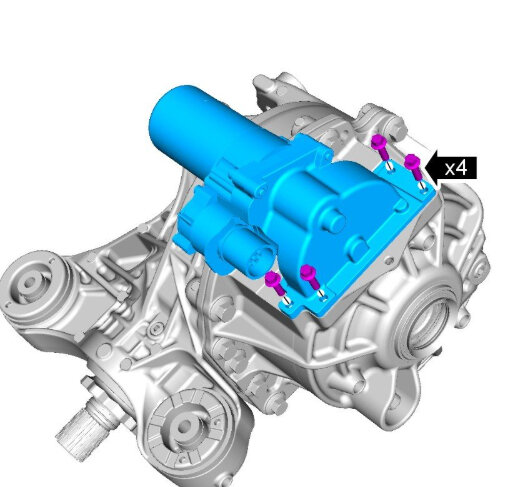

Hello this is Range Rover sport 2014 with Supercharged before the car is good no problem in car customer say's before i washed my car after the fault coming in my car dashboard when i connect the Autel and check the fault the fault is coming in RDCM Rear differential control module P0657-13 Actuator supply voltage A circut/open and also one more code are coming P080A/54 Clutch position is not learned so i'm checking the fuses wiring connectors everything is good but the problem is not going to solved please help me, Thanks
Feb 22, 2026 at 3:10 AM
  • CAR REPAIR CONTRIBUTOR
  • 54,199 POSTS

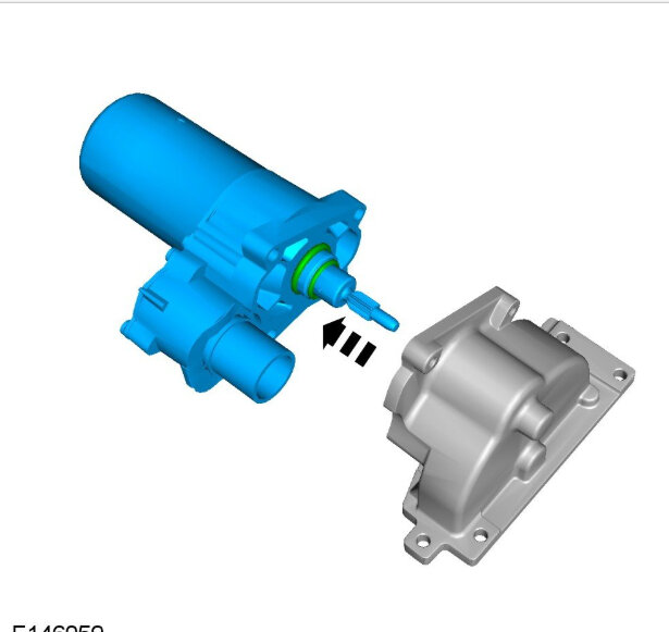

Yep, I have seen the diff fluid wear out and cause issues so I would change that out first and check the electrical connector at the actuator, and then clear the codes, if the P0657-13 code comes back I would replace the actuator
P0657-13 - Actuator Supply Voltage A Circuit / Open
The first code is in result of this code
P080A-54 - Clutch Position Not Learned
You may need to drop the differential to change it out. Clear the codes once the repair is completed and let me know. Check out the images (below). Ken
