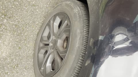

Got this rattling noise, when idle and low speeds or lowering speed. (Foot off accelerator)

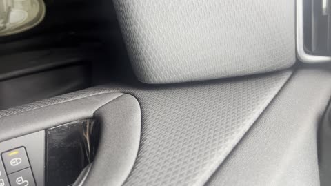

Other video from being idle inside

Hey! Cheers for the reply mate - No engine codes, got it diagnosed yesterday. No engine light. Drives fine also - No differences in driving

Sound of the noise comes from near the wheel, open bonnet can’t hear it that well. Go down near drivers front wheel hear it clear

So the sound is coming quite high up, middle of engine (nearer to drivers front wheel - right) - There are some metal shavings on the aux belt.

Seems to be the alternator causing the rattle.

Hmm,, that could be but I would remove the drive belt and start the engine briefly to see if the noise is still there, please let me know. Thanks for the video.
