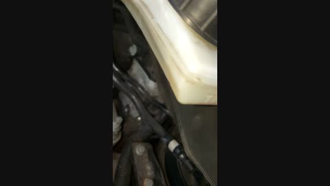

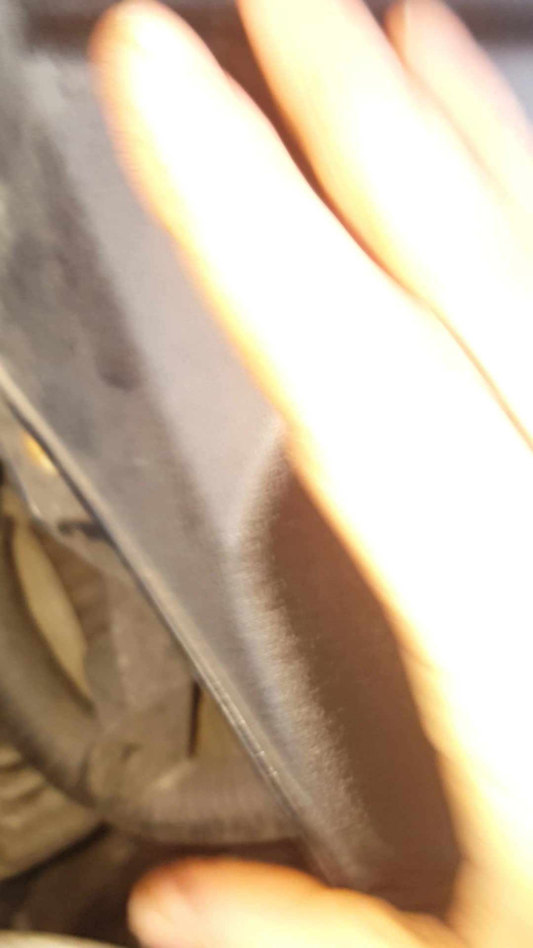

Rattling noise when engine is running. Can be heard whilst driving also. Car runs fine currently with know diagnostic errors present.

Can you upload a video with sound of the noise?

Hope this helps. Thank you.
May 6, 2018 at 2:29 PM
MATT B1981
It seems to start around the 1.07 mark on wards.
May 6, 2018 at 2:31 PM
  • CAR REPAIR CONTRIBUTOR
Good video.
It does not sound good. It sounds like the lower end has an issue whether it is rod or main bearings.
Looks like a major repair coming your way. Sorry.
