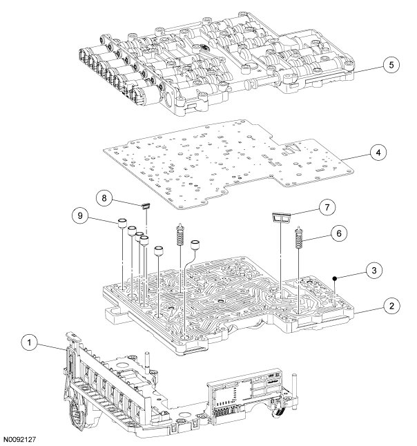

Where is the range sensor located on my truck listed above?

The range sensor is located internal to the transmission. It is part of the lead frame assembly mounted on the valve body. Number 1 in the diagram.
