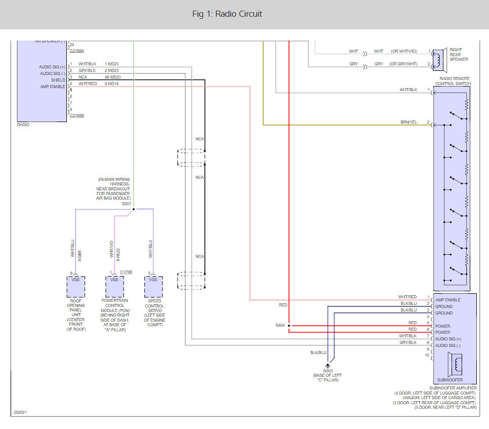

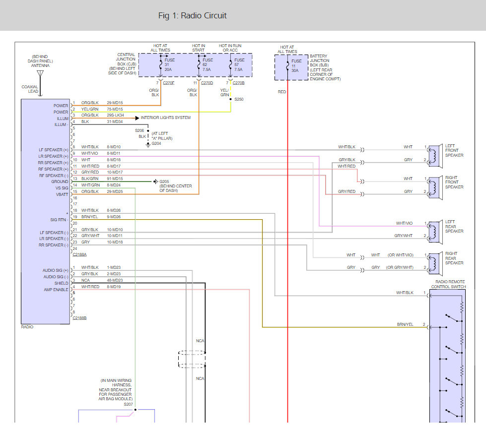

I cut the factory stereo wiring harness for the sub-wolfer. The harness connector has ten slot with seven wires, two red two black with blue, one red and white, and one grey with black and white with black. do you have a diagram for this?

Here are the radio wiring diagrams along with a guide on how to check electrical circuit in case you need it:
