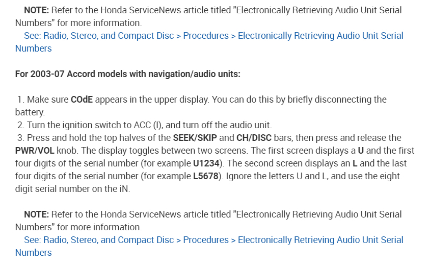

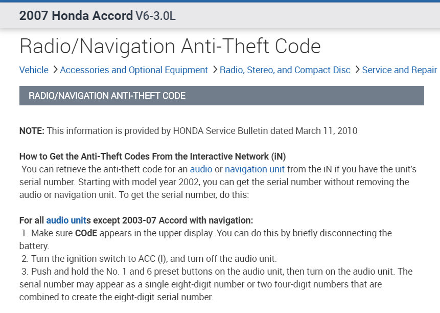

Battery was disconnected and now I can't reset my clock or get the radio to work. I just bought it today and I think I have the code but it stays on "error" and won't let me put the code in. Have followed the directions in the manual but can't get it to do anything. The clock just keeps blinking a wrong time.

In the diagrams down below I have included the instructions from the vehicle manufacturer on how to input the Anti Theft Code into the Stereo/Navigation Unit so that it will operate. Please go through this guide and get back to us with how everything turns out.
