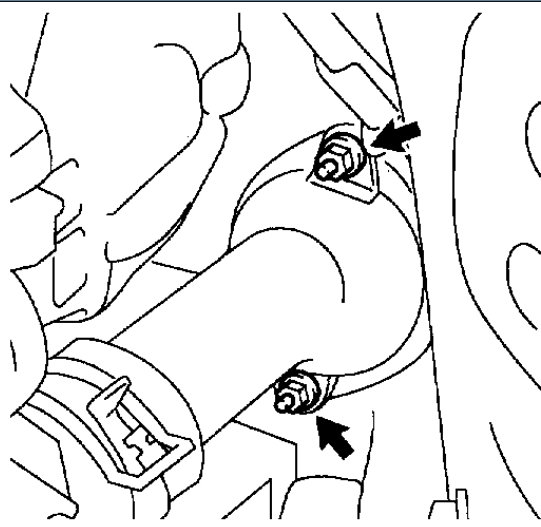

I was working on my car and accidently snapped a stud that holds the thermostat. What is the replacement stud part number for the thermostat housing?

I've attached a picture below of the thermostat housing to see if these studs are what you're talking about. Also, Is there enough broken stud left sticking out to remove with vice-grips are you going to have to use a screw extractor? Let me and we'll go from there. I will get you the part number. Hope this helps and thanks for using 2CarPros.

Hello, yes that is correct! I already removed the top stud. What is the part number please?

Since you have the other stud removed, I would go to Fastenal or the dealer if you wish to match up the stud.
I see no part number in any of my catalogs.

I checked but I'm having trouble with the dimensions. I want to order the correct size.

Take the other stud you removed with you to match the thread sizes.

I found spare studs in my tool box. Cut off the head with a hack saw and it works perfectly. Thank you guys for your help and patience. You're awesome!

If you want to avoid all that hassle just go with the Toyota factory replacement stud the Part Number is 9012606022. The price is $3.72 a piece. Available at any local Toyota dealer. Hope this helps and thanks again for using 2CarPros.
