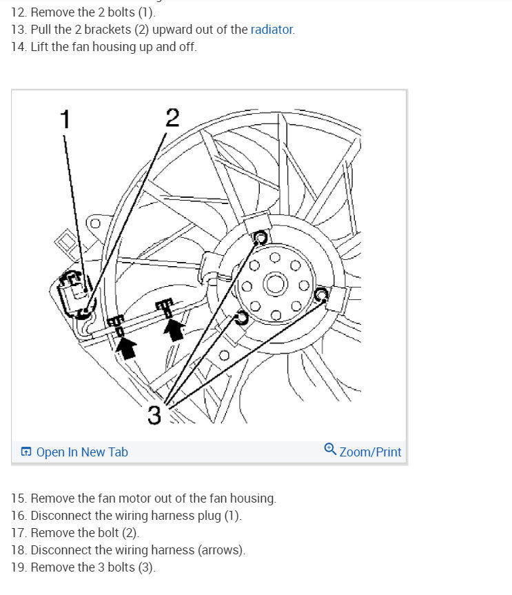

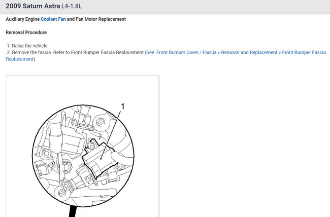

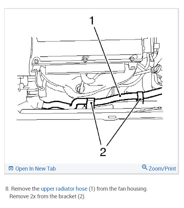

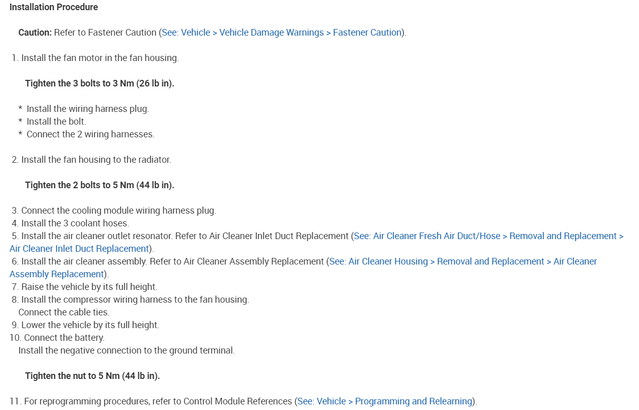

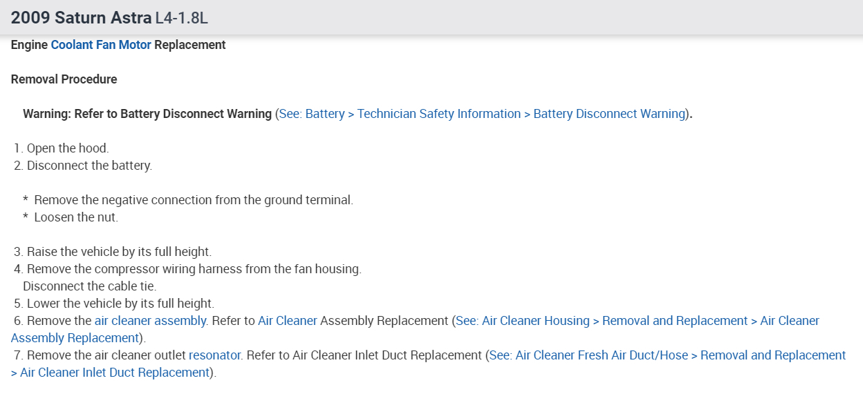

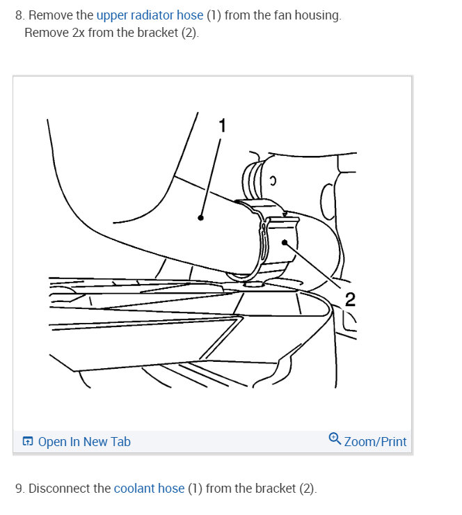

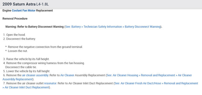

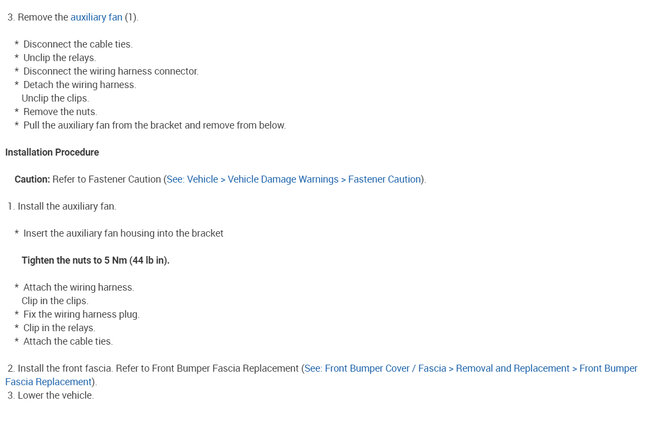

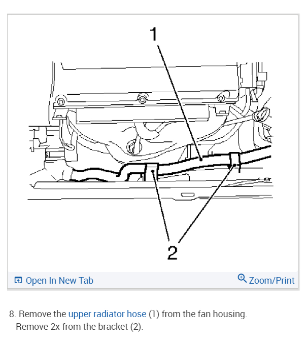

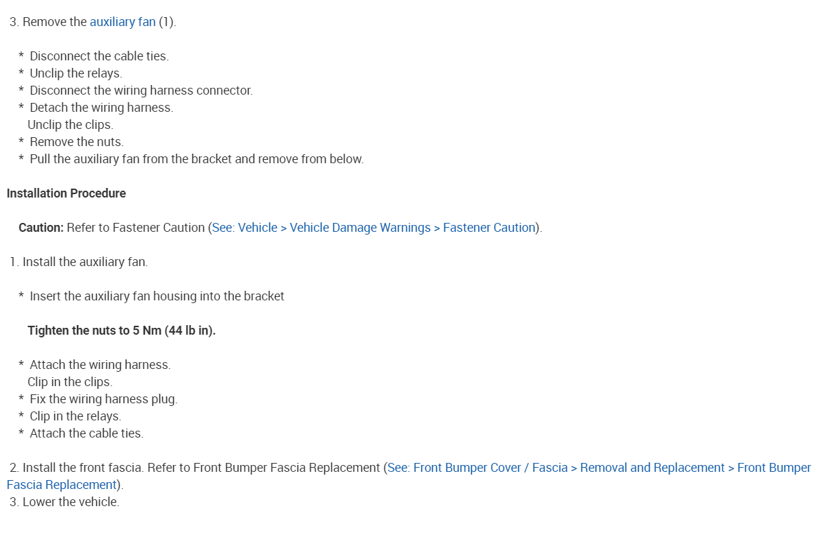

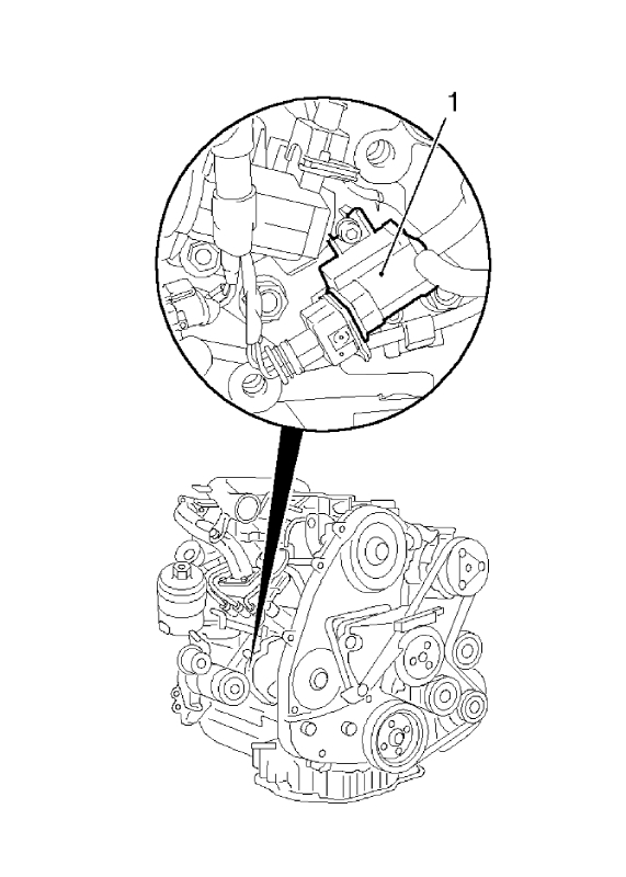

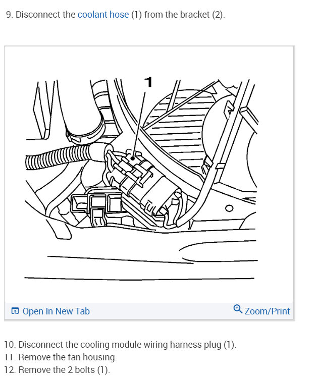

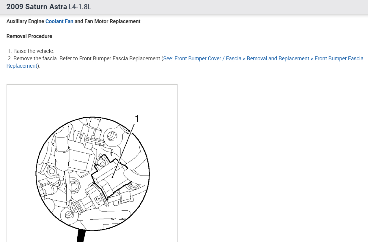

Can you provide a set of instructions for removing the radiator fan of the car listed above? Thanks for any help.
Wednesday, July 12th, 2023 AT 6:00 PM
KEN L
MASTER CERTIFIED MECHANIC
55,266 POSTS
Sure, here is a generic guide to help you step by step with instructions in the diagrams below to show you how on your car:
https://www.2carpros.com/articles/replace-electric-fan-motor
Check out the images (below). Please let us know if you need anything else to get the problem fixed.
