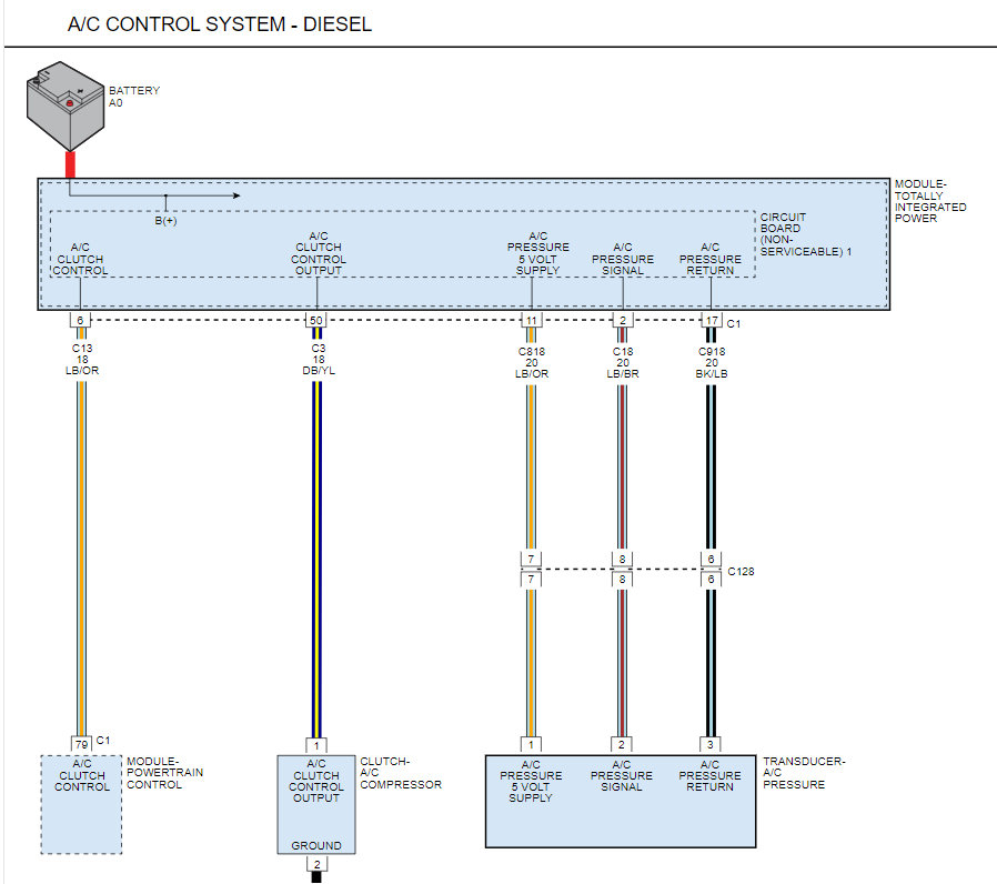

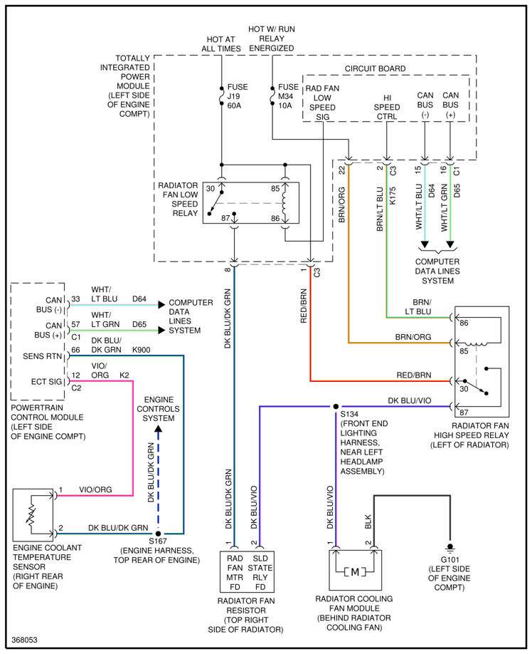

I have a problem with my vehicle listed above 2.8crd MultiJet diesel van. The first problem is that the radiator fan is running at high speed continuously when the engine is running. Even with the 60A fuse disconnected it will run.
Second is the power to the A/C compressor clutch. I have replaced compressor, condenser, filter-drier and pressure transducer switch. Also, the system is flushed and refilled with r-134a. There is no power to the compressor when the A/C switch is selected on the Climate control unit.
Checked the TIPM but no visible problems.
I have tried to find electrical diagrams of the TIPM, PCM etc., but with no result.
I hope someone can supply those diagrams to start further electrical investigations.

Below please find relevant wiring diagrams for the 2.8 diesel.

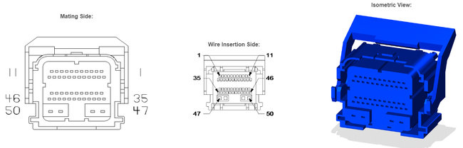

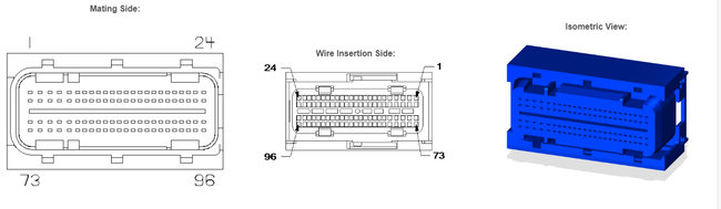

At PCM connector C1 is black, 96 pin, see image 3
Image 4 is the TIPM layout

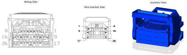

Connector C1 at TIPM is black, 50 pin, see image 5
Connector C3 at TIPM is green, 26 pin, see image 6
Hope this helps.
