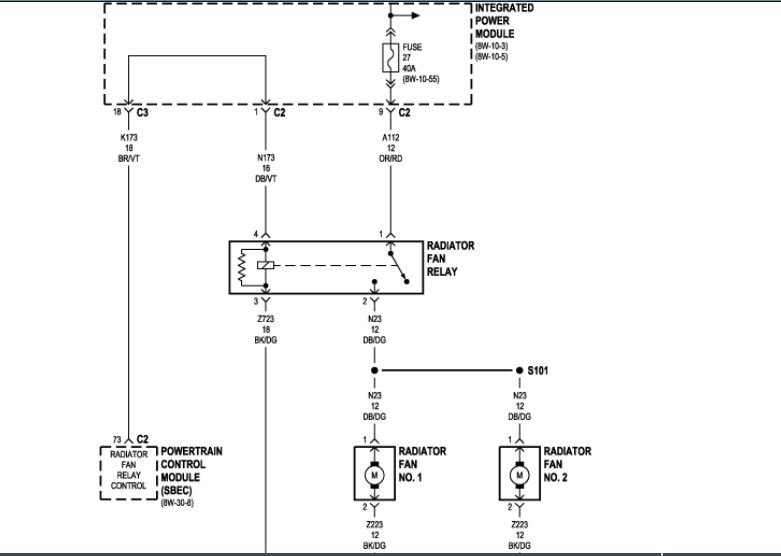

The fans will not turn on, but it never gets overheated. What can it be?
Tuesday, April 24th, 2018 AT 5:55 AM
MECHANIC
52,796 POSTS
Good morning.
It could be the fan itself, relay, fuse or wiring.
I attached a wire diagram for you to view. Check the fuse listed in the fuse box for power on both sides.
