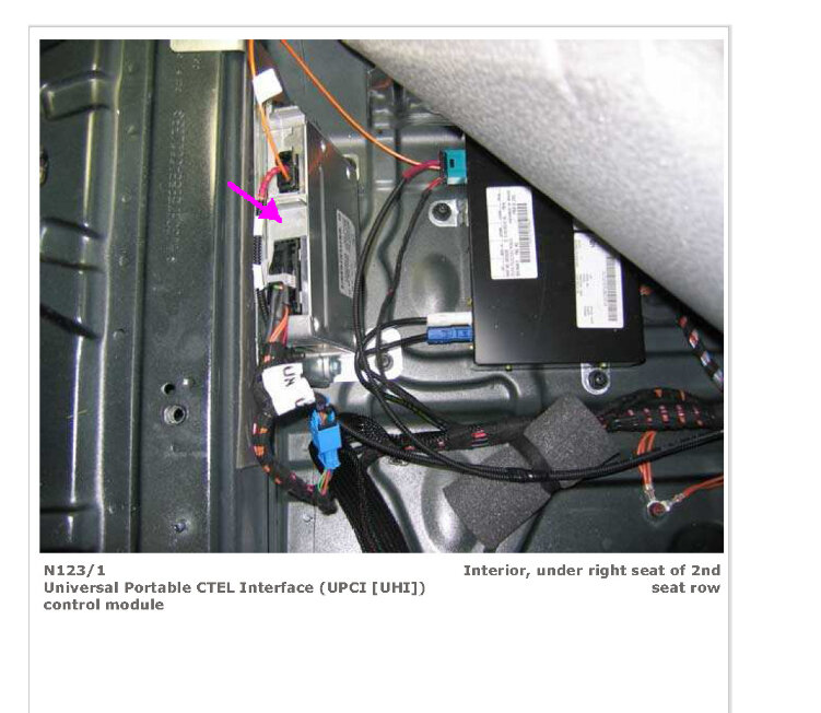

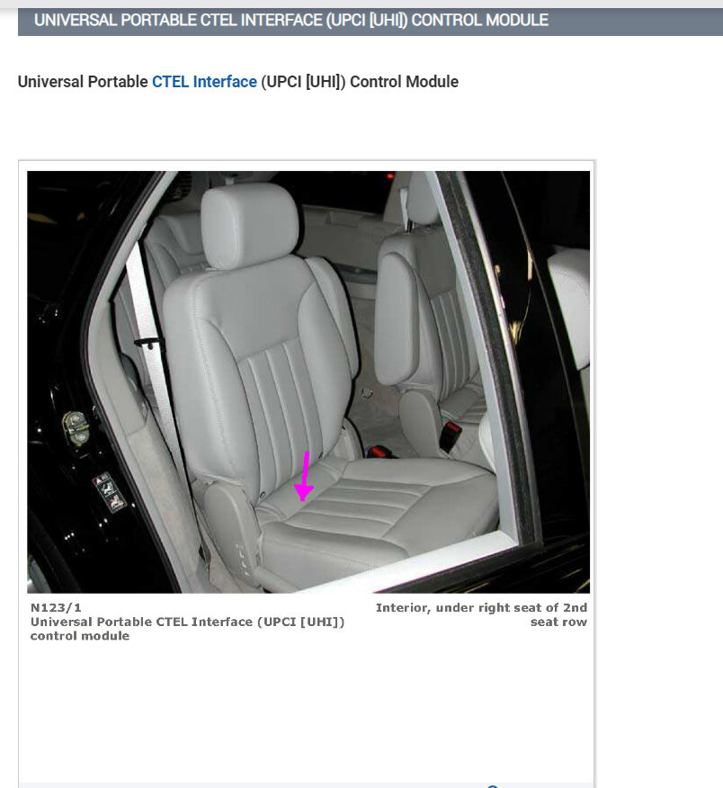

Hi all,
This time I am trying to localize Control Unit for Mobile Phone (A2118703926 or 3226 or 2726 etc.) EPC shows it somewhere on the back side (under rear seat driver side) but this place is not same like in ML W164 where this module is under rear seat on driver side.
Thanks as always for picture help. :)
Lukasz

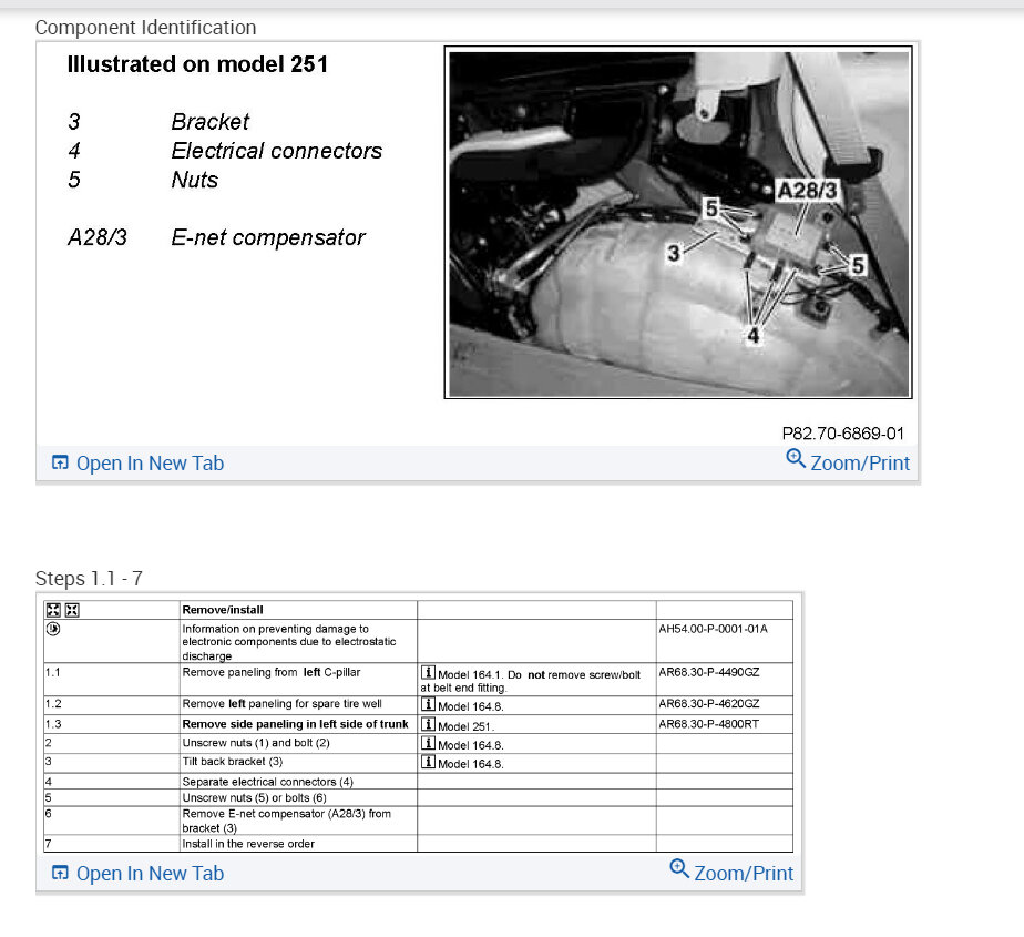

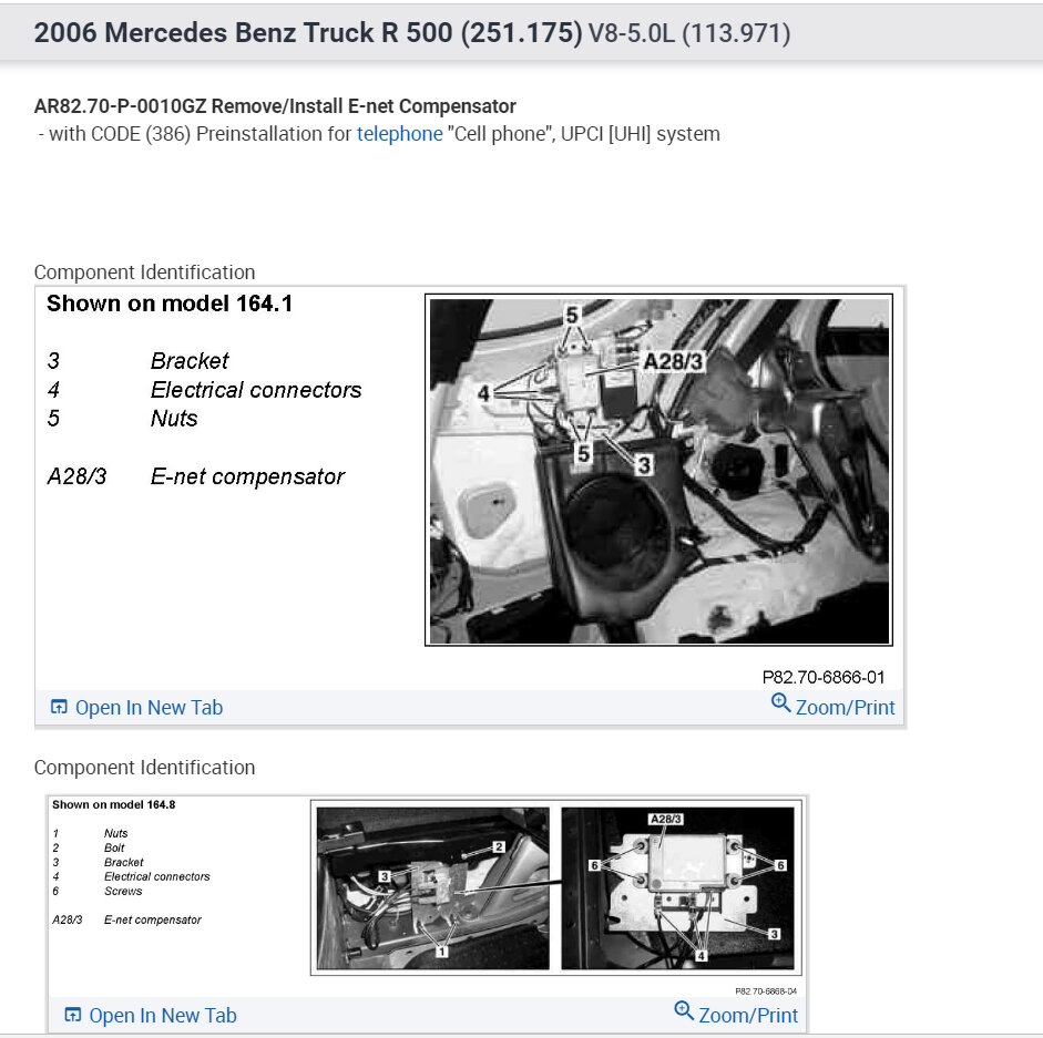

Here is some information on the mobile phone system with diagrams and locations in the images below:

Check out the images (below). Please let us know if you need anything else to get the problem fixed.

Many thanks Ken. Yes, my problem has been solved. I was looking at the rear left side of the car and that's why I couldn't find it. Now I know that it is on the rear right side. :)
Thank you!
