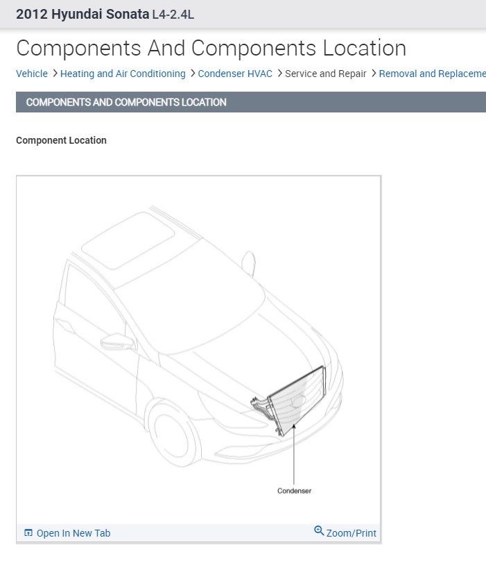

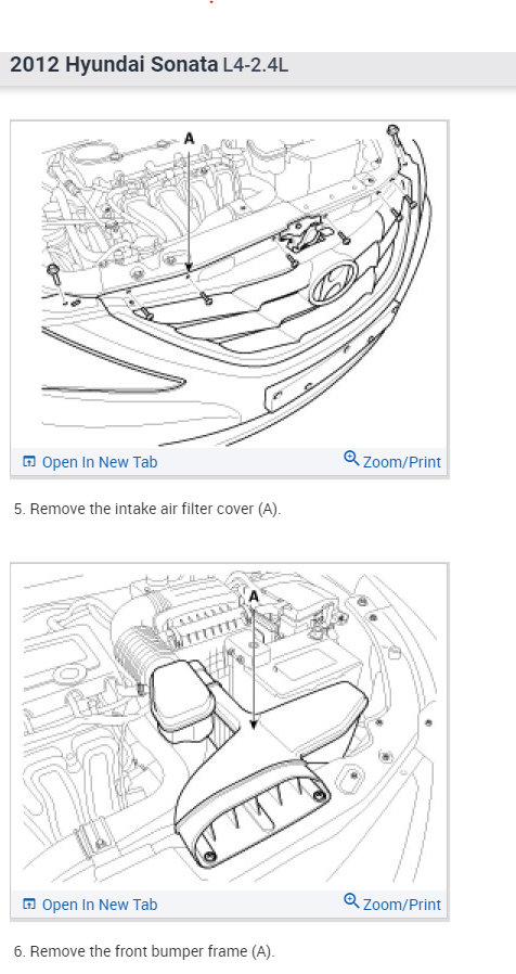

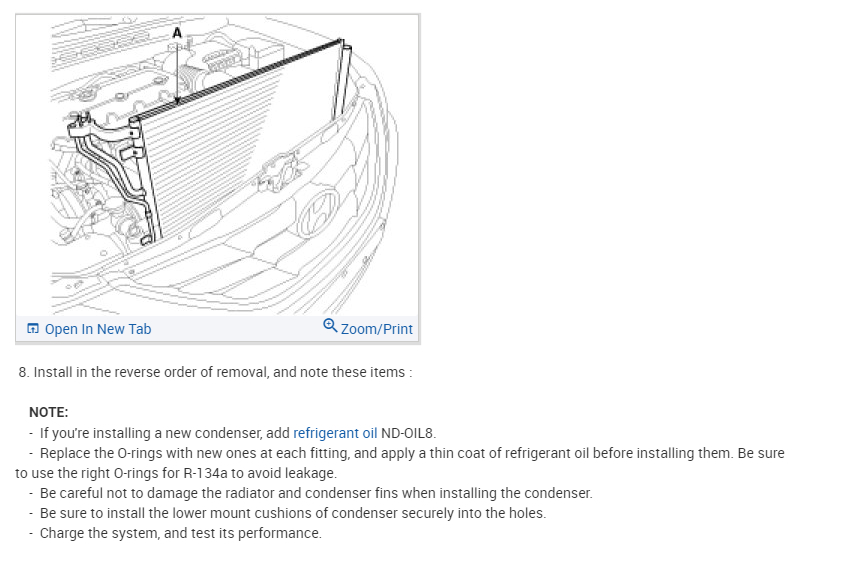

My condenser for A/C got punctured while replacing the radiator. All the refrigerant has leaked out. I would like to replace the condenser by myself and then bring it to mechanic to fill the A/C refrigerant. Do I need to replace the dryer bag since it has been exposed to air? What should I do? The car is stuck in my garage because the radiator is also removed?
