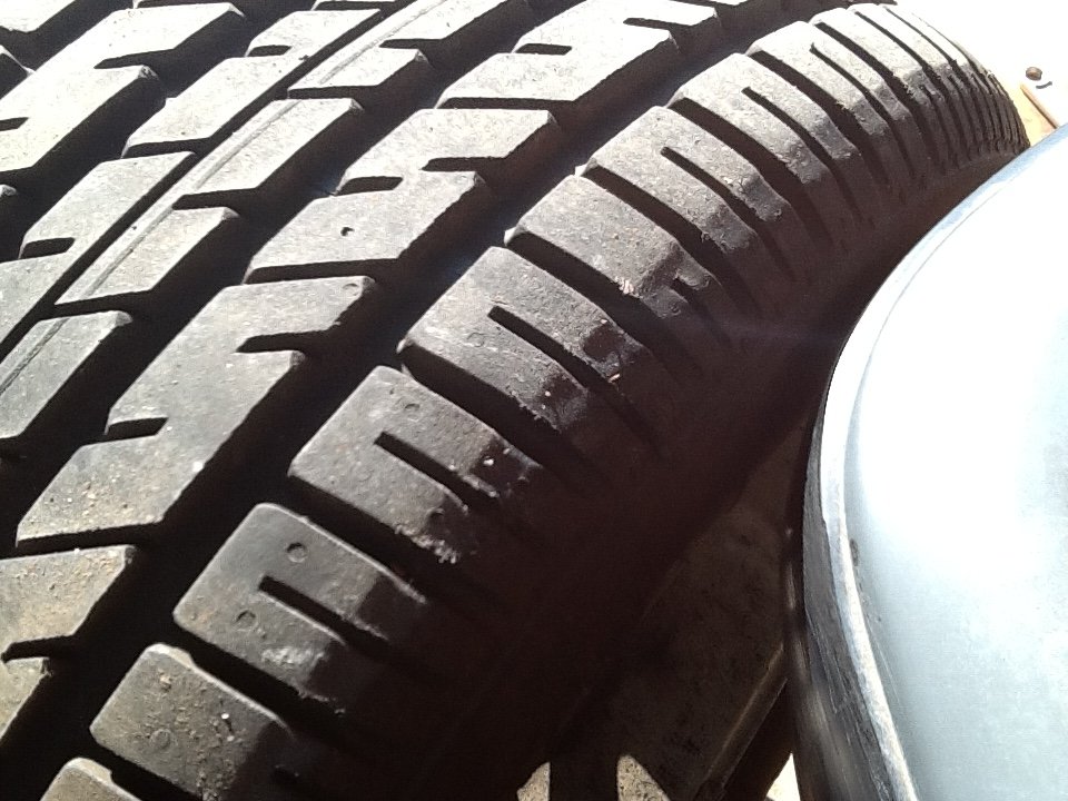

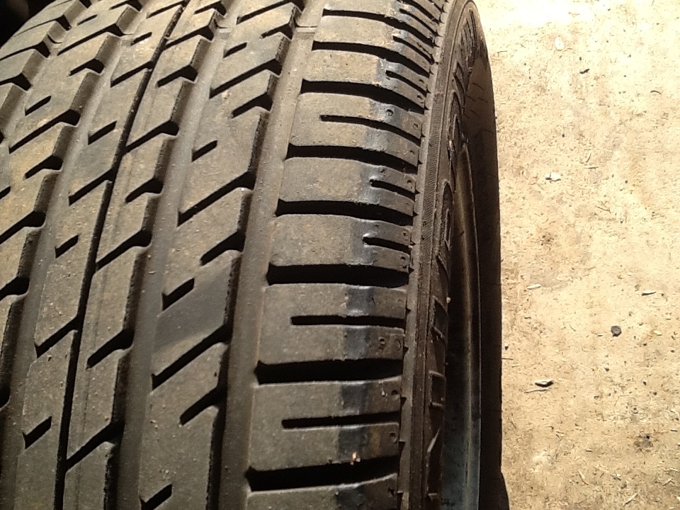

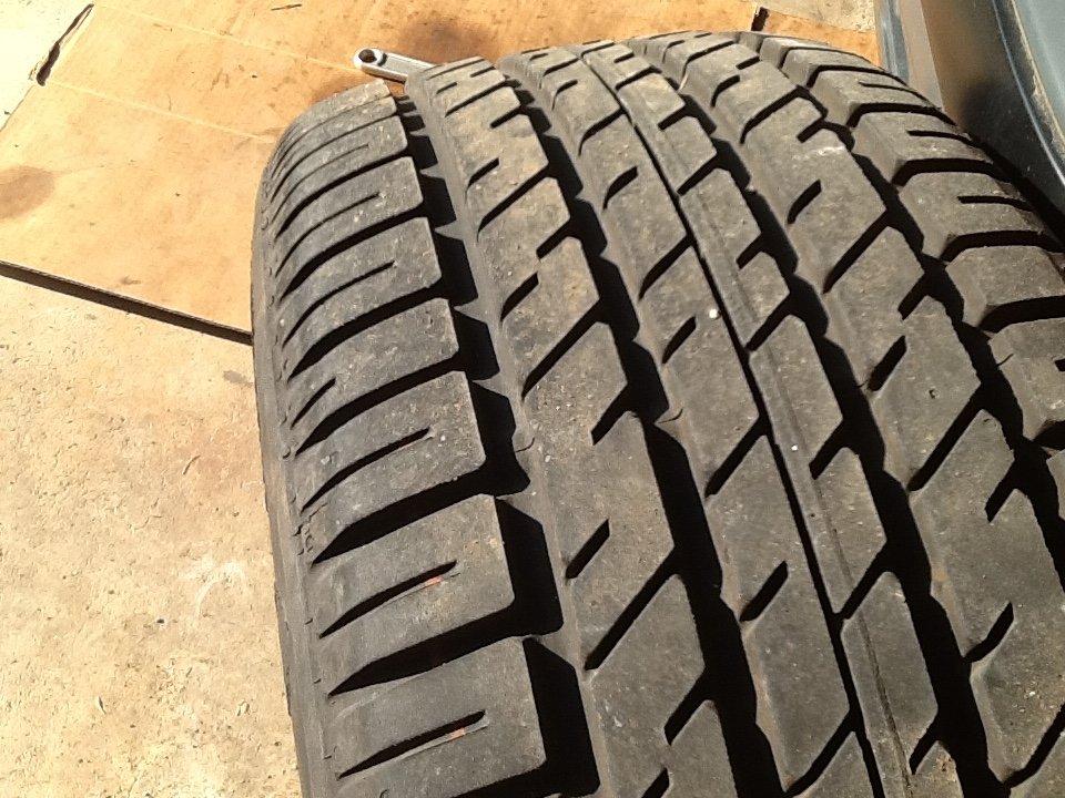

Well, when trying to re-align the wheels yesterday and today, thinking that the alignment was way off since the suspension had been changed, I noticed that the left (driver) side strut was wearing away the inner corner of my brand new tire (less than 100 miles).

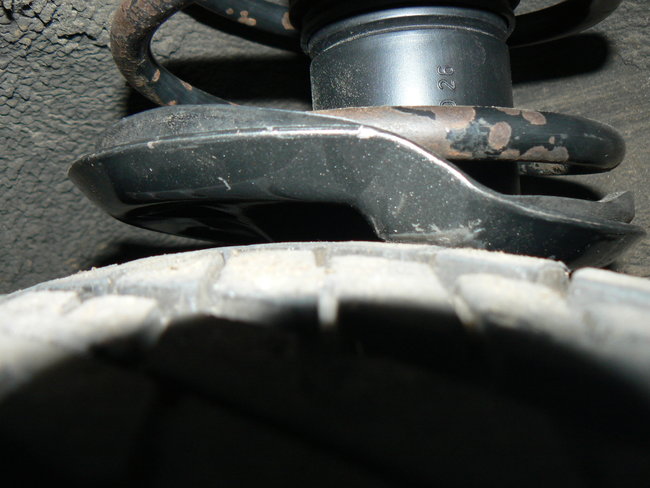

The inner corner of the tire is rubbing up against the area of the strut that the end of the strut spring sits in - the cup for the end. At the moment I am too bummed out to take a picture but will do so in the next day or so.

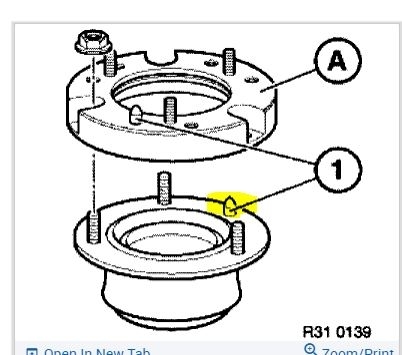

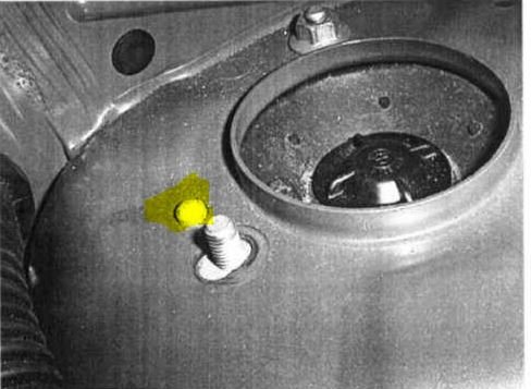

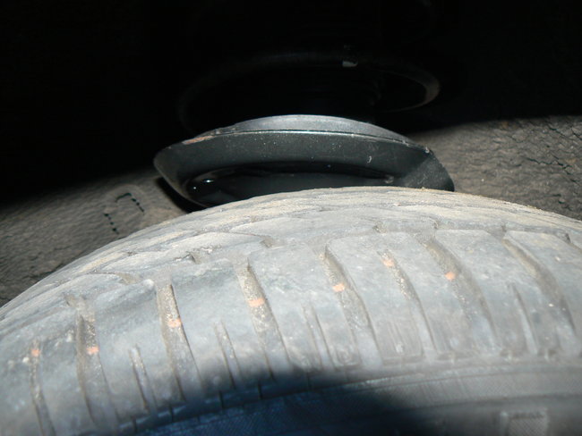

Are you certain the strut assembly is correct for your vehicle? Other than comparing them, I'm not sure how to tell. Also, there is a guide pin on the thrust plate (top of the strut). Are you certain that isn't misplaced and causing the strut to sit off. See pictures 1 and 2.

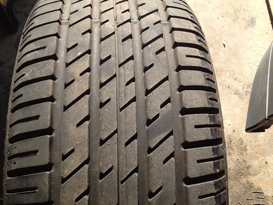

Also, take a look at picture 3 and let me know where it is hitting. I realize you have a good handle on this. However, and I hate to ask, but did you do anything with adjusting camber? The wheel isn't on a tilt at all, correct?

First of all, I do not have the thick collar 'A' on the car. I just have the inverted top hat at the top of the strut attaching the strut to the body.
On both sides there was no guide pin present and I don't even remember seeing any when I took both original struts off though the holes are there for them.

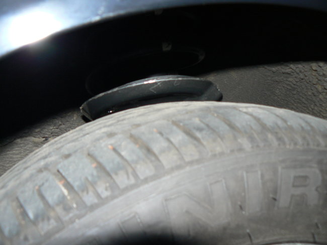

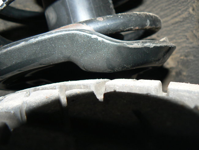

I took some pictures when in the garage just now and did find something odd as well as showing you where the tire is hitting.

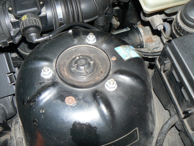

a) The first two on the left are both sides of the strut tops inside the engine compartment. No guide pin but holes are present.

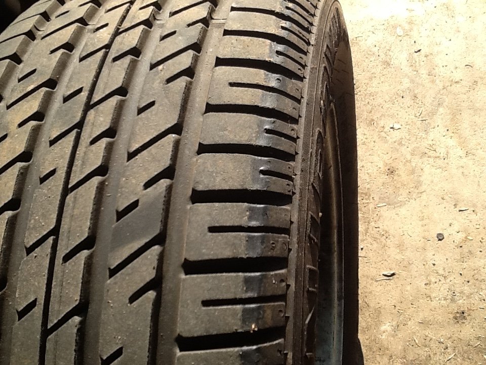

b) The next two shows the strut on the right. You can see that the angle and curvature of the 'saucer' at the bottom follows the curve of the tire. The second picture shows the clearance between the 'cup' where the spring sits and the tire.

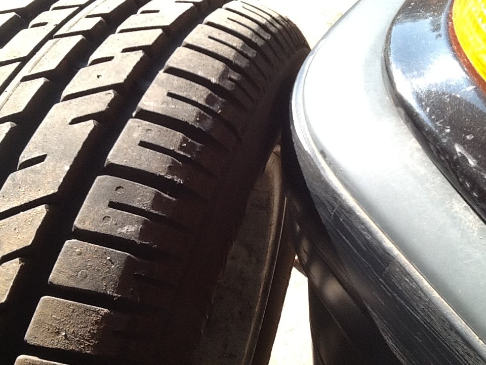

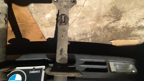

c) The next two (5 & 6) show the problem strut on the left. The first of the two shows that the angle of the 'saucer' is now going upwards against the curvature of the tire. And the second one shows the 'cup' digging into the tire.
The conclusion I seem to be coming to is that I have been sold two right hand struts, as I can't see how the strut can be maneuvered to change the angle. You can see that the angle of the vertical plane of the strut is all wrong, as it needs to move further forward (to the left) which will cause the 'cup' to dig in more.

I just had a look in the Bentley manual and there is nothing in there about guide pins.

I think you nailed it. I just looked up the parts and they are different based on side. I think you got two for the right side. I agree with positioning. I can't see how you could even make it work. Interesting about the guide pins. My manual shows them.

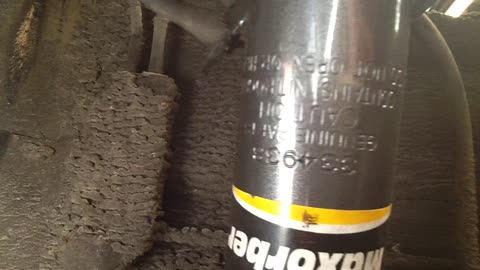

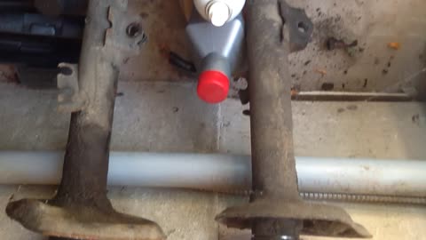

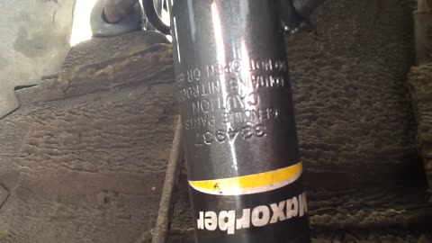

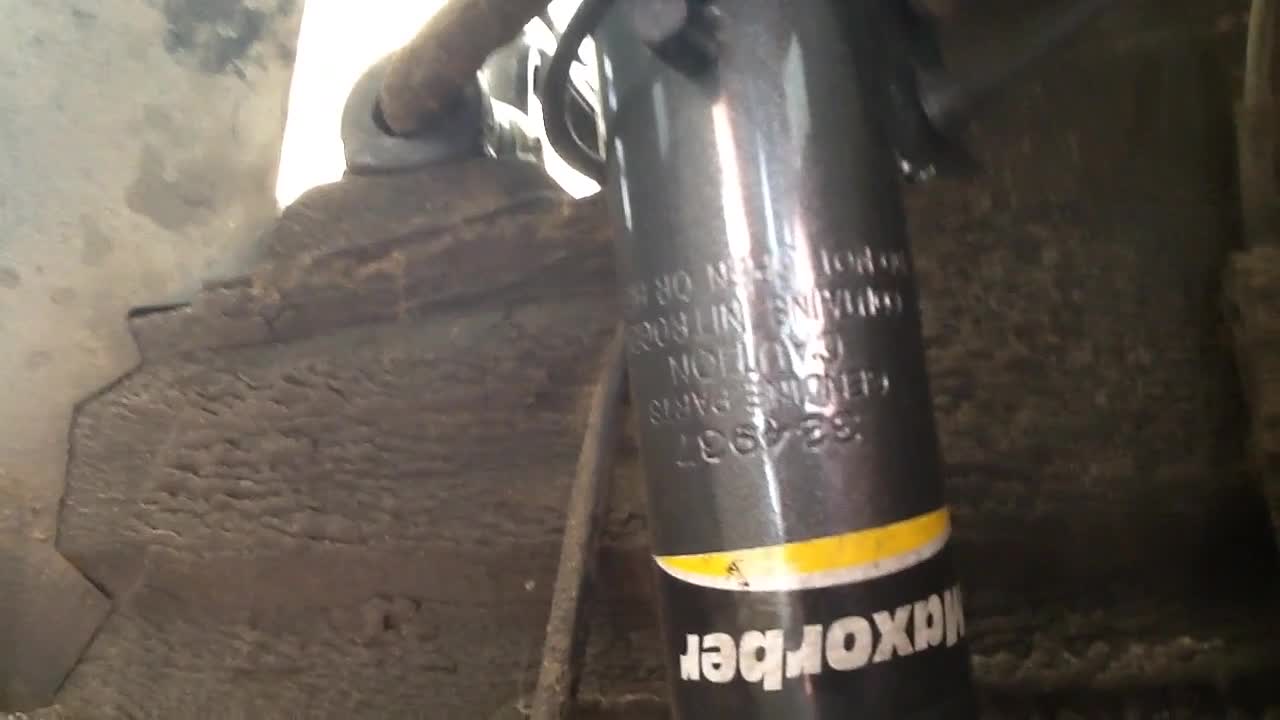

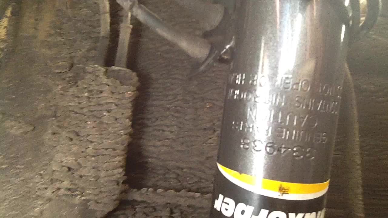

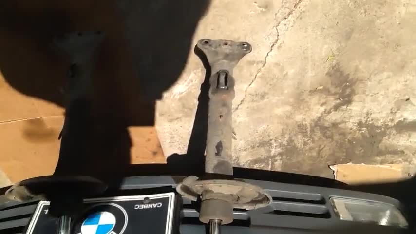

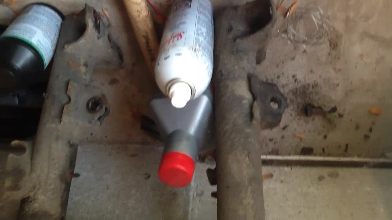

Here are some more images and videos. Not sure how many I can post but I will try and put them all up to give a thorough picture of what is happening. I also have the differences between the old struts.
The first two videos prove that the have different SKU numbers on them. The next two show the differences between the old ones - right and left.
On the new left strut, the part that the end of the spring fits in (the 'bump' in the strut base spring receiver) is too far forward as can be seen in the 3rd and 4th videos below when looking at the old ones.
Images show the wear on the affected tire. The right corner of the tire is where the damage is.
- When uploading, the videos seem to have been inverted. -

Absolutely, they sent you the wrong part. Let me know when they contact you. I'm interested in what they have to say. Also, the only other thing I can think of that may have caused an issue is if they sent you struts for an X drive. As you know, my information is somewhat limited on this vehicle. However, I do know that there are differences between the i and the xi suspensions. The xi version may have a different offset on the wheel.
