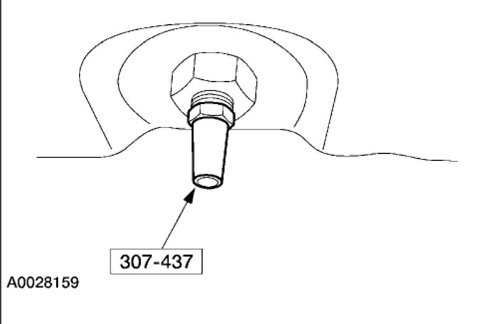

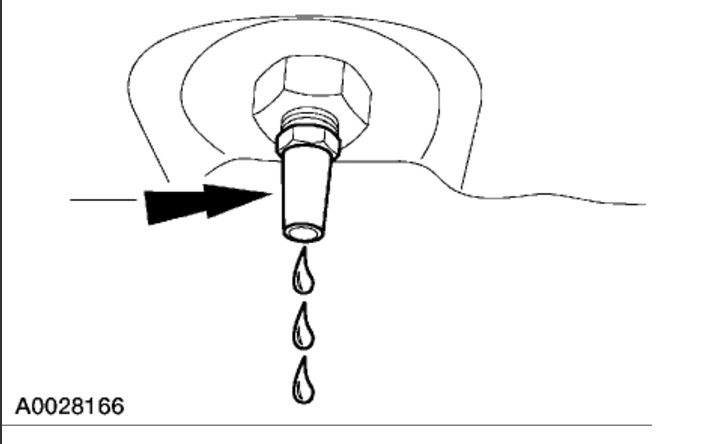

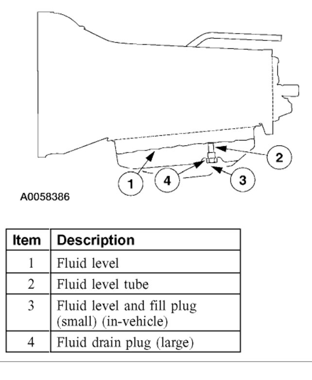

There is a fill plug for the trans. The drain plug has a small plug in the center. Remove the small plug only and fluid should seep out. If not add as needed till it seeps out. Then see if it goes into gear.

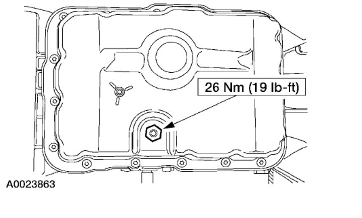

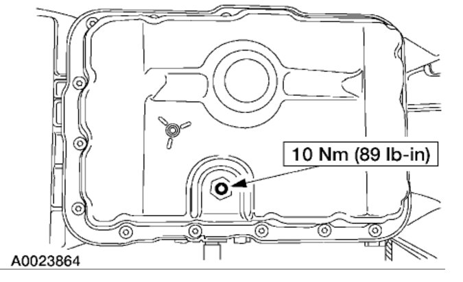

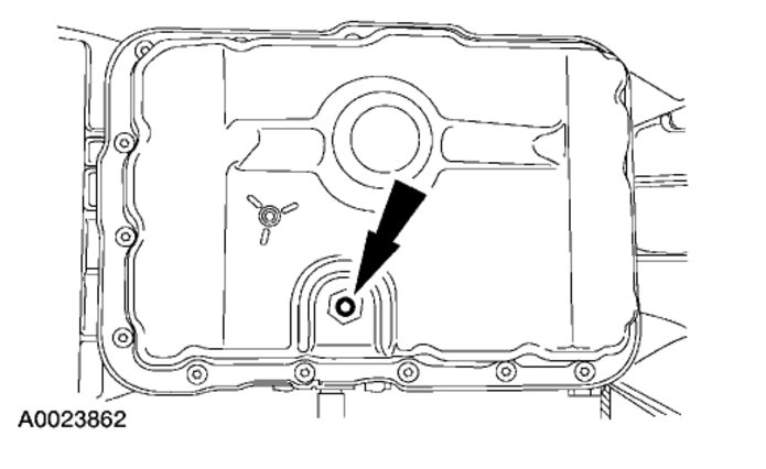

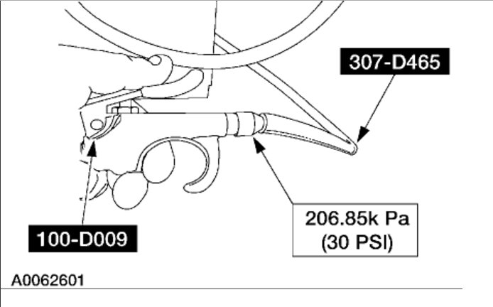

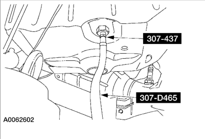

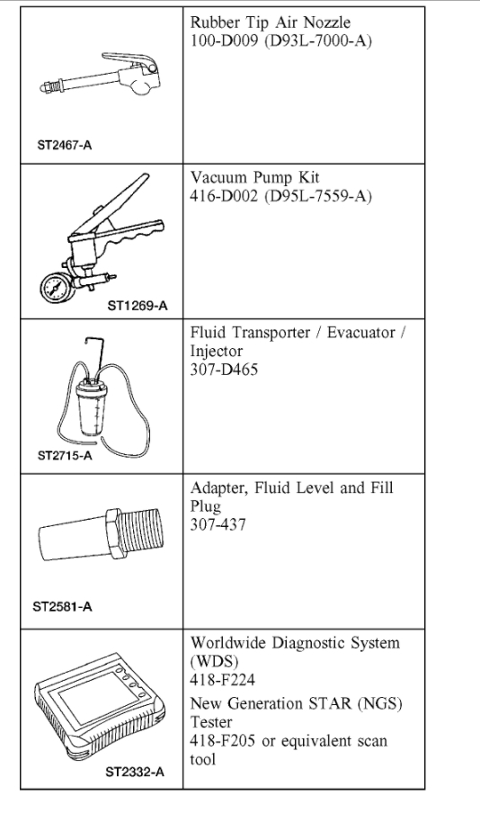

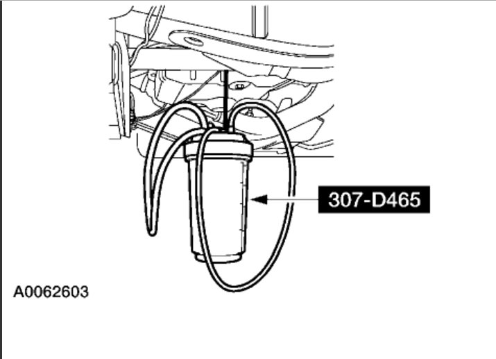

The transmission does not have a dip stick here are diagrams to show you how to check and add fluid.

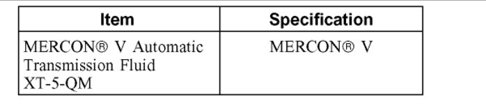

Your 2004 Explorer does NOT have a conventional transmission fluid dipstick to check level with. It uses what's called a two stage drain/fill plug. If you remove the entire plug, you end up draining the pan. So, to remove the fill plug, use a 7/8" backup wrench holding the drain plug, while loesening to Torx TX-30 inner plug. Use ONLY Ford Mercon V fluid.

You are correct; they don't have a stick. You check the fluid from the bottom of the trans pan. First you let the engine run until the fluid gets to operating temp. Next, on a flat surface from under the car using a T30 torx, remove the plug in the bottom of the pan while the car is running. The fluid should only drip as the car runs. Remember that the plug is a torx. If you remove the whole plug, you will drain all the fluid.

There is no dipstick for he transmission fluid! Ford made it difficult for the fluid to be changed and checked because it is only needed once or twice in the car's lifetime.
Here are diagram to help you see how to check the fluid which is basically fill it up until to pours out like a manual trans.
Cheers
