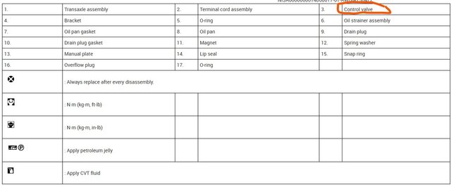

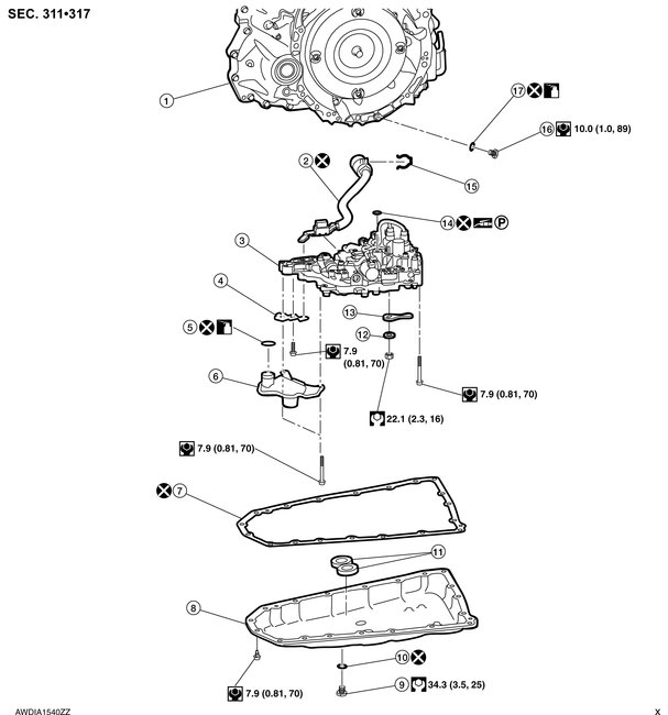

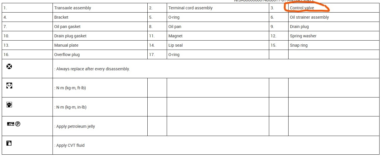

How do I replace the pressure control solenoid b?
2018 NISSAN MURANO
100,000 MILES • V6 • 2WD • AUTOMATIC
BRAD BOYD
Pressure control solenoid.
Nov 23, 2024 at 6:41 PM
STEVE W.
  • 15,172 POSTS
On that CVT transmission the solenoids are an integral part of the valve body and are replaced with the entire assembly. However, that replacement isn't as simple as it sounds because of it being a CVT. You must have a dealer level scan tool and access to Nissans factory programming network before you start. Then you need to have a new valve body
with its configuration data as the replacement part, a used one won't work unless you can access the vehicle it is being removed from and can copy the configuration data from it as a working unit. This is because the data on each solenoid is slightly different and the TCM gets programmed with that data. The mechanical part is simple. Drain the pan of fluid, remove the pan and disconnect and remove the valve body and its harness, clean the surfaces and install the new part with a new filter and harness and follow the torque specs as shown. Refill the CVT with the correct fluid. The hard part is getting the new part and the programming. The part number is Nissan 3170529X0C. The new ones come with a memory stick or a CD with the data used during programming so that the TCM you have can control the solenoids. That data is as important as it being a new part because of the way the CVT wears and operates. You also want to look at the fluid as it comes out. If there is any metal in it it is best to replace the entire CVT.
