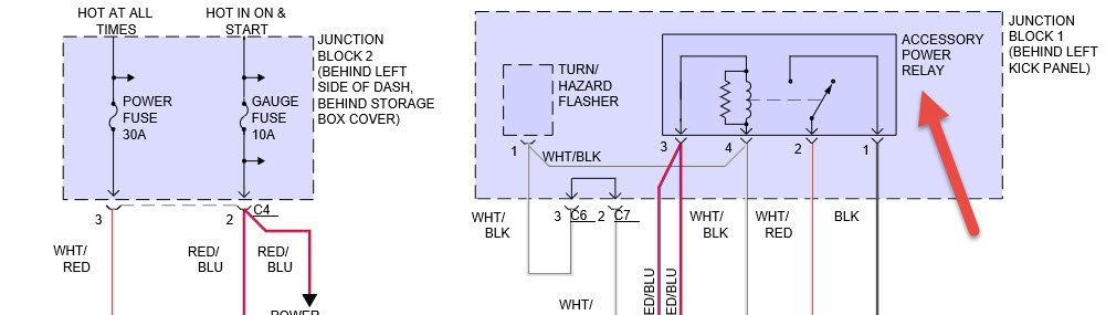

Hello and thanks in advance. my power windows stop working, at first it was the driver side window now all will not work. I replaced master switch still nothing. i suspect relay but cannot locate it.

check fuses and relay in pic otherwise have a mechanic scan for codes may be a bad modules/s
