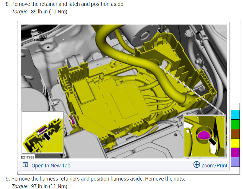

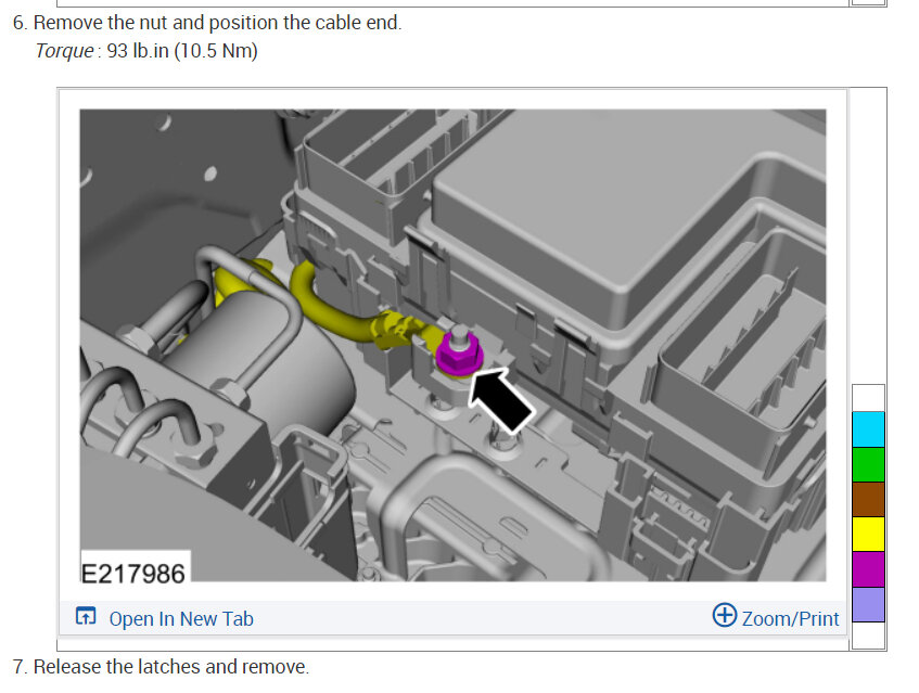

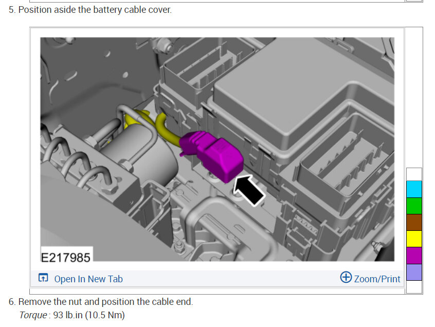

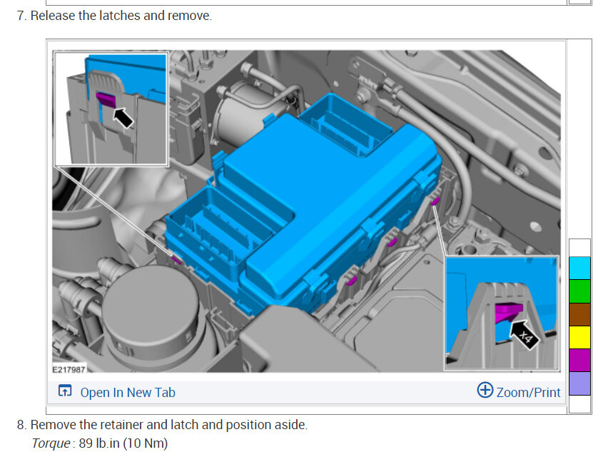

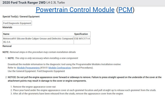

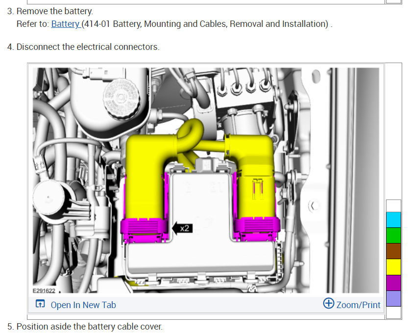

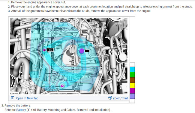

Where is the Powertrain control module located?
2020 FORD RANGER
15,000 MILES • 2.2L • TURBO • 2WD • AUTOMATIC
EFLA MACABINTA
Powertrain control module location?
Dec 12, 2023 at 1:20 AM
  • 54,503 POSTS

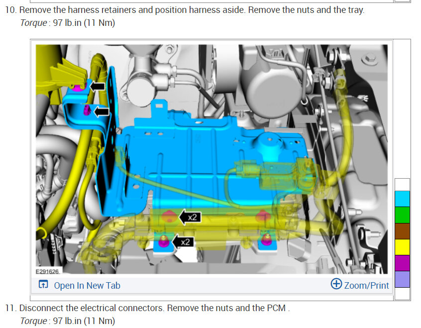

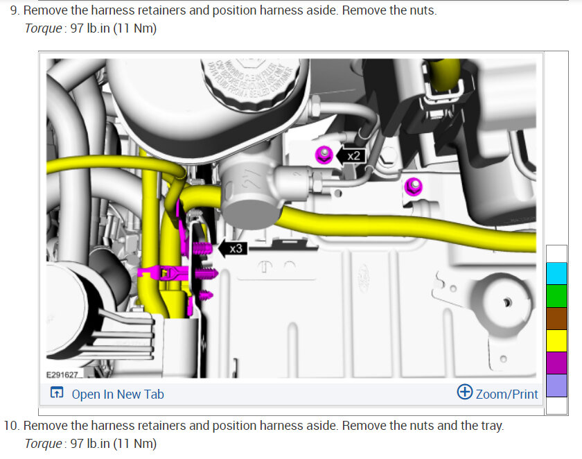

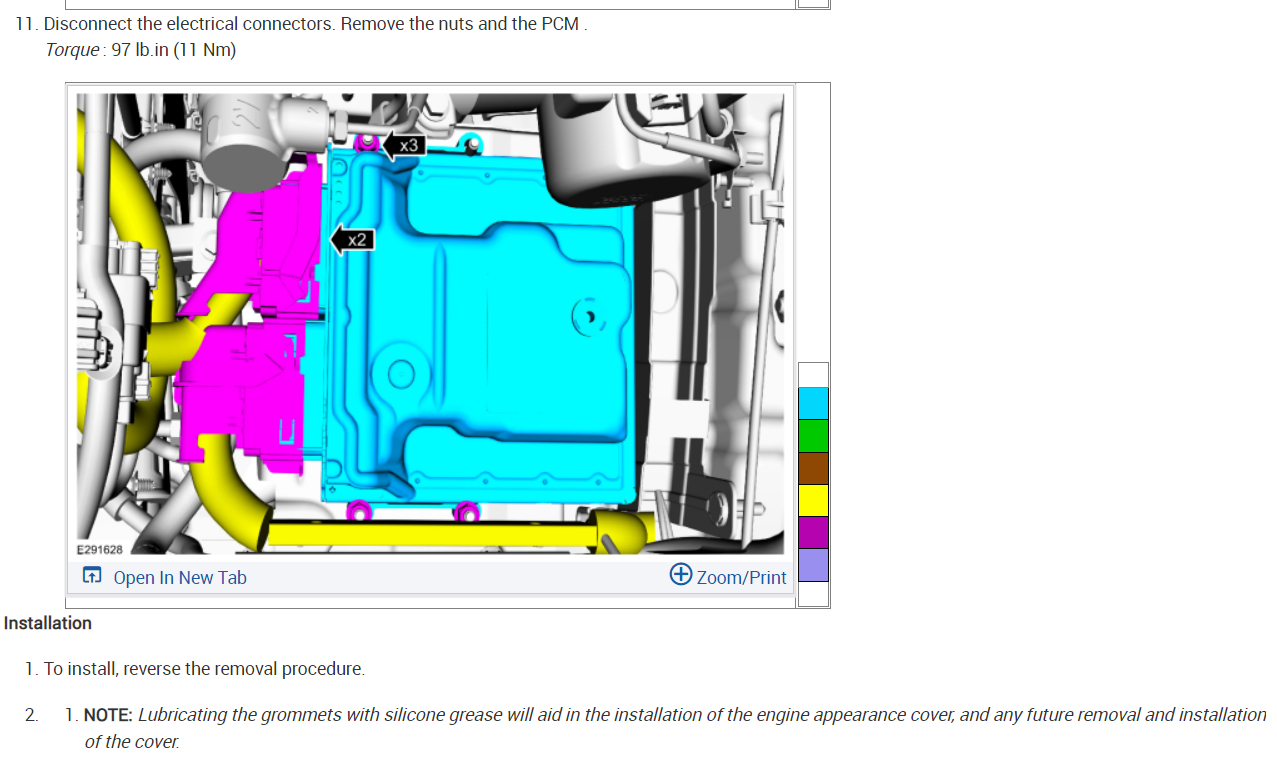

It looks like the engine control module is located in front of the brake master cylinder and the ABS control module/pump. Here is the location and how to change it out. Check out the images (below). Let us know if you need anything else.
