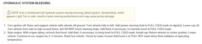

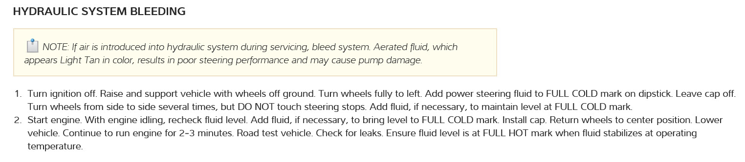

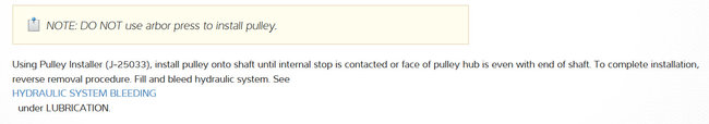

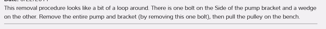

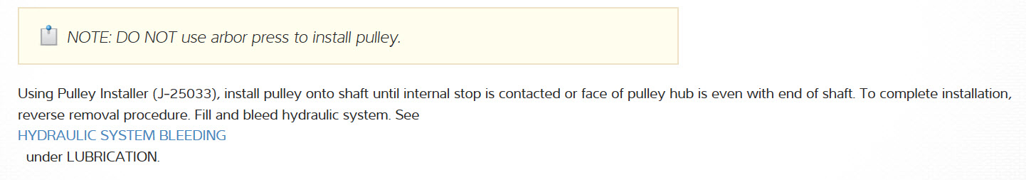

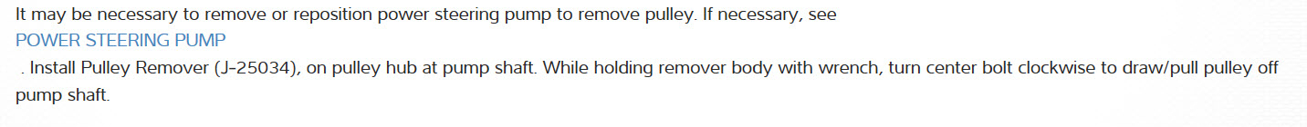

Pulley broke in the center
Friday, March 31st, 2017 AT 7:30 PM
HMAC300
MECHANIC
48,601 POSTS
You will need a puller for pulley and installer which auto parts rent. See pics for instructions and pay attention to all of them to make it easier to do.
