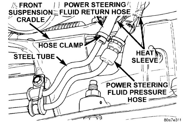

How do you remove the power steering pump in this vehicle? It looks to me like you have to take an axle out. What is the easiest procedure to get the pump out?

Looks like they want you to take down the catalytic converter to do this job. The labor time calls for 2.5 hours, but with the age of the vehicle (if the exhaust is original), and the unreliability of exhaust parts, I fear the bolts on the catalytic converter will be a pain. Be sure to soak the bolts with PB Blaster or WD-40 overnight before going this route. If you think pulling the axle will be the way to go, I will be more than happy to provide you with the axle procedures. Please see the OEM repair procedures below:
REMOVAL
1. Remove the (-) negative battery cable from the battery and isolate cable.
2. Remove cap from power steering fluid reservoir.
3. Using a siphon pump, remove as much power steering fluid as possible from the power steering fluid reservoir.
4. Raise vehicle on jack stands or centered on a frame contact type hoist.
5. Disconnect the oxygen sensor wiring harness from the vehicle wiring harness. Access to connection at vehicle wiring harness is through the oxygen sensor wiring harness grommet in the floor pan of the vehicle.

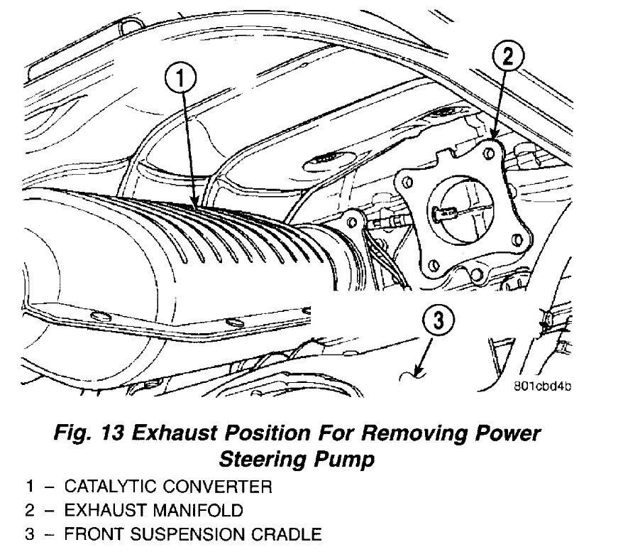

NOTE: The exhaust system needs to be removed from the engine to allow for an area to remove the power steering pump from the vehicle.
6. Remove the catalytic converter from the exhaust manifold. Then remove all the exhaust system hangers/isolators from the brackets on the exhaust system.
(See image 1).
7. Move the exhaust system as far rearward and to the left side of the vehicle as possible.

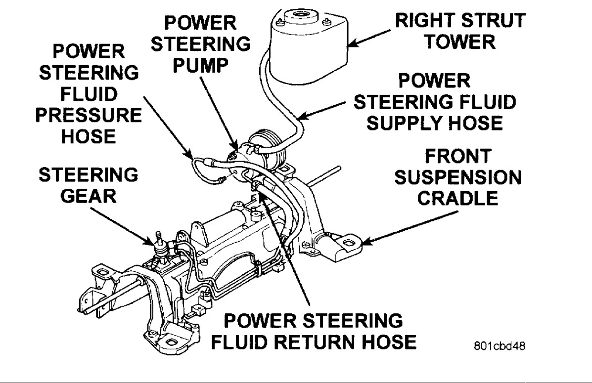

8. Raise the heat sleeve on the power steering hoses to expose the hose to steel tube connection. Remove the hose from the power steering fluid return line on the front suspension cradle. Allow the remaining power steering fluid to drain from the pump and fluid reservoir through the removed return hose.
(See image 2).

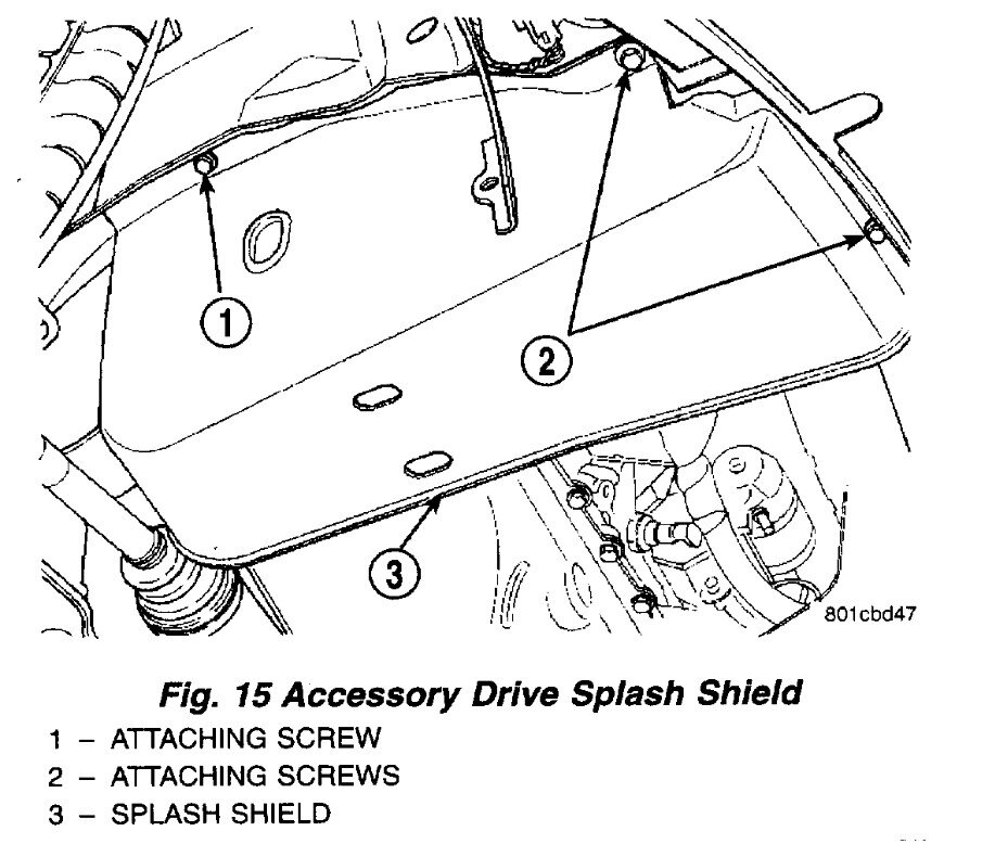

9. Remove the accessory drive splash shield.
(See image 3).

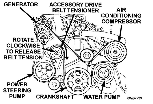

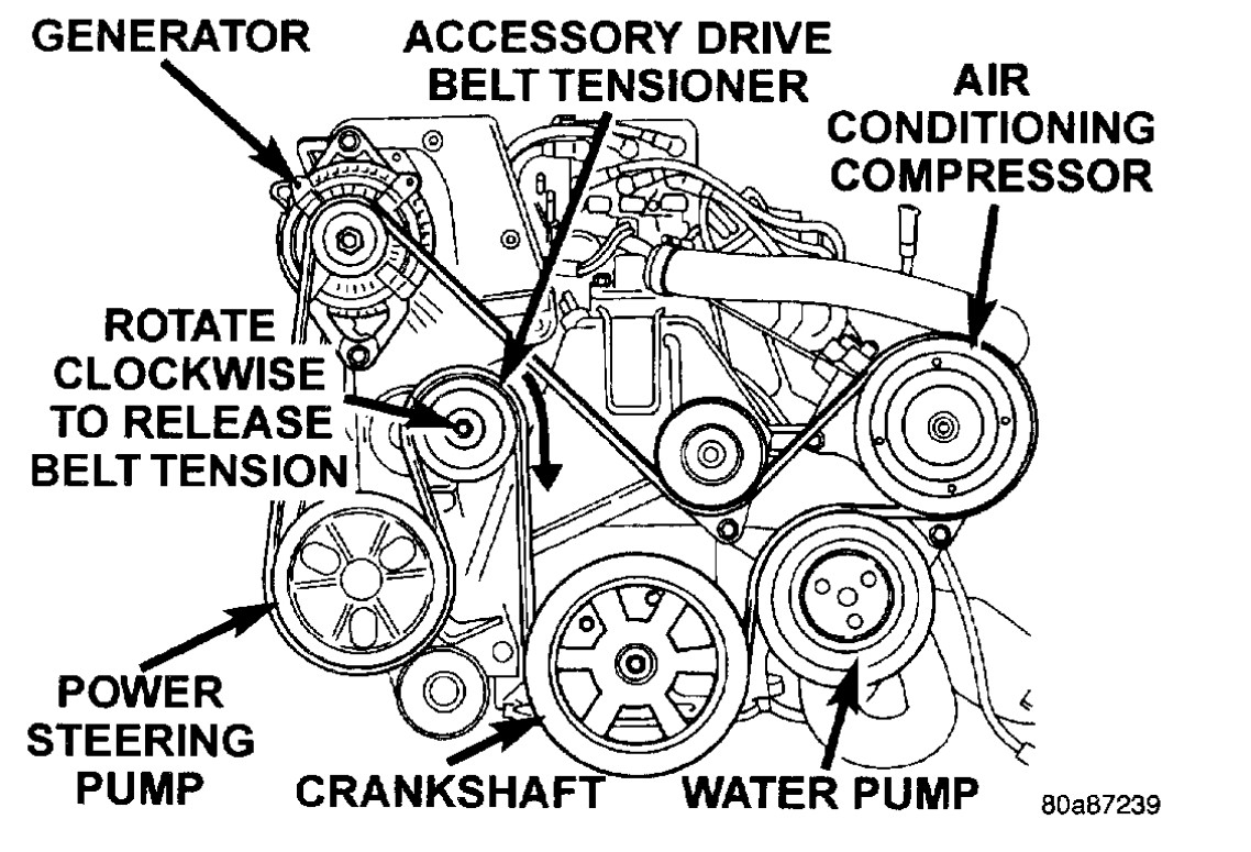

10. Remove the serpentine accessory drive belt from the engine.
(See image 4).
11. Remove the power steering fluid supply hose coming from the remote fluid reservoir, from the fitting on the power steering pump. Drain off excess power steering fluid from hose.
(See image 5).
12. Remove the power steering fluid pressure line from the power steering pump. Drain excess power steering fluid from tube.
13. Remove the power steering fluid return hose from the power steering pump. Drain excess power steering fluid from tube.

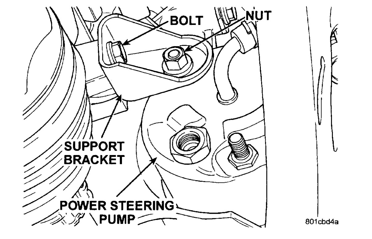

14. Remove the support bracket at the rear of the power steering pump attaching the pump to the rear of the engine.
(See image 6).

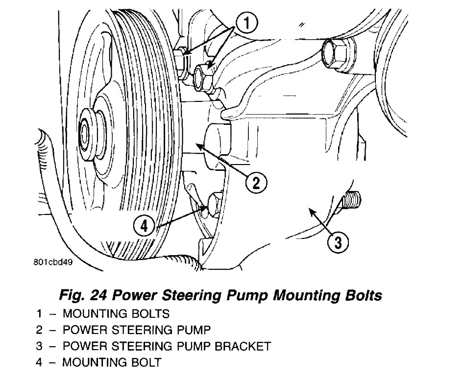

15. Remove the 3 bolts mounting the power steering pump to the alternator/power steering pump and belt tensioner mounting bracket.
(See image 7).
16. Remove the power steering pump from its mounting bracket.

Ouch, what a stupid design. I'll have to look at it again. I only briefly assessed the situation.
Sep 18, 2023 at 7:54 PM
JEFF HERMAN
  • 486 POSTS
I'll consider cutting an access hole in the floor pan if the area is accessible.
Sep 18, 2023 at 8:00 PM
CANNON1349
  • 861 POSTS
I don't recommend cutting a hole in the floor, it will rust quickly if not already and become a safety issue. The trouble would be equal if not greater than taking down the converter. There should be 4 bolts on the converter mounting it to the manifold. Soak them overnight with penetrating oil and the rest is up to elbow grease. Nevertheless, whatever you decide to do just let us know, and send pictures! Thanks again!
William
Sep 18, 2023 at 8:05 PM
JEFF HERMAN
  • 486 POSTS
I'll decide when I get a better look at it. My only concern is that those four bolts break, but I'll know more tomorrow. Thanks for the help.
Sep 18, 2023 at 8:33 PM
CANNON1349
  • 861 POSTS
You're welcome, thanks for using 2CarPros!
William
Sep 19, 2023 at 4:16 AM
JEFF HERMAN
  • 486 POSTS
I was able to get the pump out without touching the exhaust. I removed a sort of skid plate that's really nonfunctional. I pulled the right axle, and I had plenty of room to bring the pump out. It leaks out the front seal which is easy to replace but I'm at a loss as to how to disassemble the pump to replace the o rings inside. For just a few dollars more I can get a remanufactured pump so I'm sort of torn because I like to rebuild versus replace. Have you ever rebuilt a power steering pump?
