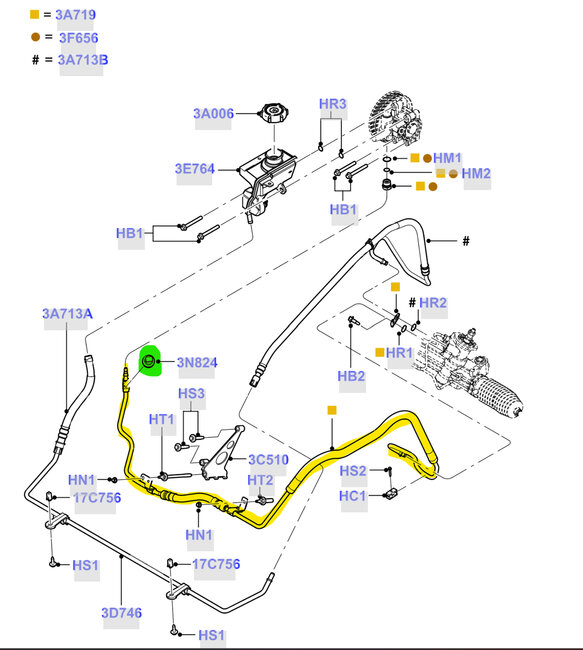

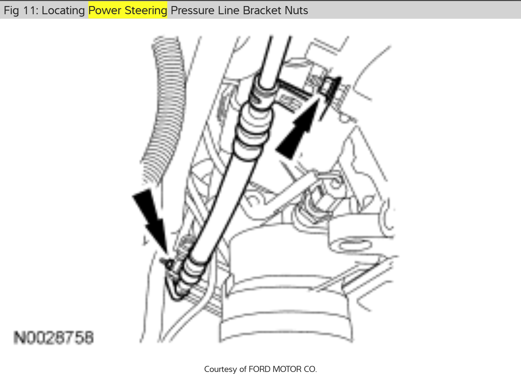

I got a leak and after using leak detector it's coming from above the engine oil filter. Any idea whether it's a hard line, rubber hose or where the rubber goes into a hard line?
May 25, 2023 at 9:59 PM
BRENDON S
  • 653 POSTS
Hello ROBERT, CLARK2,

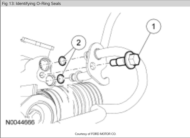

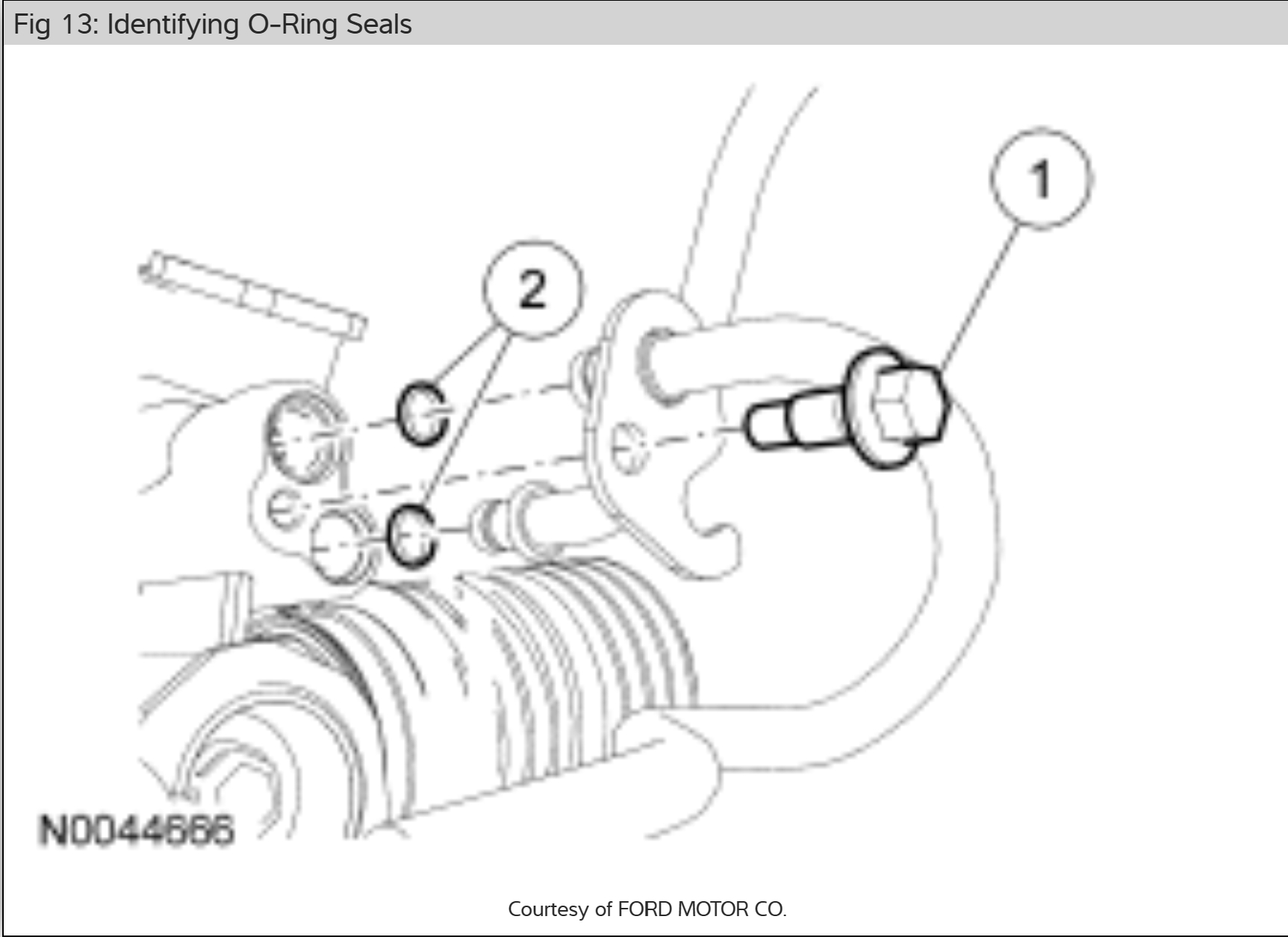

It looks like the pressure line for the power steering runs right in that area. It is a combination of a metal line and flexible hose. It runs from the pump straight to the rack.
I will add a diagram for you.
I found a part number from Motorcraft, Fords value line, which comes with all the seals you will need as well.
Part number: 7S4Z3A719B
You can go to the dealer for it, or Rock Auto may have it as well.
In case you need it, the fluid is just Motorcraft Mercon V.

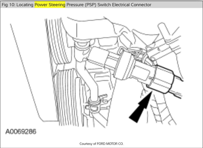

The pressure switch may not come with it (marked in green). If it doesn't you will need new O-rings for that.

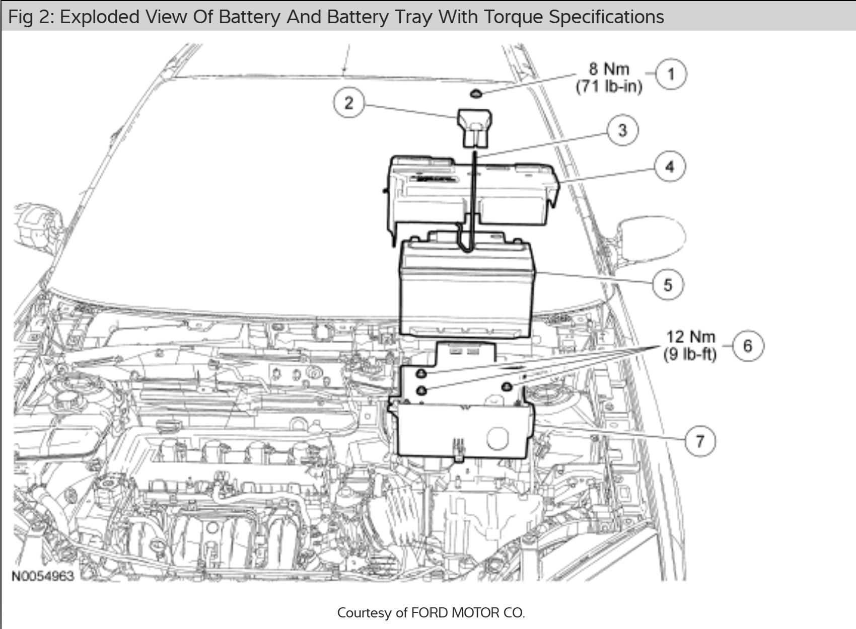

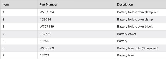

Removing the battery and battery tray will help give you some room.

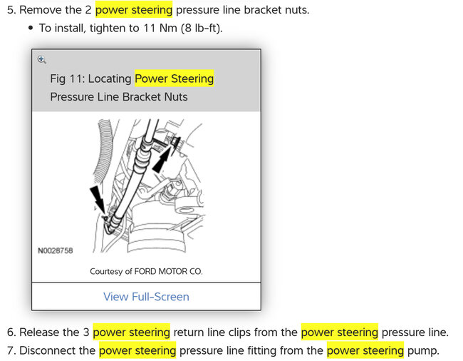

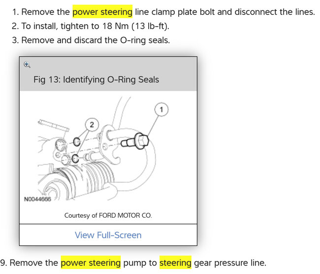

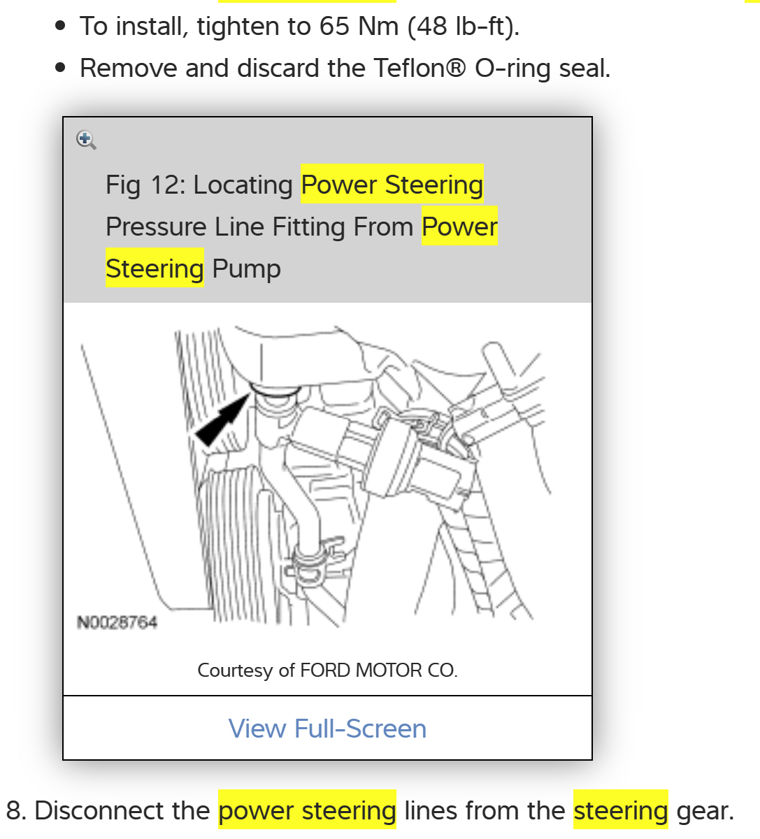

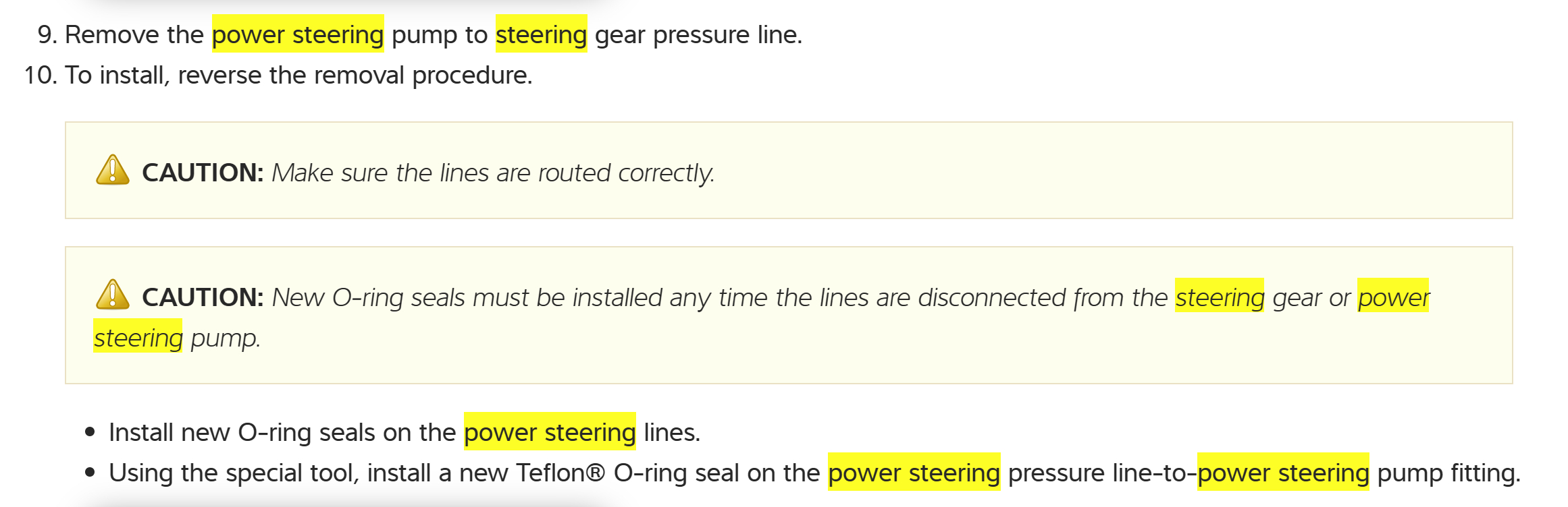

I will add some instructions on how to replace the pressure line and removal of the battery tray from my information.

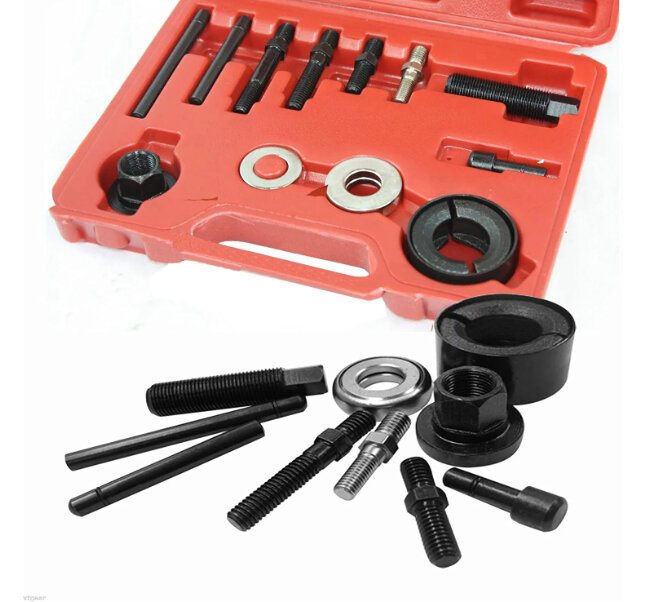

The instructions have you remove the power steering pump pulley, but I would look and see if you can get a wrench on it without removing it to save to some time. If you need to remove it a 2-jaw puller might work but I would use a power steering pump pulley puller, say that ten times fast lol. You can rent one at an auto parts store.
I would use a little bit of new power steering fluid on each O-ring to avoid them tearing and help them slide in.

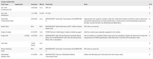

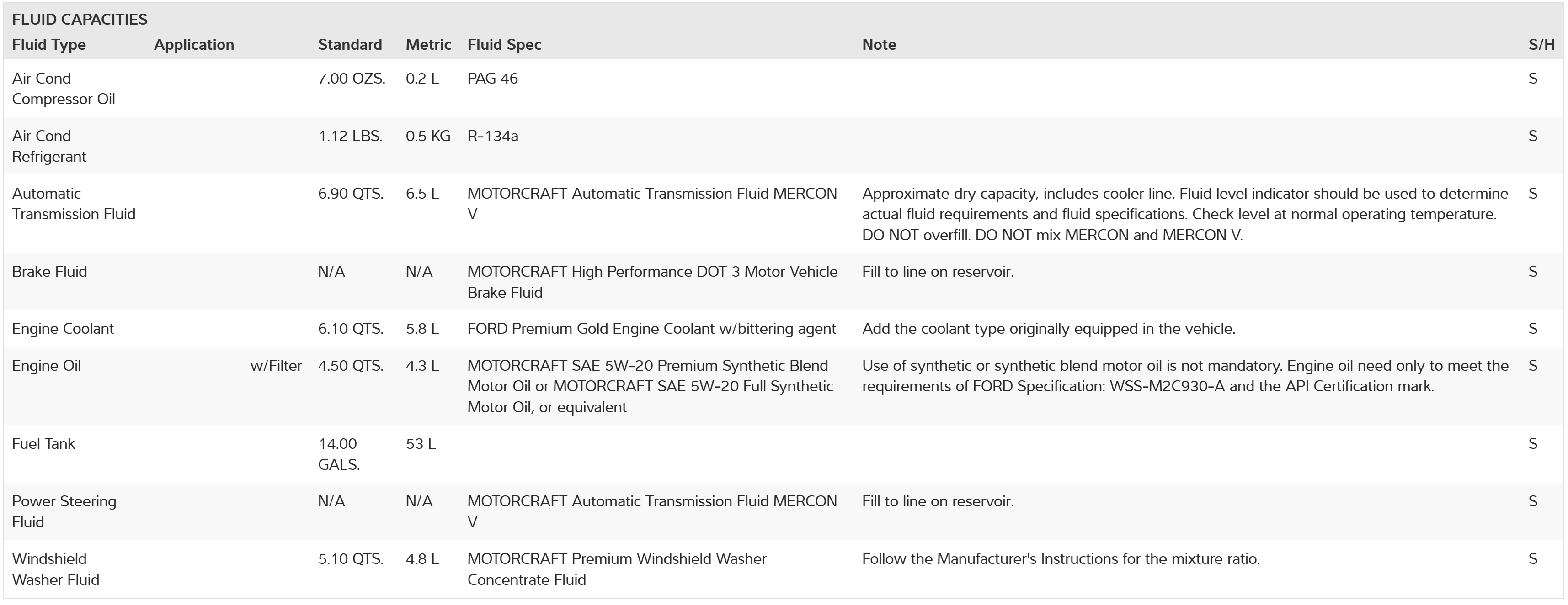

You said Mercon v .. isn't that trai fluid? Like I heard you can use it if there's no power steering fluid but shouldn't power steering fluid go in first and foremost?
May 26, 2023 at 2:39 PM
BRENDON S
  • 653 POSTS
Hello ROBERT CLARK2,
Some take power steering fluid others just use transmission fluid for power steering. In my opinion you should always put in what the manufacturer recommends when changing fluids. Dexron, Mercon, ATF+4, Type F and others are used by manufacturers as power steering fluid.
Sometimes a system can also take one or the other. But the 2 should never be mixed.
I added the fluid chart for you from my reference manual.

Do you mean at the pump? If so, yes that will help but if you still don't have enough room, you might have to remove the pulley. You're going to bleed the whole system anyways so if it's in the way, I would take it off. You may need to remove it from the rack anyway to get the other line out.
Here is a video on how to use a power steering pump pulley puller and one can be rented at your local auto parts store: https://youtu.be/K8zHpXcI8_o

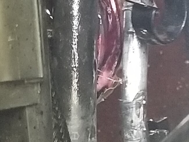

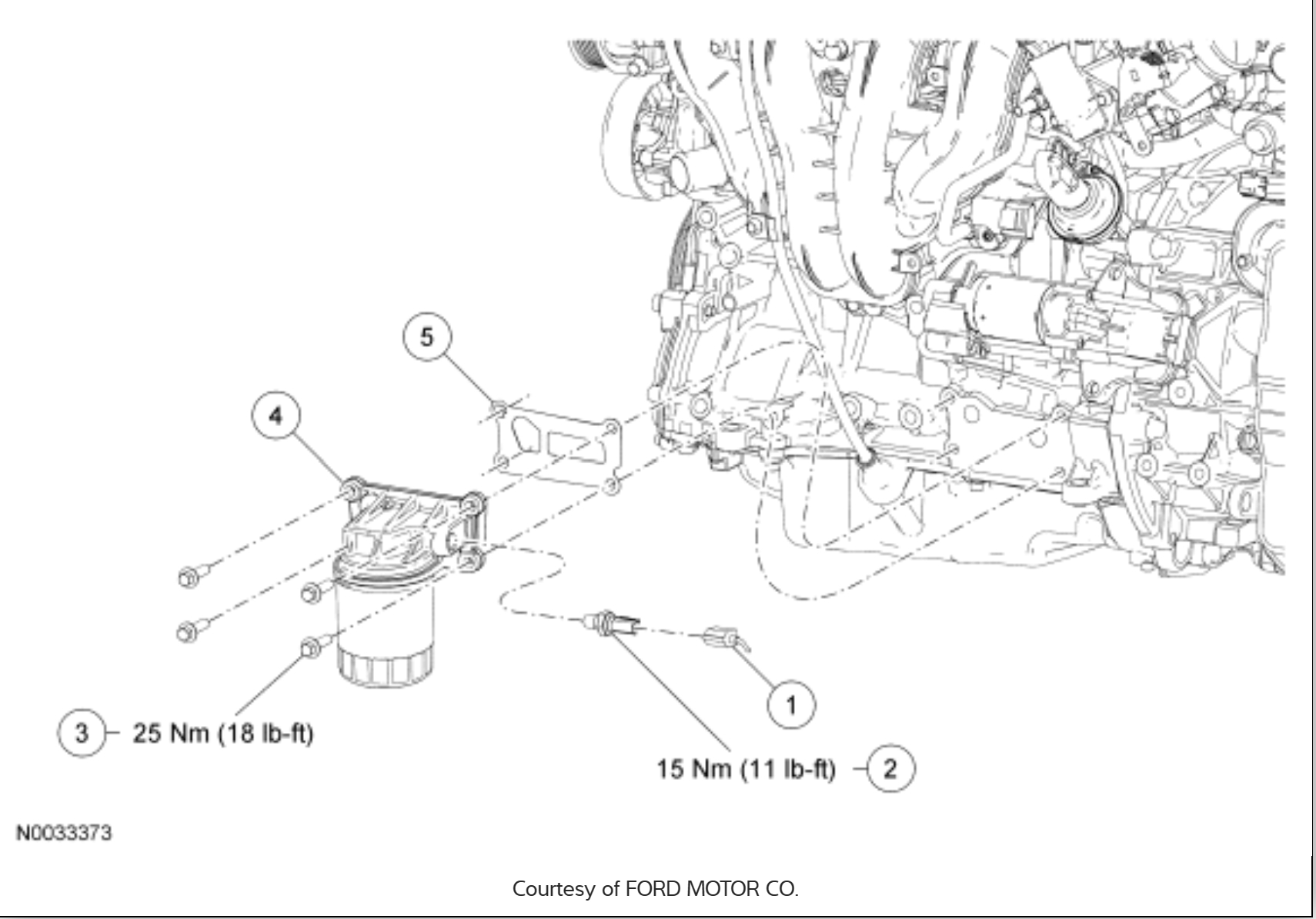

Well, good news and bad. Good news. The part was cheap and now I got a new line that may have given me a prob. Bad news that's not the leak. In the first pic of the thread labeled 4. What is that. Is seems to be leaking from that.
Jun 15, 2023 at 12:15 PM
ROBERT CLARK2
  • 21 POSTS
Or its leaking on it if that has nothing to do with it.
Jun 15, 2023 at 12:28 PM
BRENDON S
  • 653 POSTS
Is this the right image? If so, this is the oil filter housing.
Should be right where that line was so it's possible the line leaked onto it because this should be below it.
I would get a few cans of brake clean and clean the entire area extremely well. Then I would let it idle for a bit and see if anything starts to leak. If you don't see anything I would then drive the car a few miles, maybe around town and check it. I would stay off the highway, so it doesn't get blown around and makes it harder to see where it is coming from.
You can add some UV dye to your oil and use a UV light to pinpoint the leak. This is the best way in my opinion. However, it needs to be checked often because if it leaks too much you won't be able to tell where it is coming from.
Your first post you said you used leak detector, that sounds like dye, is that correct? If so, did you only put it in the power steering system?

Found it. Couldn't see it because it was so close with the pressure hose and almost on top of the oil filter. It's a tiny pin hole lol. How much pressure is in that hose. I got some job water weld putty to at least slow it down till I get a new one. Would that work?
Jun 15, 2023 at 2:11 PM
BRENDON S
  • 653 POSTS
Is that the power steering return line?
If so, pressure can be up to 150 psi.
You could try to clean it really well with brake clean to get all the oil off and see if you can get a couple good wraps of duct tape on it maybe. I'm not sure if you have the room though.
I don't think the putty is going to hold it and if it gets into the system, it could cause issues.
