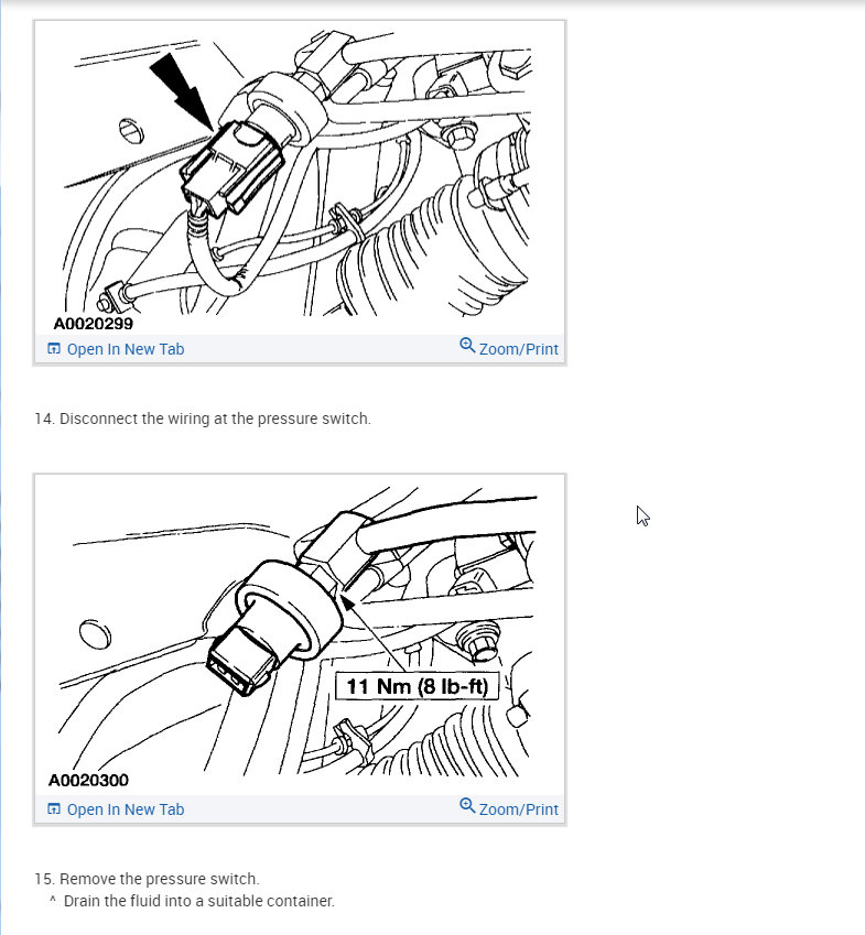

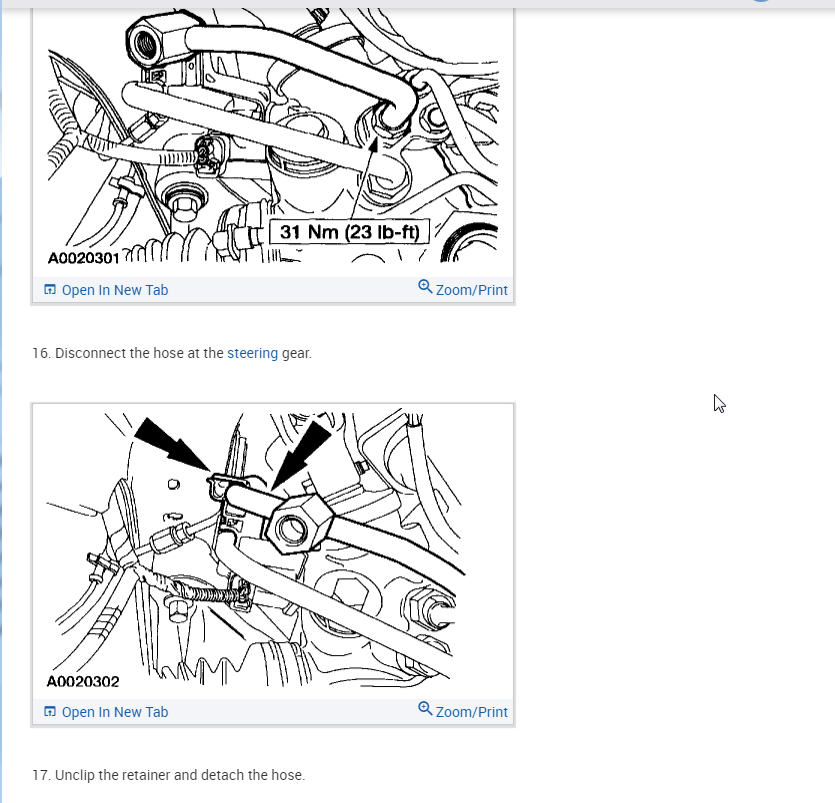

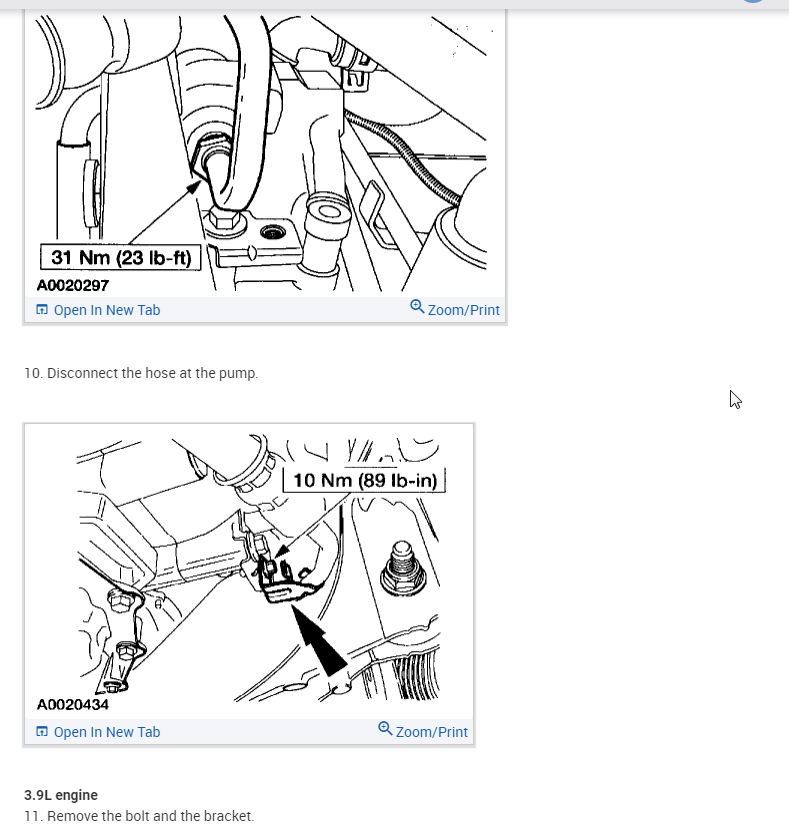

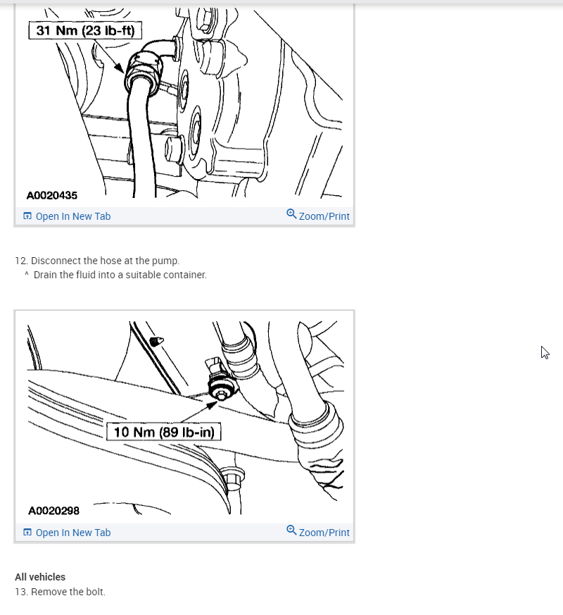

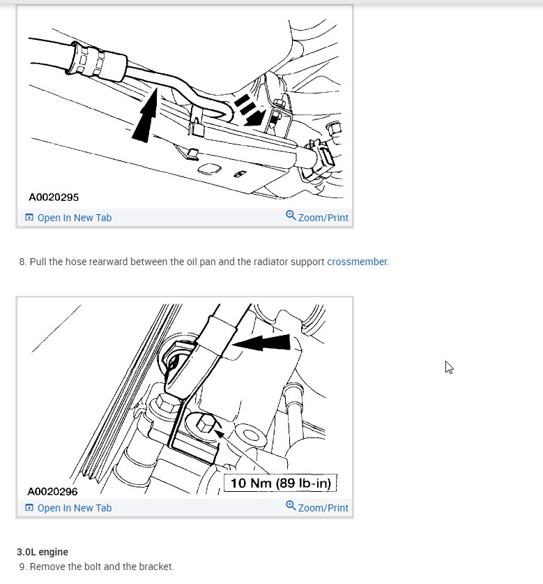

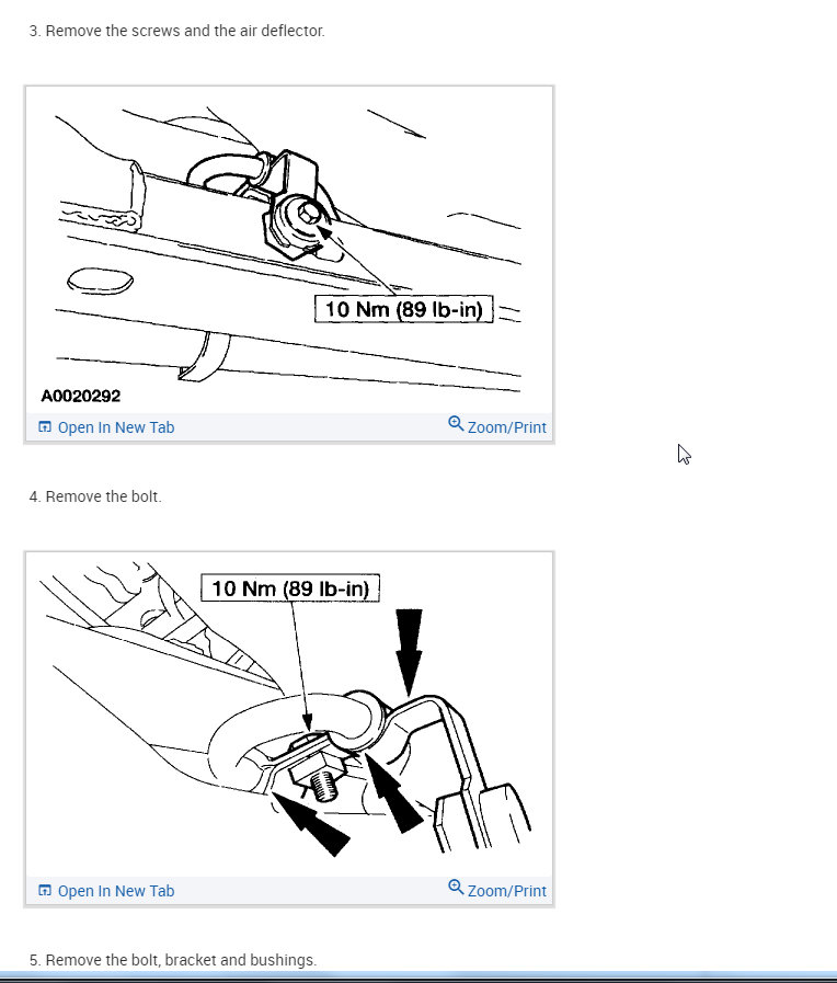

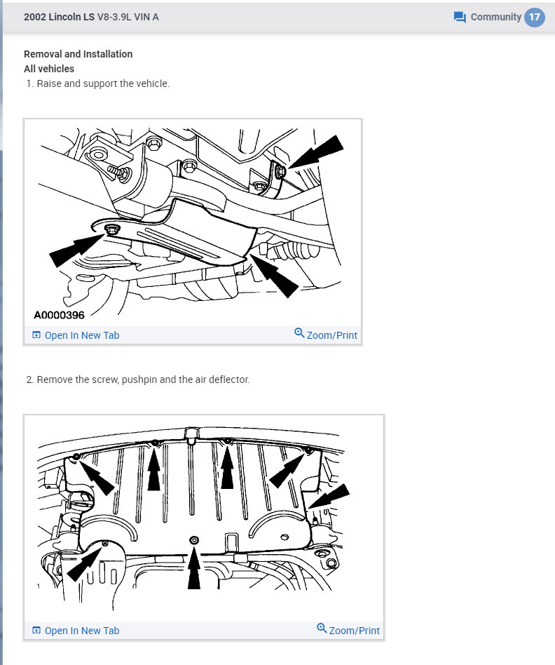

I believe it’s coming out of the pressure line. How would I change that?
Friday, May 15th, 2020 AT 9:31 AM
3 Replies

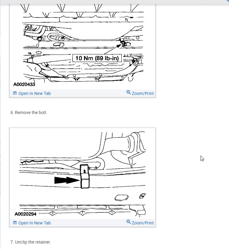

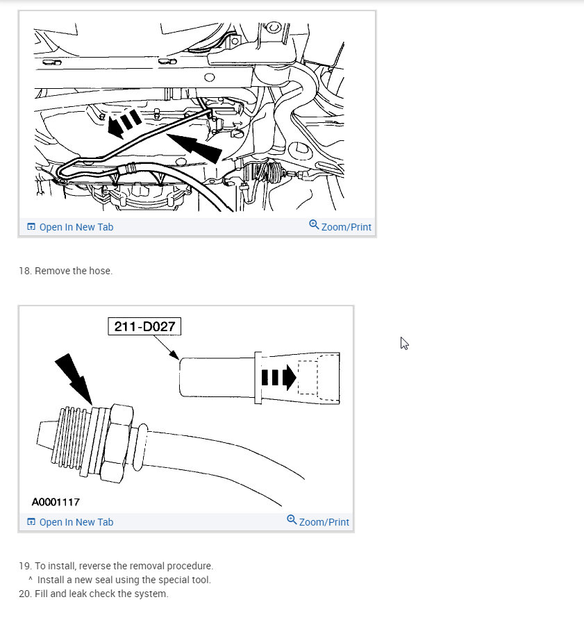

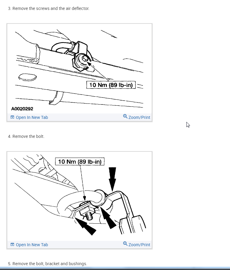

I attached the process on the line from the pump to the gear. This would be considered the pressure line.
Let me know if you need more info. Thanks
