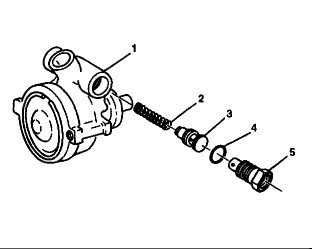

I had a power steering pump go out. Had it replaced and it leaked. I was told to change the power steering lines as they were rusted. I had them changed and the power steering pump got real hot and went out. I had that one changed and it got real hot. We replaced the power steering cooler thinking it was plugged and causing the overheating of the pump and poor return flow. The power steering was working but warm still not sure about proper flow. It also had a noise (air) coming from the rack. Thinking air was trapped and would eventually work out I drove the car home. Next day on the way to work about four miles from the house the high pressure hose blew right before the rack. Can a bad rack cause this? The first pump when out when the wife was turning around a U turn so the wheel was turned all the way. Not sure what to do. Can it be the rack?

Hi and thanks for using 2CarPros.com. This is an interesting problem. Yes, the rack can be plugged causing a build up of pressure. You could try flushing the system. Also, there is a pressure control valve/direction flow valve. There is a chance the problem is coming from there. Here are directions to remove and replace it. I would suggest that you give it a try and check for any obstructions. I realize the pumps are new, but dirt can still enter them.
Remove the O-ring union fitting (5) from the hydraulic pump housing assembly (1).
Remove the O-ring seal (4) from the O-ring union fitting (5).
Remove the control valve assembly (3).
Remove the flow control spring (2).
Assembly Procedure
Install the flow control spring (2) to the hydraulic pump housing assembly (1).
Install the control valve assembly (3).
Lubricate the O-ring seal (4) with power steering fluid.
Install the O-ring seal (4) onto the O-ring union fitting (5).
Notice: Refer to Fastener Notice in Service Precautions.
Install the O-ring union fitting (5) into the hydraulic pump housing assembly (1). Tighten the fitting (5) to 75 Nm (55 ft. lbs.).
The following picture correlate with these directions. (pic 1)

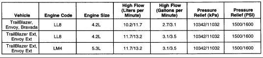

Picture 5 is of the pressure the system should maintain.

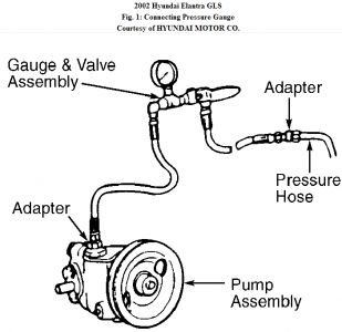

Here are directions for checking the pressure:
With the engine off, install the pressure gauge between the high pressure hose and the pump.
Start the engine and allow it to warm up with the pressure gauge in the open position
Turn the steering several times to circulate the fluid.
Close the valve on the gauge for NO MORE THAN 5 Seconds or overheating and damage will occur.
When in the closed position, document the pressure and compare it to the cart I provided.
The last picture is of the gauge set up.
