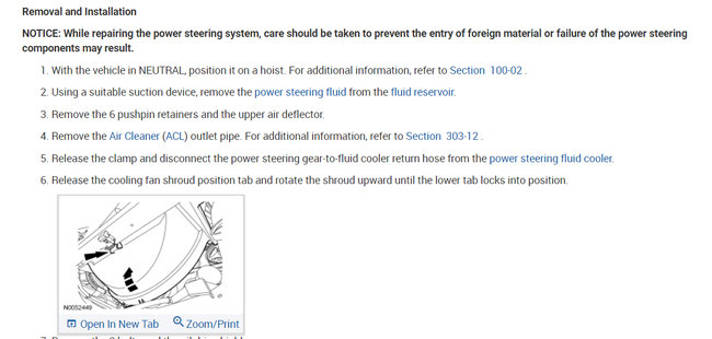

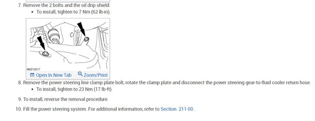

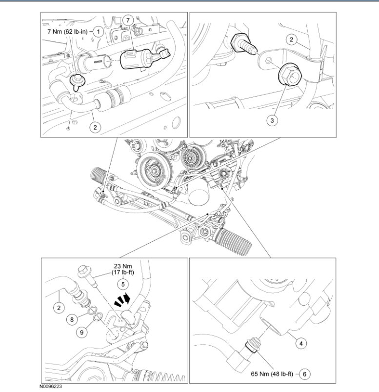

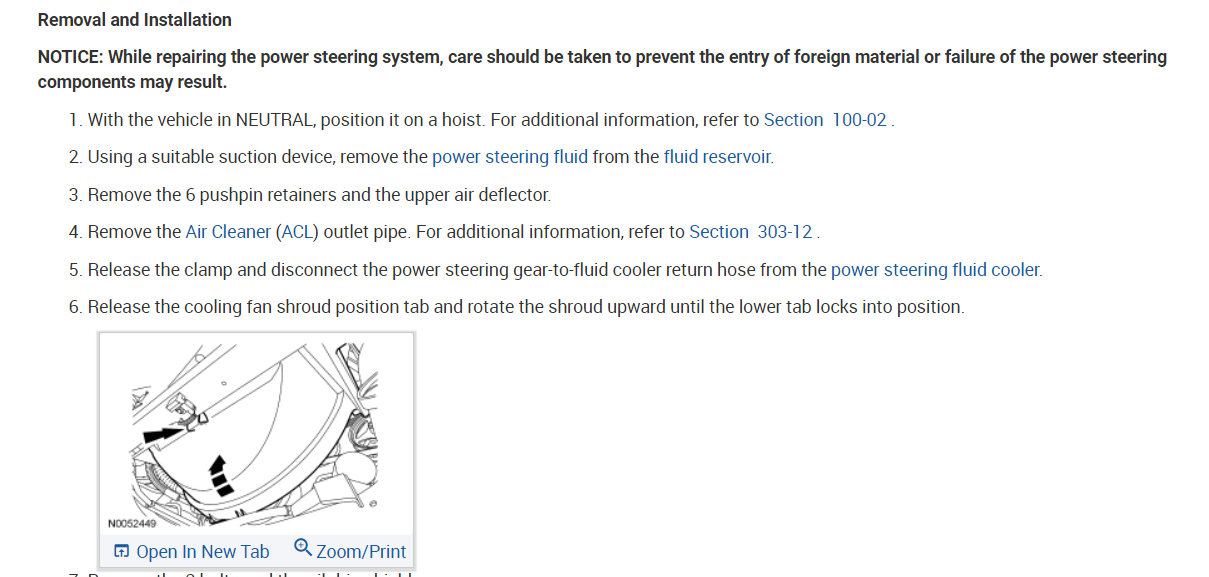

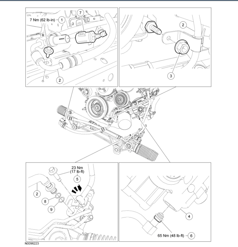

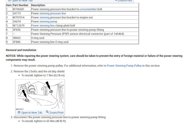

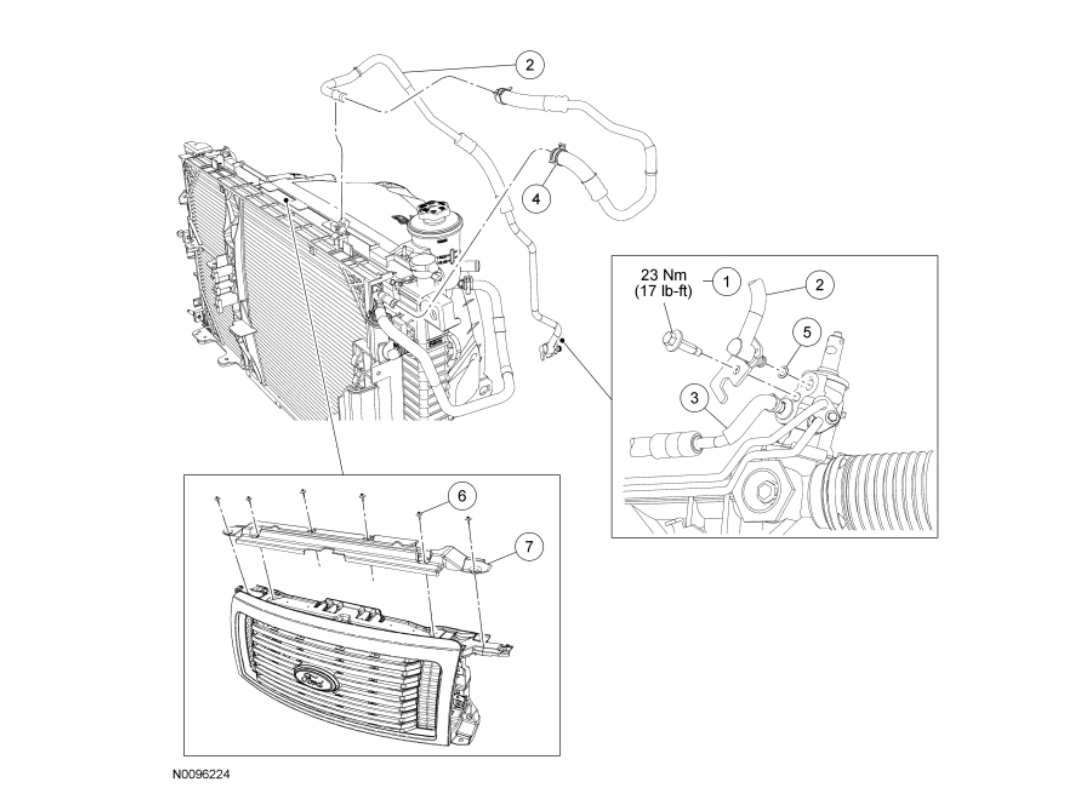

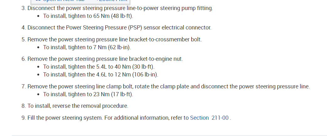

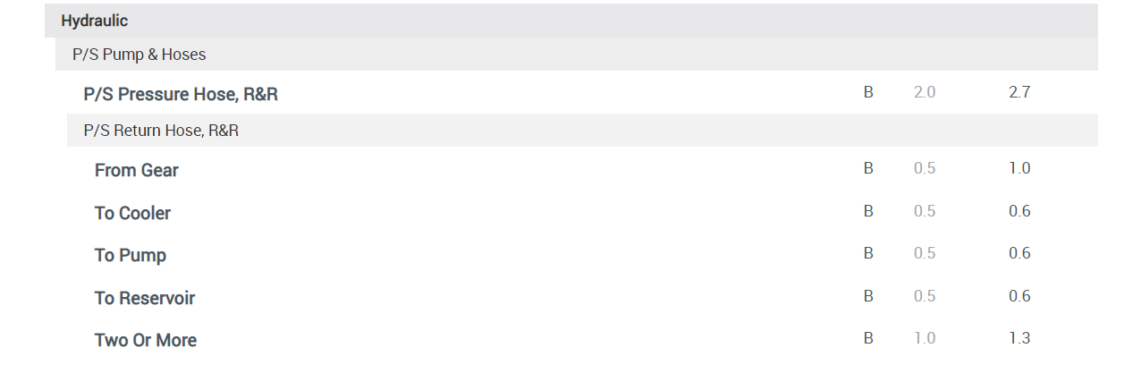

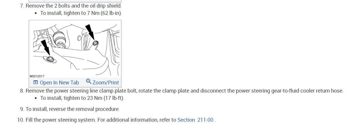

I need to know how long to remove and replace the power steering line. On the truck listed above 4x4.
Friday, February 8th, 2019 AT 7:11 AM
MECHANIC
52,796 POSTS
Good morning,
I attached the procedure for both the pressure and return lines.
I would flush the system of all the old fluid when complete. I attached a guide below for you.
https://www.2carpros.com/articles/power-steering-fluid-flush
I also attached the chart for the times for the replacement as well.
