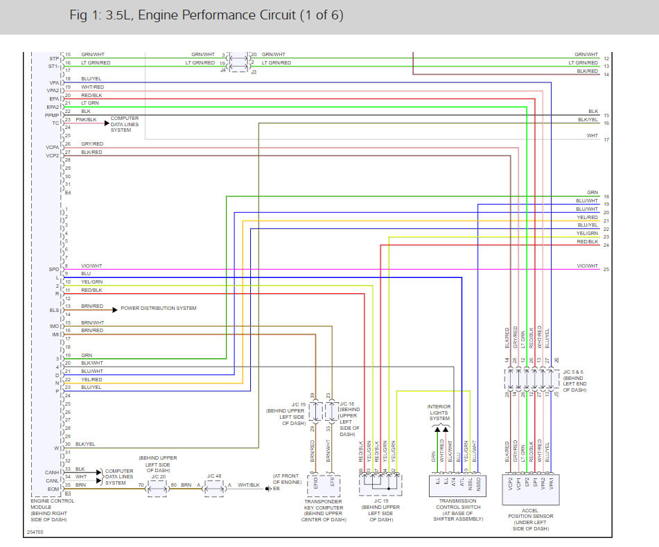

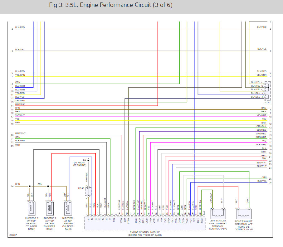

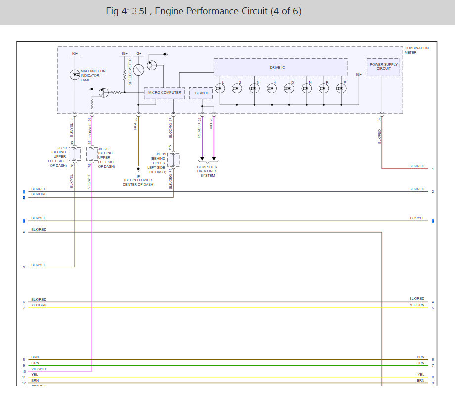

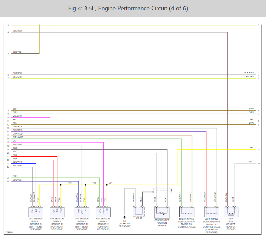

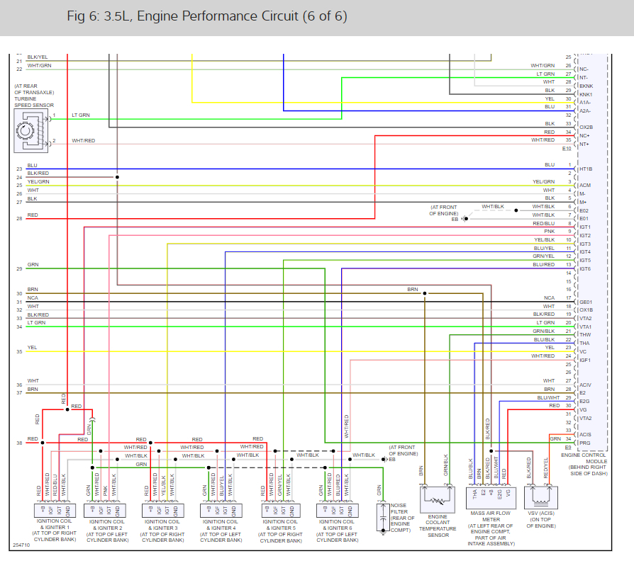

Sorry for the delayed response, I have since changed the coil packs and the crank sensor code p0335. I replaced the sensor however the connector got damaged. I bought a connector but dont know how to connect the wires. It have black, yellow and green.
I can not find the wiring diagram online can you help?
Wednesday, November 27th, 2019 AT 5:20 PM
KEN L
  • MASTER CERTIFIED MECHANIC
  • 55,235 POSTS
Here are the wiring diagrams for the sensor which are included in the engine wiring diagrams featured below so you can see how the system works. Can I ask if you serviced the throttle body and if so did it help? Check out the diagrams (below). Please let us know what happens.
Sunday, December 1st, 2019 AT 12:46 PM
DARTDEE
  • 10 POSTS
I found the diagram online and it worked perfectly. Re the throttle body, I did check it and there was no built up of dirt or carbon it was clean like a whistle. I also changed the EGR valve and the the check light came up to say something was wrong with said valve and power from engine dropped. Could the problem be the EGR temperature sensor? Once the engine cools the power is back. I frustrated at the this point and the mechanics here can't seem to help.

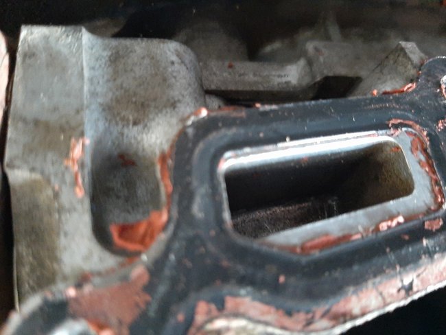

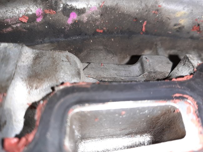

DARTDEE
  • 10 POSTS
Update, so I pulled off the side of the engine with egr valve, there is no passage way from engine exhaust to valve. See pic

DARTDEE
  • 10 POSTS
I asked the previous owner if the engine was ever changed and the answer was yes.
I believe they used the wrong top half of the engine, maybe the qr20 or sr20.
Question can I machine the hole to the exhaust?
Tuesday, March 10th, 2020 AT 6:50 AM
KEN L
  • 55,235 POSTS
Yes, I think you can. Can you upload more images please? It's tough to see what's going on.
