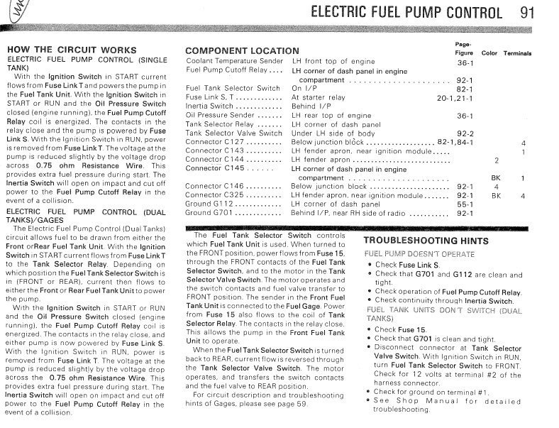

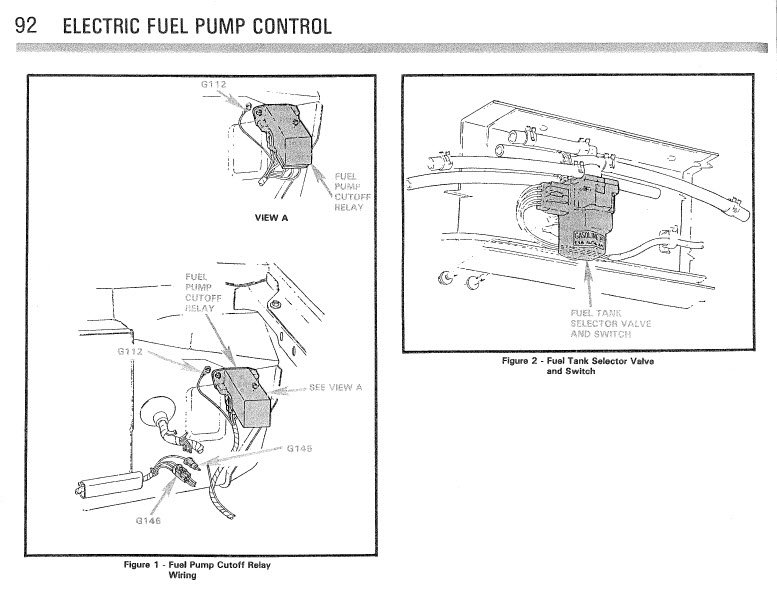

I have power to both fuel pumps until I plug the harness into the pump then NO power. At a total loss.

I tmay be a bad ground causing this. See pics for diagnosis
