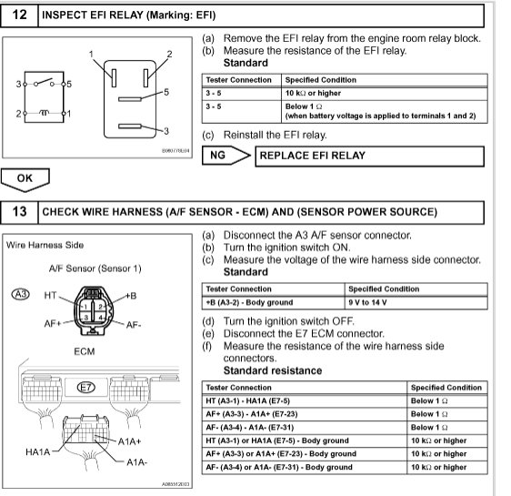

Stalls when clutch pressed. hissing sound when gas pedal pressed. exhaust sounds muffled starts won't idle. Unknown check engine light on possibly o2 sensor.

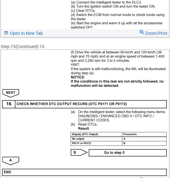

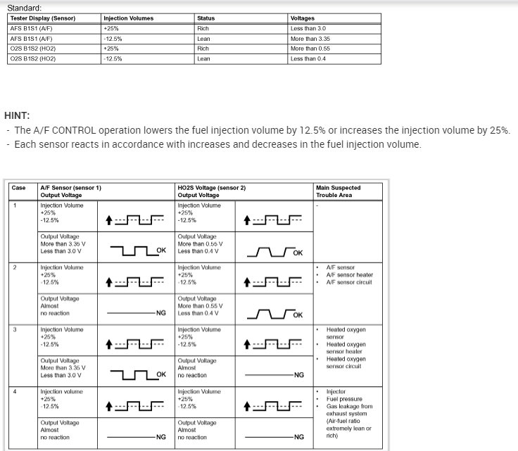

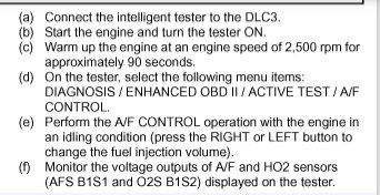

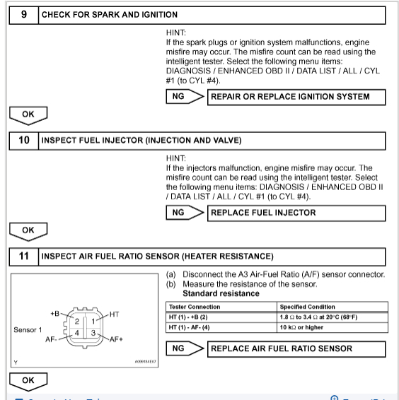

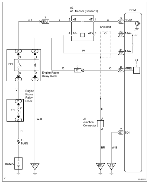

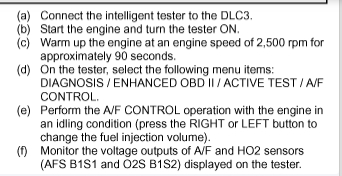

P0171 was the code it had.
Sep 26, 2019 at 2:50 PM

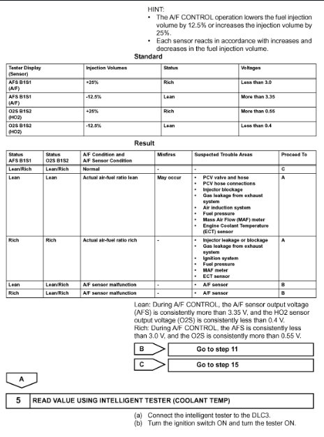

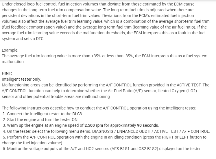

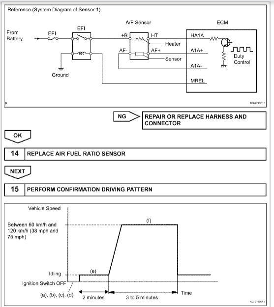

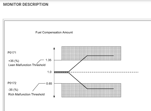

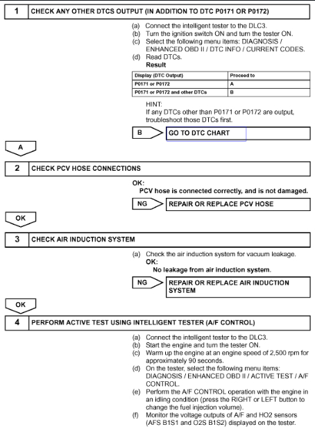

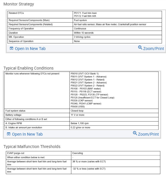

DANNY L
  • 5,648 POSTS
Hello, I'm Danny.

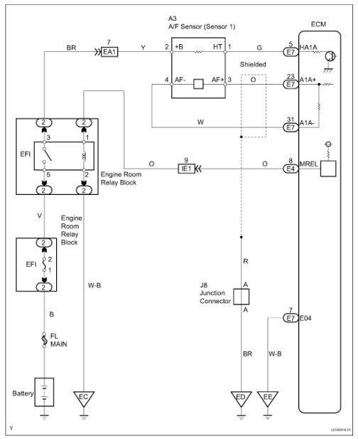

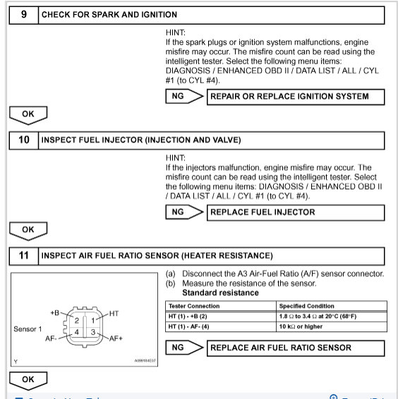

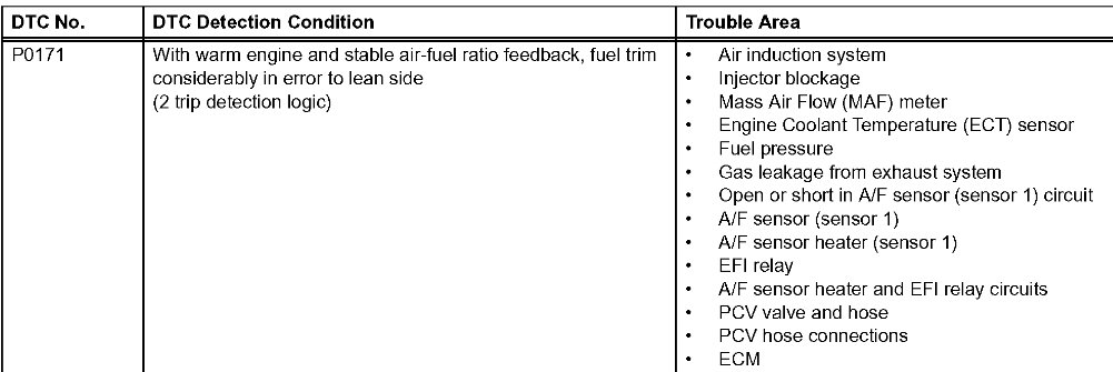

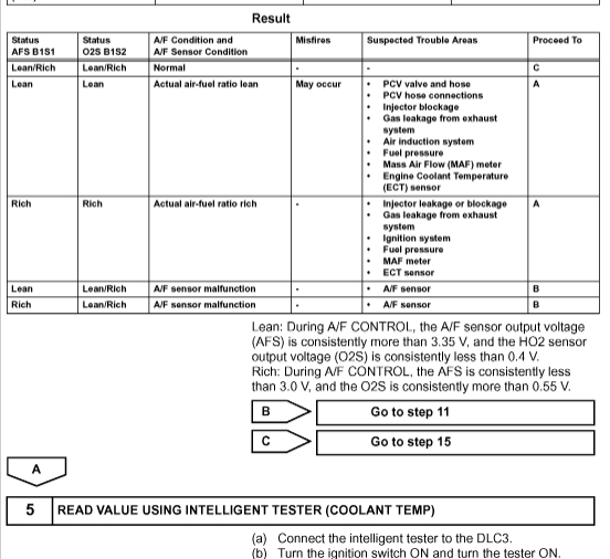

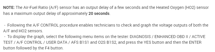

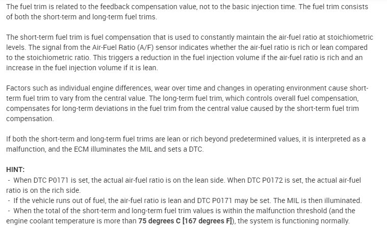

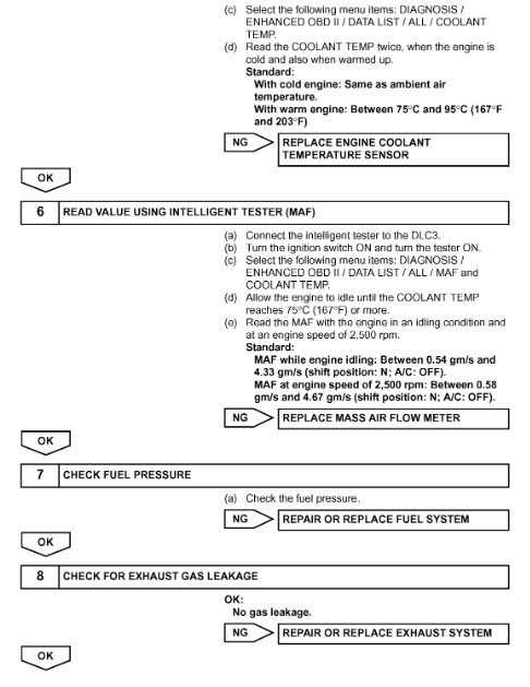

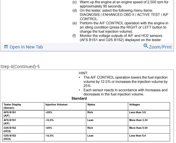

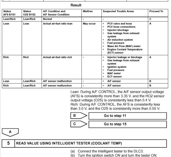

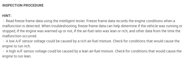

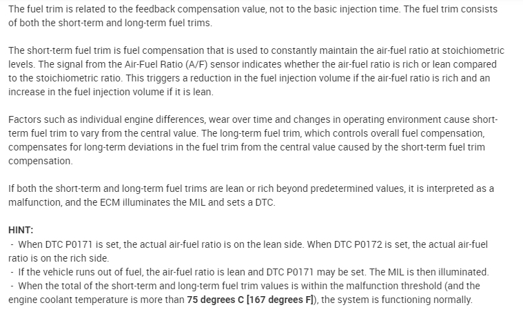

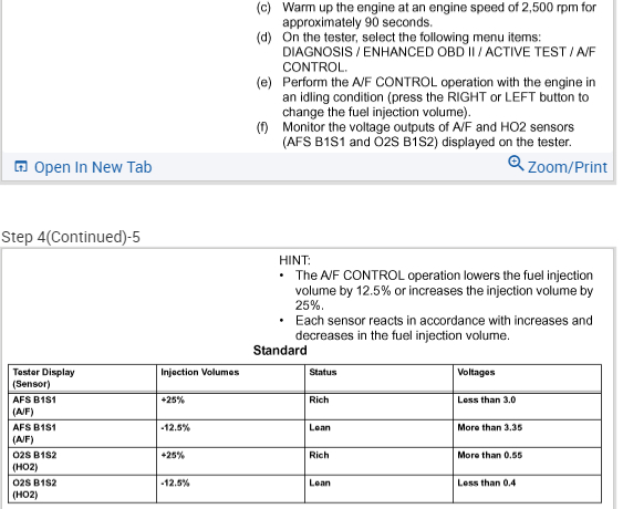

Code P0171 is a Bank 1 system lean condition. Usually this means a vacuum line(s) or intake manifold gaskets are leaking. Basically extra air is being introduced into the engine and is not being metered causing poor performance. I've attached a series of step-by-step pictures below to help aid in the diagnosis of code P0171. Hope this helps and thanks again for using 2CarPros.
Danny-
