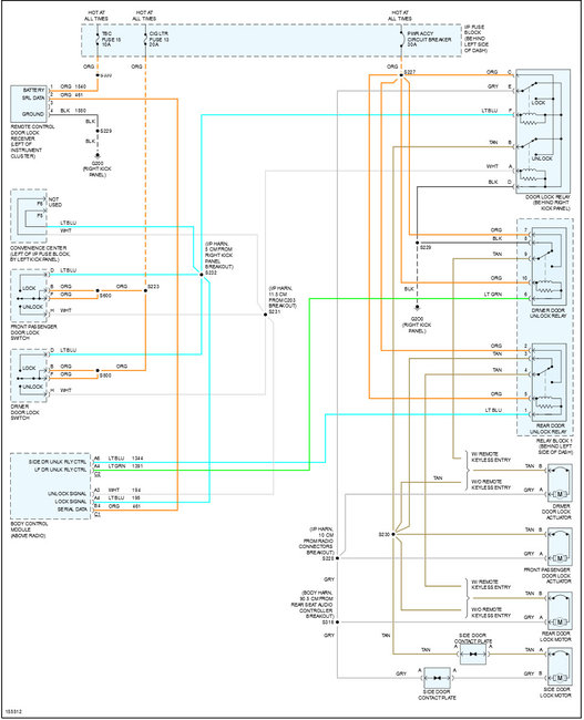

Drivers door lock does not work. Passenger side locks and unlocks both doors no power to drivers door switch.

The same fuse powers both the left and right switch so my guess is you have a broken wire, probably in the door jam. It will be an orange wire.

Thanks, will look for broken orange wire.

Just trace it back from the switch, testing for power along the way.
