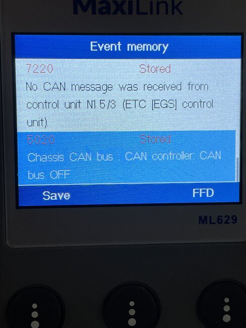

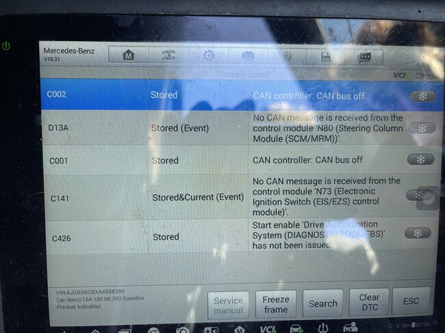

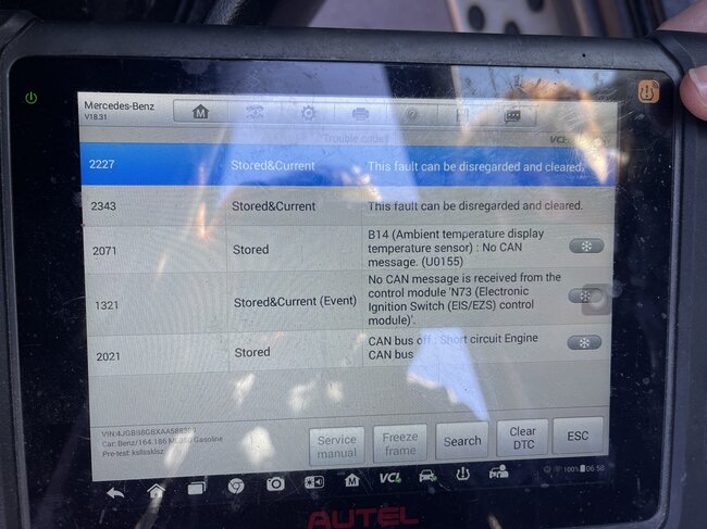

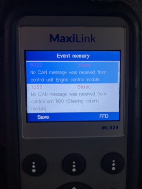

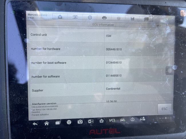

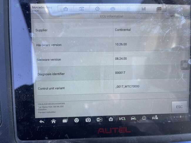

Definitely not the battery or a drain or an alternator issue. Symptoms are in line with the ISM module on these. But hard to know for sure, but that's what it seems like. I went to start it again and got nothing. Codes are attached. Delete them and I get some back. Am almost sure it's not the ignition itself.
Thursday, January 9th, 2025 AT 12:51 PM

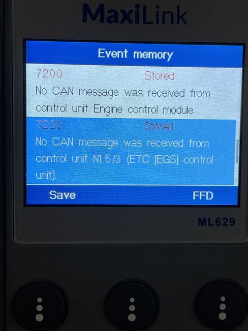

It could be the ISM, but it could be an open in the can-bus. No signal is usually the result of a breakdown in continuity (broken wire, connector pin, corrosion). Have you been able to inspect any of the CAN wiring or connections?
Thursday, January 9th, 2025 AT 7:09 PM

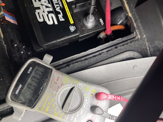

I suggest you do what you originally asked, check for a draw.
To do that, disconnect the negative battery terminal. Connect a multimeter between the neg cable and the neg battery post.
Allow the vehicle to sit for a few minutes and ensure everything electrical is off and the key is not in the vehicle. Have the multimeter set to Milliamps. You shouldn't see much more than a 50-milliamp draw with everything off. Anything beyond that amount will likely cause the battery to fail.
Let me know what you find.
Friday, January 10th, 2025 AT 7:27 PM

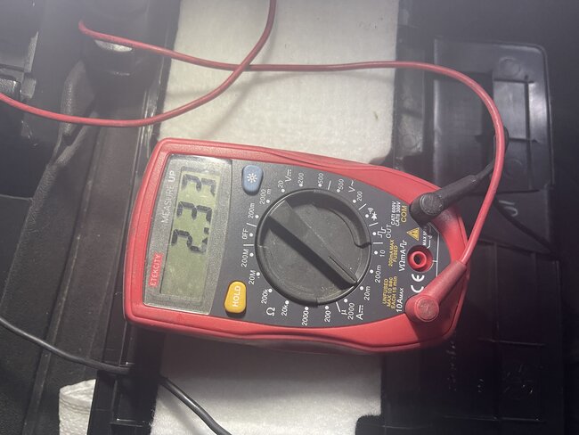

Yes, that is the procedure I was asking about, thanks. I will do it regardless, but I am sure it's not a battery issue as it's showing 12.2 off and 14.5 running when I received it. Next day when to scan it and volts while off was 12.2.

I assume my settings are right like the picture. Between yesterday and today everything was dead when I went to start it but in doubt it's a draw, I put a jump box and it started fine without struggle, left it on without the box for 7-8 minutes, turned it off and on and it's strong. Checked voltage of battery and alternator and its charging 13.5. I don't see any numbers as far as a draw. Is this correct set up? Shows zero.
Saturday, January 11th, 2025 AT 9:39 AM

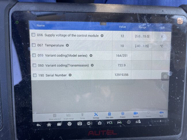

Also checked codes again and it started several times no issues, but once or twice did the same where it won't go into drive or reverse initially that's why am thinking the ISM. Also, when you say test with the multimeter and make sure everything is off, well, the battery negative is disconnected so everything must be off. Also, these cars have a smaller battery next to the big battery, it's also new.
Saturday, January 11th, 2025 AT 9:57 AM

Also have not yet gotten to the ISM to look at it but they are sold programmed for 200 so I may get one. But I noticed a small transmission leak. I am now thinking it maybe possible that it's also low on fluid and I know these would start having these issues where it won't even go into gear if it is or go into gear and goes back to park. But I doubt it here as the issue is that you won't even see it go to drive or reverse, won't make a sound and indicator won't move from park.
Saturday, January 11th, 2025 AT 10:00 AM

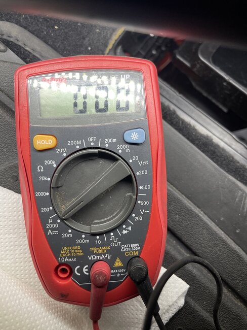

Even with this other one same thing zero.
Saturday, January 11th, 2025 AT 10:40 AM

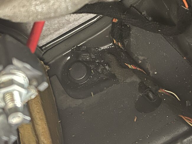

Also noticed a bit of water residue under the fuse box in the back. Not sure if all these issues are related. Also dash says brake lamps are burned or whatever but they all work.

I got something, not sure if this is 2 amps or what, but it's between 2.6-3. Whenever I touch the negative post I get noise from the cd changer and something else in the back. But it feels pike a magnet and that if I continue touching it that it may burn the multimeter.
Saturday, January 11th, 2025 AT 12:28 PM

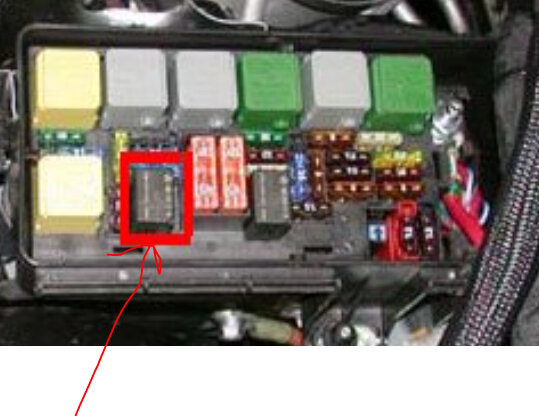

I found something making a noise under the hood and continued for a while, turned out the auxiliary water pump. Car isn't hot so I'm not sure why the small pump is running after. Unplugged it for now to see if it's what's causing the battery issue. Also deleted the ton of codes in front and rear sam. Also, found this code about the rear gate. Deleted it and now the gate works. No codes came back so far for anything.

If the pump continues to run, it will drain the battery. The pump is actuated by a relay (see picture below). Switch it with a different one with the same part number to see if it stops the pump.
See pic below.

Turned out these run 30 minutes after the car is off if you select AC REST to keep the temp inside as chosen. Turned that option off and it's no longer on. The only thing I did was delete all the codes that were there, and the car is fine. The only thing I had that wasn't working was the back gate it would open but not close t had a code for the anti-pinch strip on one side. I think water getting in from the taillight seals caused some moisture, since it's been in the garage a week and dry, no issues so far.

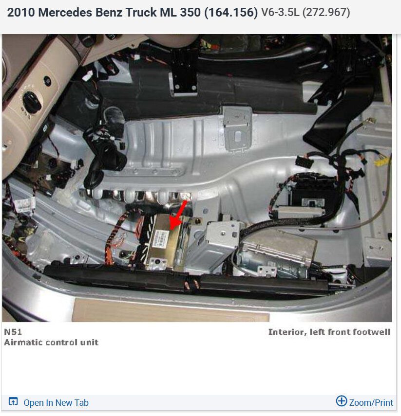

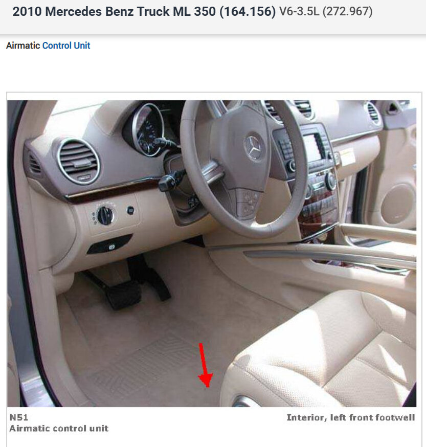

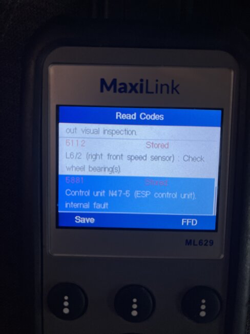

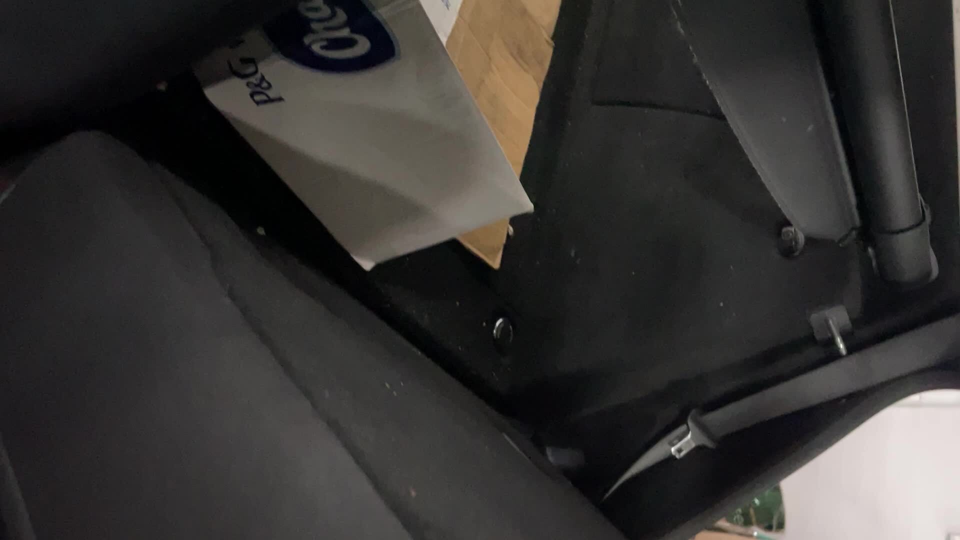

Yep, I was going to say I would check for a stuck CD in the player. Also, the Electronic Stability Program (ESP) module seems like it is not working are there is a problem with it. Please check for water under the carpet. You might need to remove the seats, there are many modules under that if they get wet, they will stop communicating and have a battery draw. Check out the images (below). Please let us know what happens.
Thursday, January 16th, 2025 AT 8:44 AM
BHAMDOC1
  • 217 POSTS
Yes, I am familiar with water under the seats and on floor on these cars but none, only traces are by the rear fuse box. I let it dry for days inside the garage and all is good now. The rear sam on these is under the rear seat so that's good. I ordered the tail lamp seal to replace it. But most likely water in the rear got some moisture in the rear fuse box. No codes have come back at all so far.
