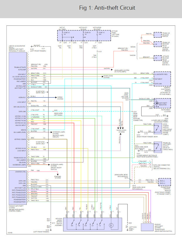

Car just randomly shut down completely while driving. Have put it on a scanner and it gave a code for the anti theft system. Cannot afford to take it to a shop so trying to fix it myself. What do I need to do?

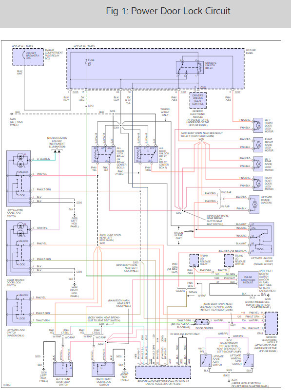

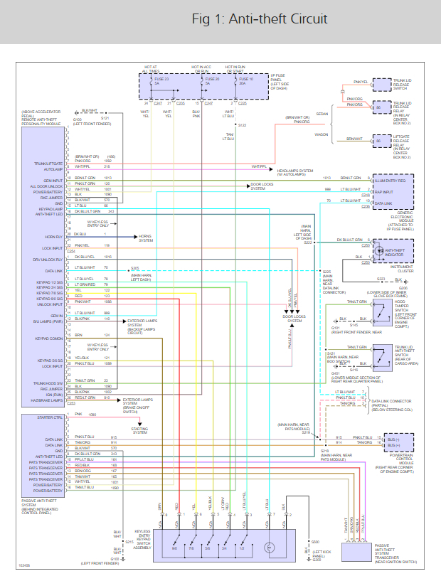

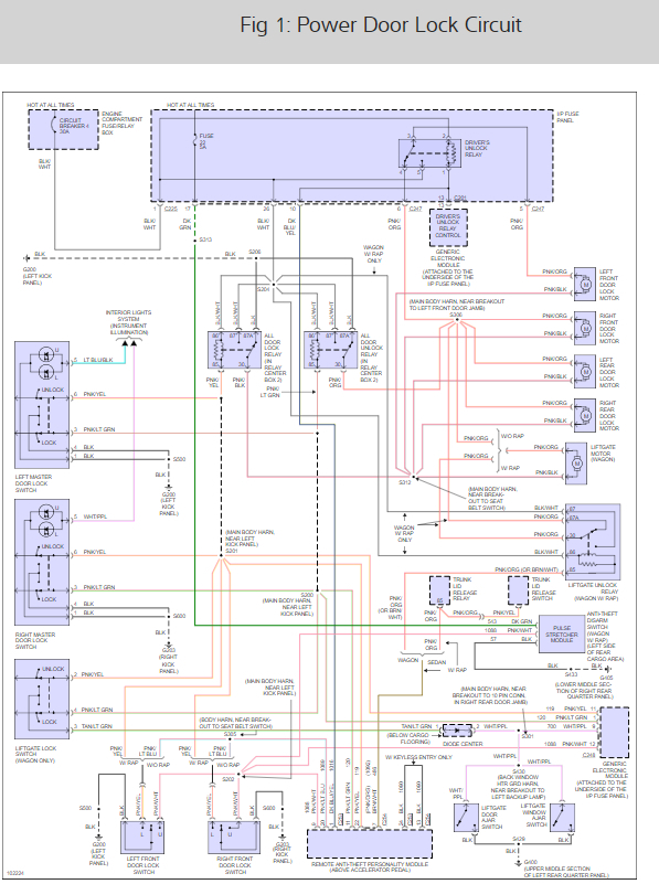

I have seen where the drivers side door latch has a micro switch that works with the alarm. I would test the switch and then replace the latch if bad. What happens is when you are going down the road the switch is opening and closing about a million times and the system get confused. Here is a wiring diagram so you can see how the system works.
Let me know if you are not on a phone and cant expand the image I will send larger ones.

Because of the way the anti-theft works there is not a lot you can do. You can try doing a system reset but beyond that you really need the dealership level scan tool that can talk to the actual security modules to determine which part has failed and to program the replacement to work. Ford uses multiple modules in the security system. There is a key reader in the column which then tells the instrument cluster what the key is. The panel then communicates to the body control module and power train control module if it is a valid key and lets the engine run.
It is also possible the security code is not related and it is a failure in another system.
What is the actual code and what does the security light do when you turn the key to on and start?
For a reset you can try;
https://www.2carpros.com/articles/how-to-reset-a-security-system
