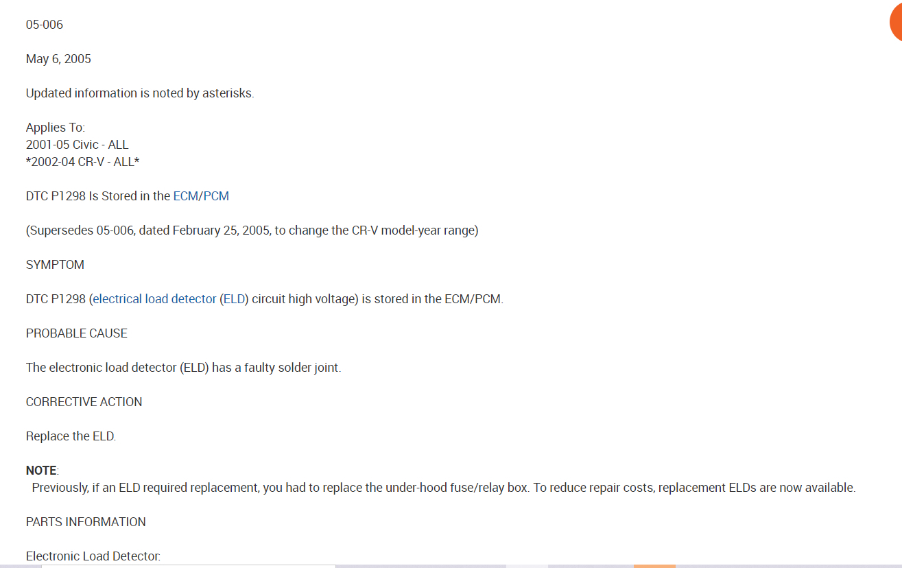

Okay, well it's good thing I got a warranty. I will just swap for another and see what happens. Last question, is there anything else that it could possibly be if this doesn't work?
Wednesday, August 4th, 2021 AT 6:04 PM

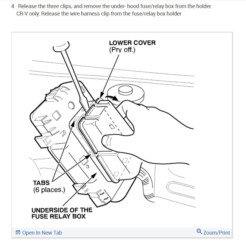

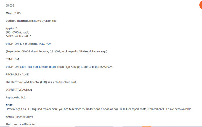

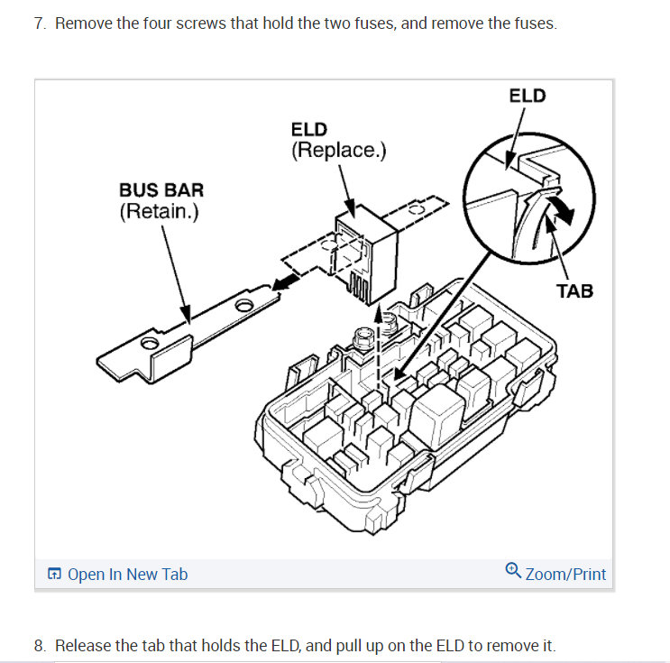

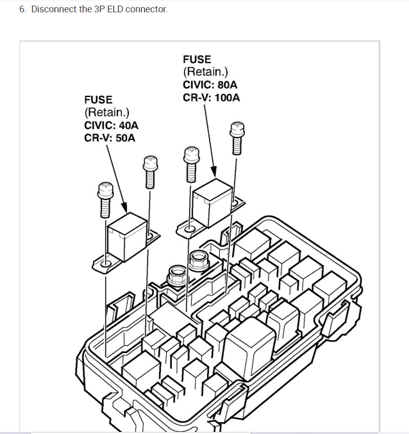

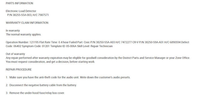

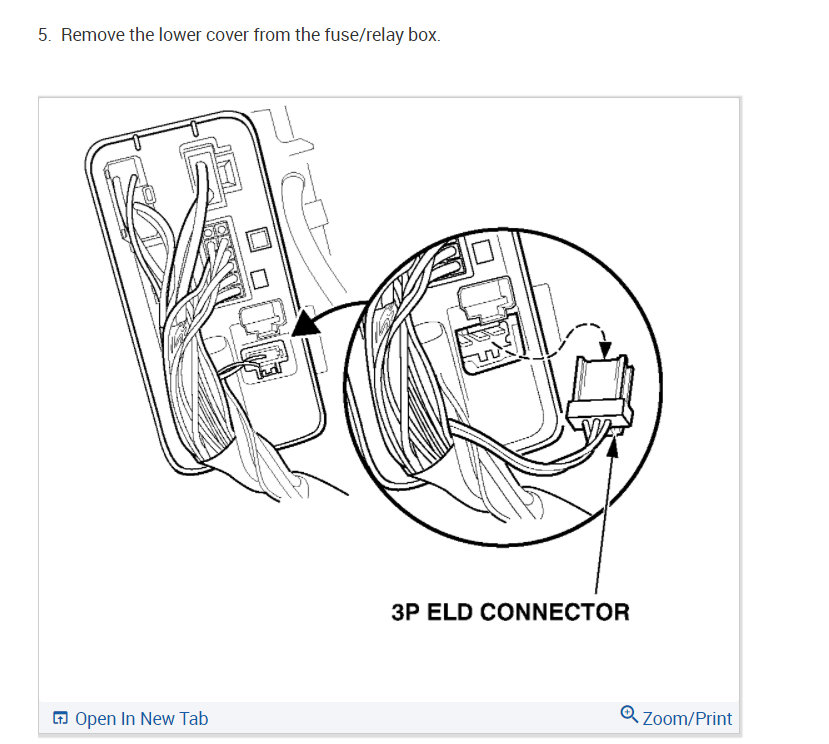

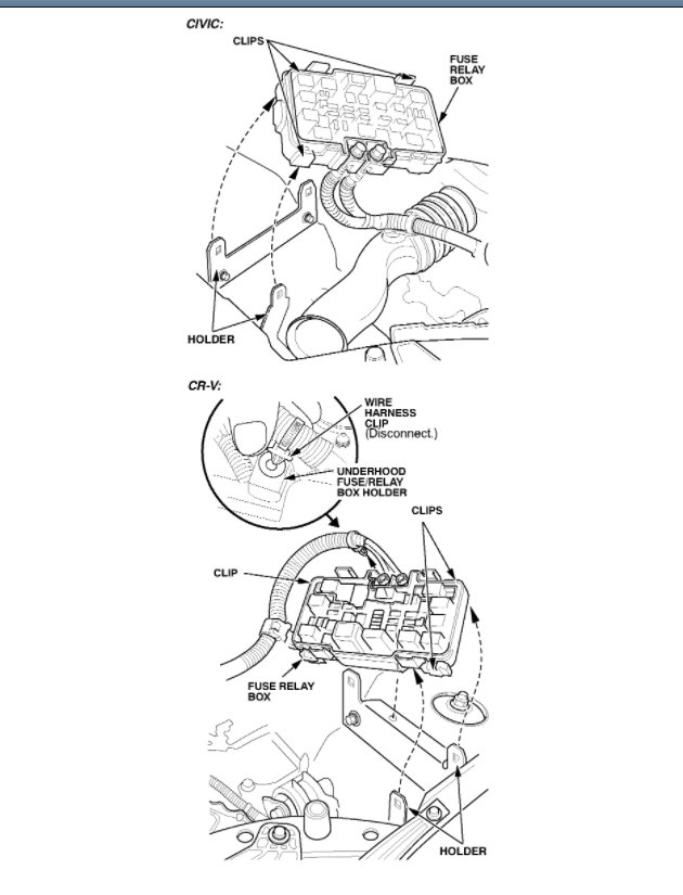

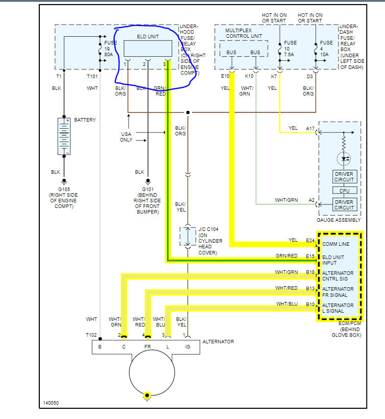

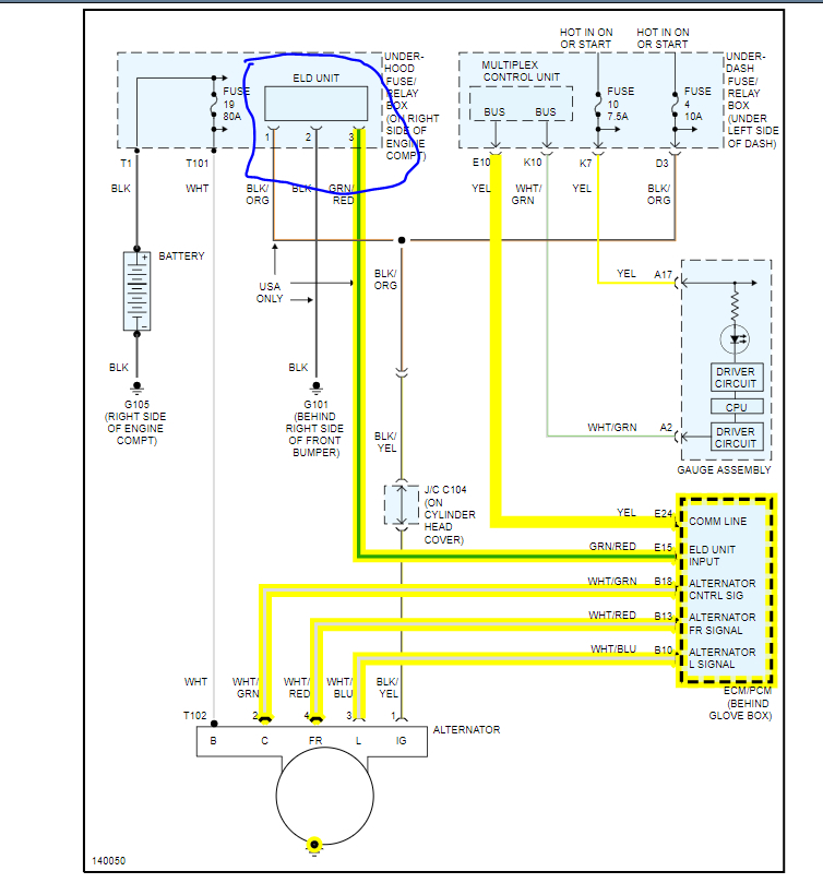

The alternator is responsible for the charging system. There is nothing else in the circuit.

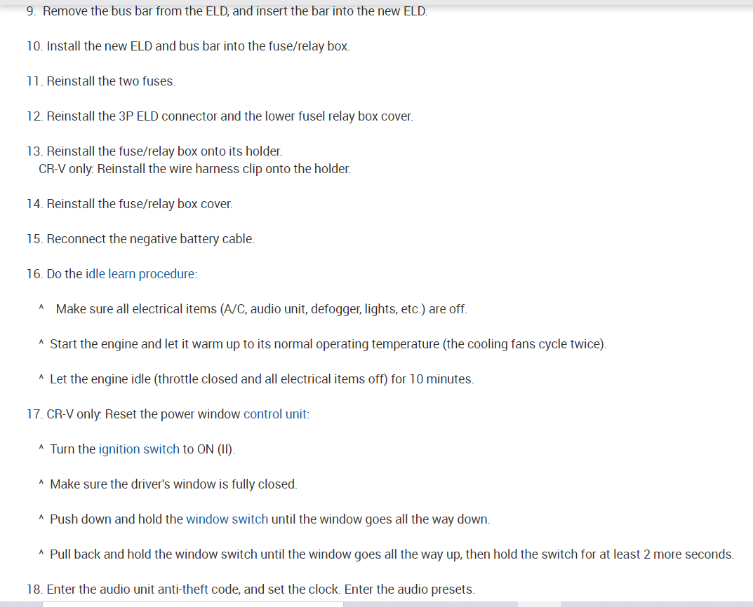

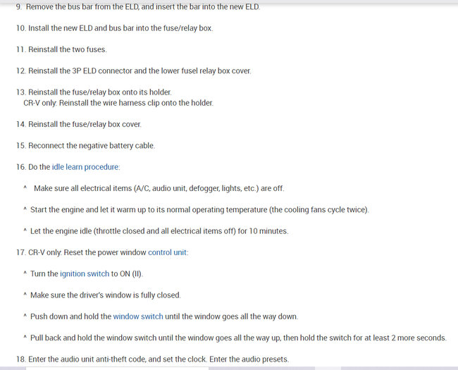

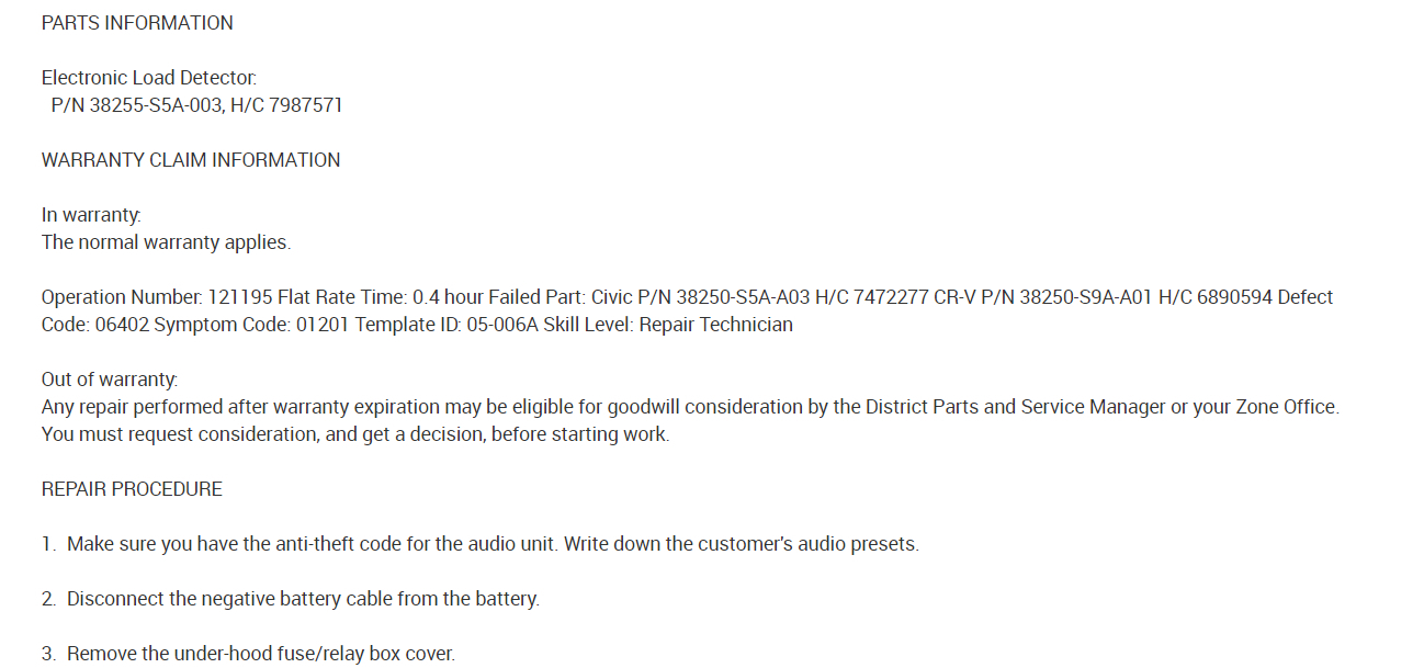

The only other thing is the ELD unit in the underhood fuse box. It is rare but could cause the issue.
I attached the description and the procedure for you. If it is that, the fuse block has to be replaced.
