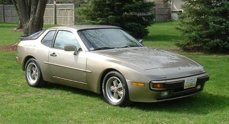

PS:
One of my favorites!
https://www.2carpros.com/forum/automotive_pictures/249084_944_1.jpg
