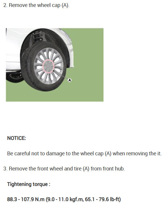

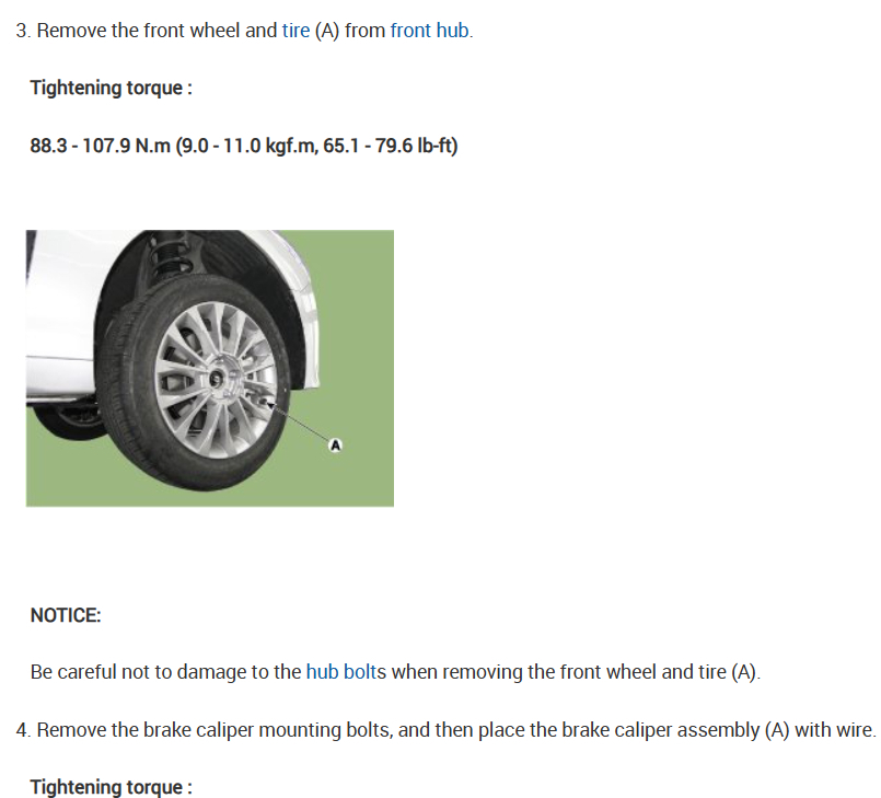

Having a popping noise coming from my driver side. Only dose it when I’m not moving or at slow speeds. You can only feel it in the the steering wheel. My abs light has come on as well as my traction control light. Also this noise only happens when I turn left does not do it when I turn right. I have also noticed that my steering wheel is way more loose turning left then it is right.

Hi Joey,

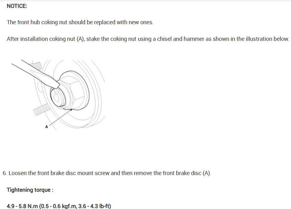

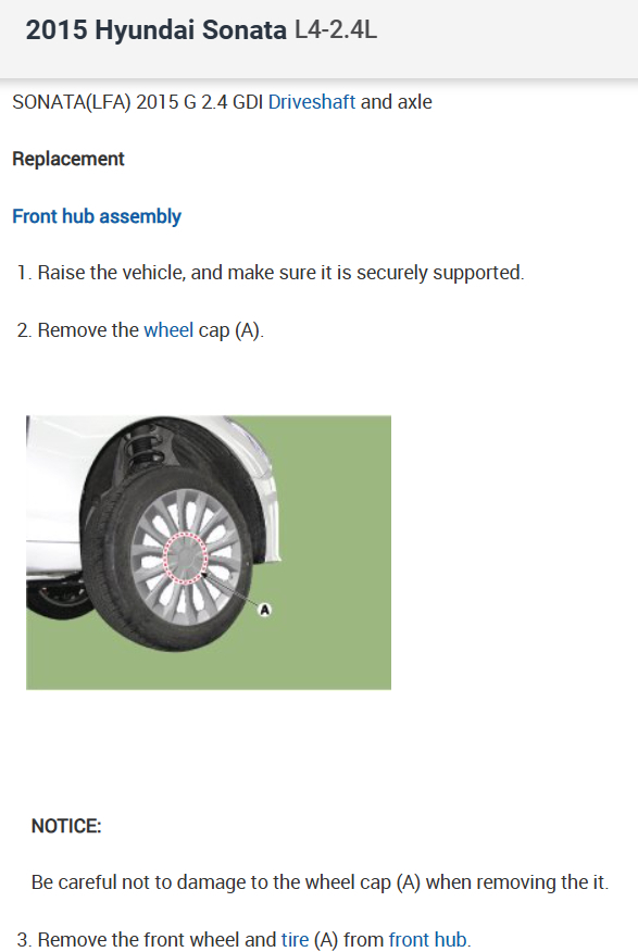

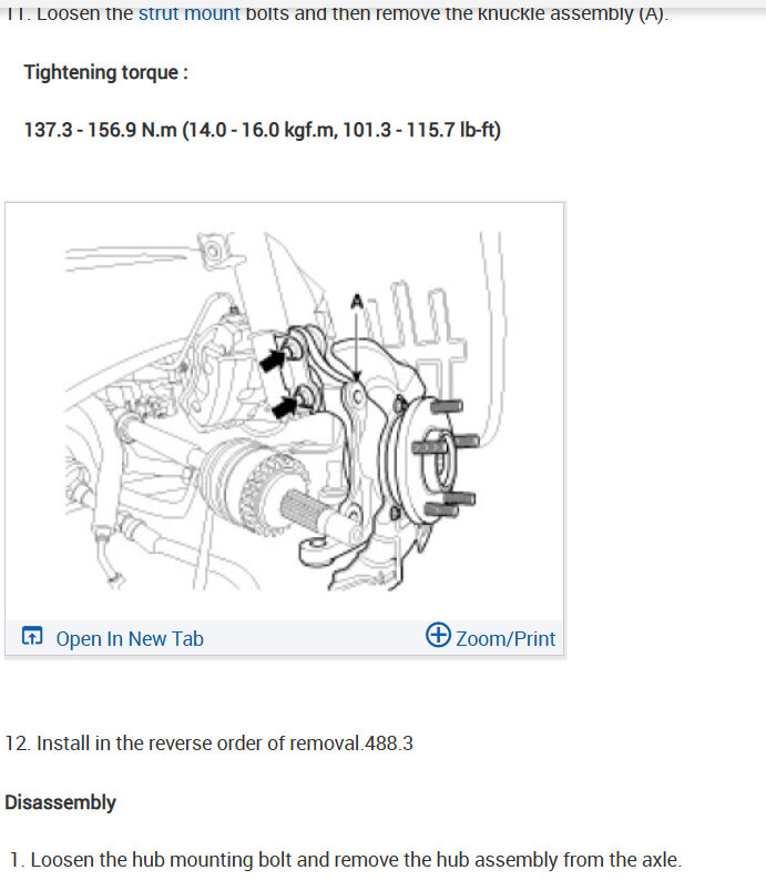

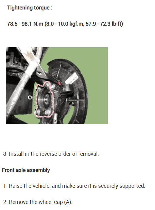

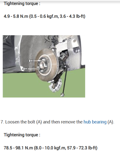

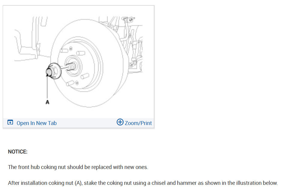

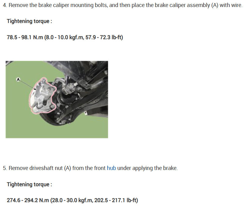

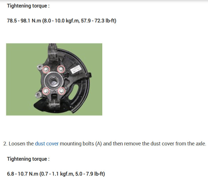

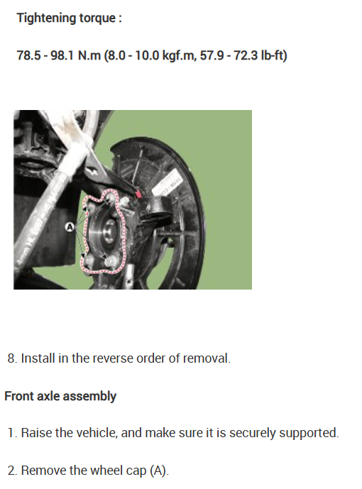

This sounds like you have a CV axle or wheel bearing hub that is going out, can you upload a short video of what the car is doing? If we scan the computer we can see if you have a a code for the drivers front wheel speed sensor which will confirm the bearing hub failure.
Please go over this video which will help us get started on fixing the problem:
https://www.youtube.com/watch?v=HvooM1X2SDs&t
If you do get the ABS code, here is how to change out eh bearing hub which will fix the problem. Check out the images (below). Please upload pictures or videos in your response of any problems so we can see what to help you with.
