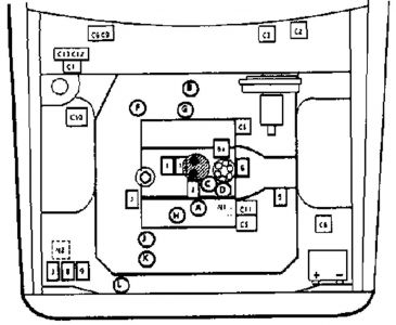

Like I said, The car is a 1991 Pont. Transport 3.1. The car stalled and check engine lite does not come on. When noid light is connected to the injector connector, there is no pulse(lite). Also with fuel pump(no pulse). Distributor has spark. Will ignite with carb spray.
Why is the computer not responding when I hook up scanner. When I checked computer with LED safe Tester, it is recieving two + and - at supply end.I (1)thought of a crank sensor.(But why is there no resonse from PCM?)(2) cannot find crank sensor?

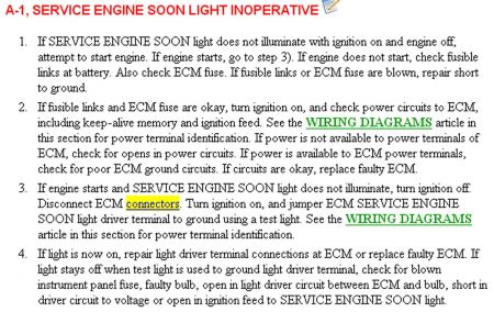

Does the CEL illuminate breifly when the key is turned to the on position for the bulb check?

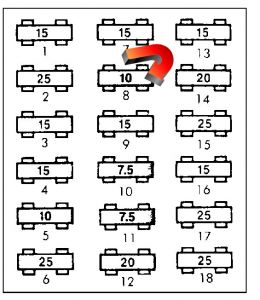

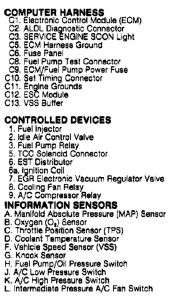

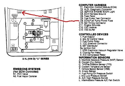

DId you check the ecm/fuel pump power fuse?
https://www.2carpros.com/forum/automotive_pictures/30961_tr1_1.jpg
https://www.2carpros.com/forum/automotive_pictures/30961_tr2_1.jpg
https://www.2carpros.com/forum/automotive_pictures/30961_tr3_1.jpg
https://www.2carpros.com/forum/automotive_pictures/30961_mitchel_36.jpg
There is no crank sensor on this one that I can find. PArts store sometimes list things that are nor accurate. Cabin air filters are one of the best examples :x :? .
Also check this 10 amp fuse:
https://www.2carpros.com/forum/automotive_pictures/30961_tr4_1.jpg

I just want to make sure the bulb does illuminate. Probably does.
I'll catch up with you when your ready. Before you tow it, I would check the fuses I mentioned, it may be that simple.

The fuse you sent me a diagram to check was the first fuse that I checked from the begining.I checked the
MIL bulb(check engine light) and it is OK
This is becoming a real Ordeal! What else can you think of that would cause No communication with
ECU and no Check engine light and no fuel pulse.

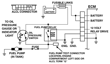

Get an assistant to turn key On, At the fuel pump connector,do you have power at gray wire you gonna have this power just 2 secs. then its gone and should be there at all times while engine is being crank over. If power is at the gray wire you have a problem the F/Pump.
Familiarize yourself with the circuit below its gonna come up
https://www.2carpros.com/forum/automotive_pictures/12900_oil_sending_unit_and_fuel_pump_circuit_9.gif

Hi, I will return to car on Sunday and will check power at fuel pump Again. That is also one of the first things I did. If the relay is under glove box which one is it. I need a diagram with pin # at ecm and exact location of fuel relay to check it properly. After I check I will answer.

F/P relay is in No.3 on the bottom left corner there's 3 square boxes the 1st one close to the fender
https://www.2carpros.com/forum/automotive_pictures/12900_1991_transport_Vin_D_fuel_relay_1.jpg
Fuel Pump Circuit
https://www.2carpros.com/forum/automotive_pictures/12900_1991_transport_fuel_pump_realy_circuit_1.jpg

Hi, I checkedthe fuel pump circut. It is receiving 12V and relay will feed power to the fuel pump when manually activated. ECM is not putting out a signal to injectors or fuel pump. The Ecm is receiving + when key is turned on. The gray line from relay to fuel pump delivers 12V to pump when relay is manualll activated.I switched relays no help. ECM not responding.I checked Ignition The distributor was
replaced with fuel pump at the very beggining.
The oil sender seems to be OK. Is there a good way to check that?What else?Both fuseable links are giving 12V.
Is there some type of Shut down switch/relay like chrysler has? It is too bad that the check engine lite does not come on, If I can scan that would help!

The oil sending unit is like the Ford's inertia switch it kills the fuel pump when there's no oil pressure
The fuel pump relay energizes the fuel pump for 2secs then shuts off, when the van fires up the OSU takes over the power to the pump.
Double check all your power input to the PCM and its ground-If the computer cannot energize the fuel pump relay it gots an internal problem. Reflashing it will not work. Replacement might help.
